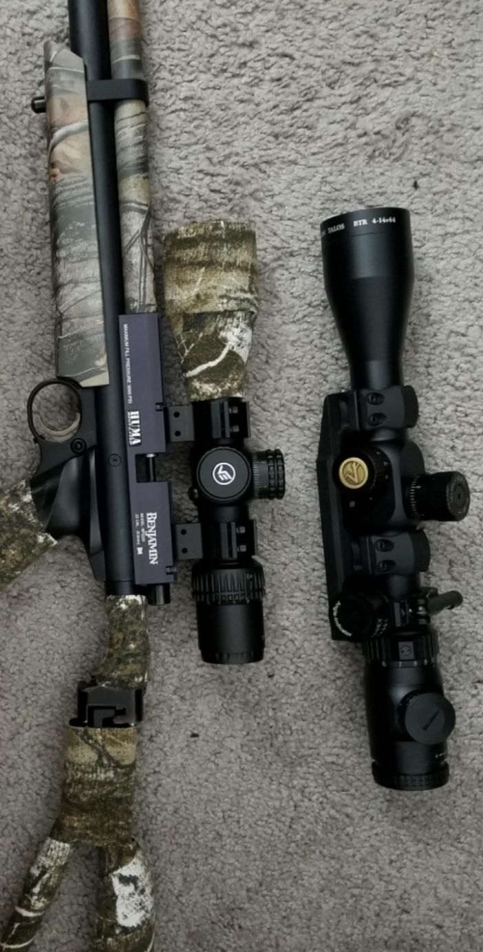

I put this very compact Sniper 1-5X24 FFP on it and really like how light and compact it is. Got it off of fleabay for 110 as it was a make an offer. It has a very nice reticle and only the center dot is illuminated. Inexpensive but nice glass.

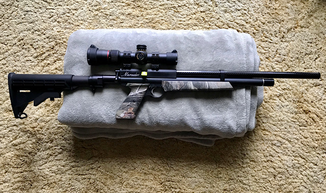

I have a 4-14x44 FFP BSA on my Marauder. Since most of my shooting with the Marauder is under 75 yards, it works great. Lots of debate on FFP vs SFP (First focal plane vs Second focal plane), but I prefer first. Personal preference mostly. that particular scope isn't available anymore, but the 4-14 range is great for the shorter hunting distances.
I think the 6-24 I have on my Impact would be just too much for the shorter distances.
It works for me.
I have the 3-12 Sniper the glass is crystal clear for a low budget scope.
