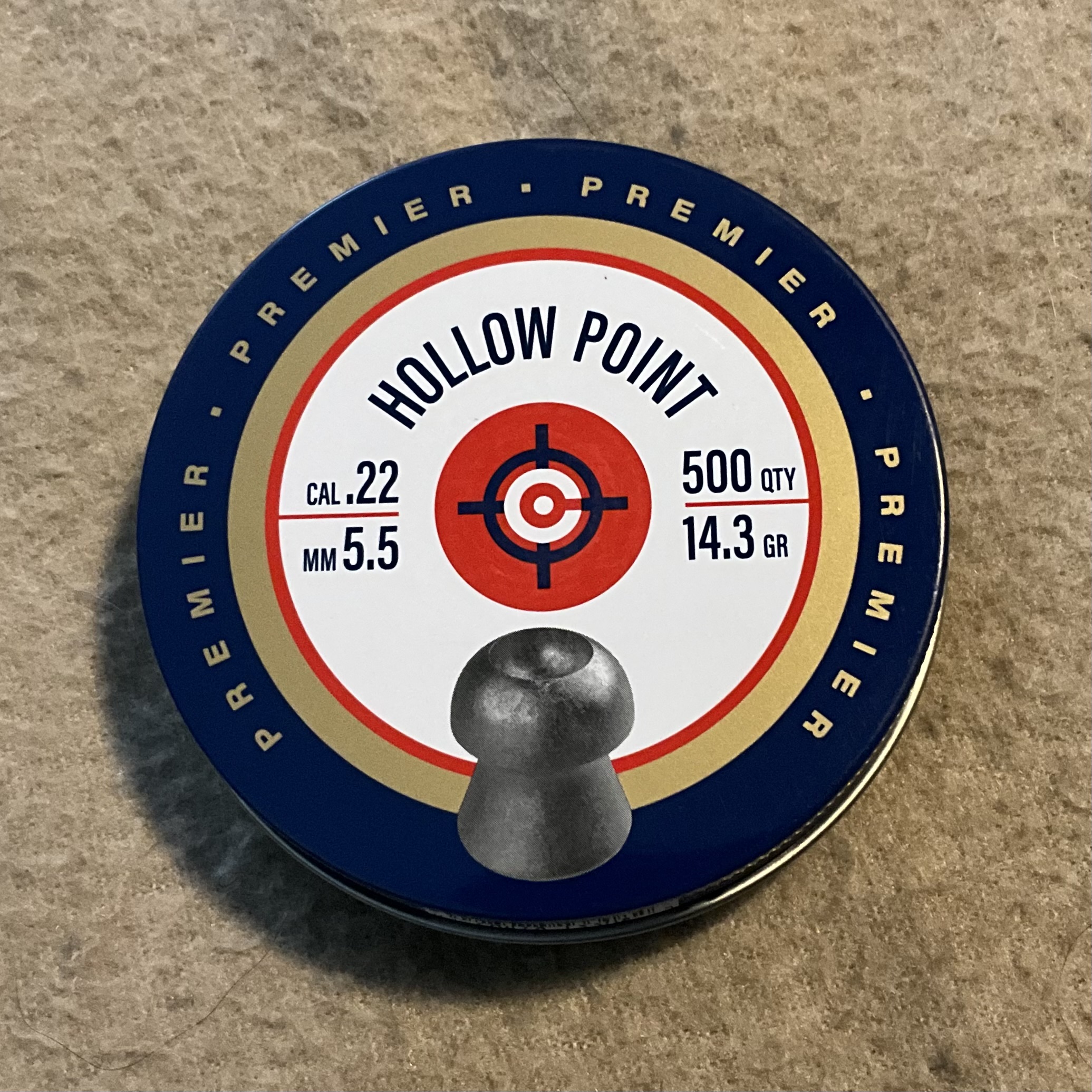

Hey bud I would ask what pellets you are shooting first. You can pick up decent energy just by shooting a heavy pellet. A gun making 13 ftlbs with a 14.3 grain pellet will make a good 3 ftlbs more energy with a 21.14 grain pellet with no modifications to the pistol. That’s what mine does anyway.
I will look that up when I get home. I’ve only tried one type of pellet thus far. I need to get more anyway.
If you only shoot one distance you can get dialed in regardless of velocity but I think the Prod is better suited to lighter pellets. You will run out of elevation adjustment pretty quickly trying to sight in with heavy pellets. Mine likes copper plated H&N Field Target Trophy (FTT) pellets best but shoots Crosmans pretty well.

These are the pellets I used. I was able to source them from my local Walmart. They shot really well and, for my skill level, pretty accurately.
