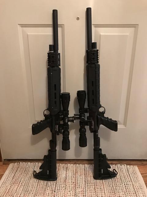

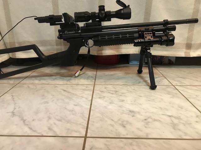

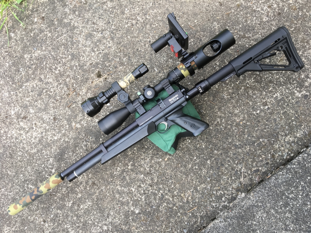

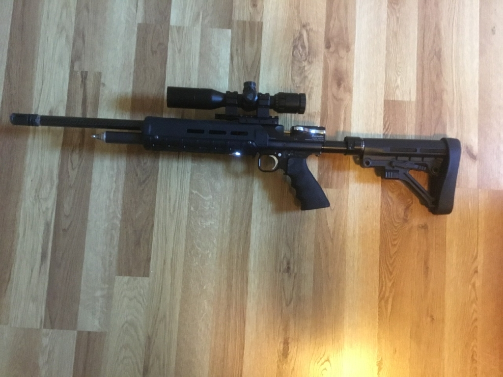

This P-rod has everything but the pressure tube and insides replaced however it does have a B-Staley mod.
Breech is a Exclusive sidelever, left handed, takes 10 shot Mrod magazines.The barrel is a Jim Gaska MMHF. It reduces double feed to ...well just haven’t had one, before they were common.
The shroud is 14 inches and baffled ending with a M-16 birdcage flashhider.
The forearm is a mid length Magpul, reversed and fitted.

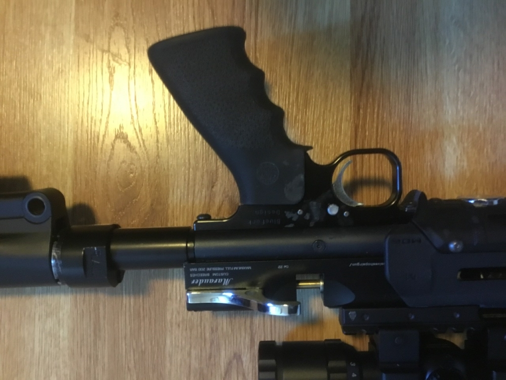

The trigger assembly is a Bluefork Design with a “glass rod breaking” superb pull and a AR 15 Hogue fingergroove rubber grip.
Scope is a 3x12 BugBuster in side lever mounts on a UTG cantilever 11mm to Weaver riser.
stock is connected with a RAI adapter and a is a m-4 carbine stock.
It also has a laser attached to the Magpul forearm, used only to zero as I play musical scopes.
It is tuned to push 14.3 cplhp’s at 525 FPS, it is a inside 10 yard rifle and shoots bug hole groups with just about anything.
