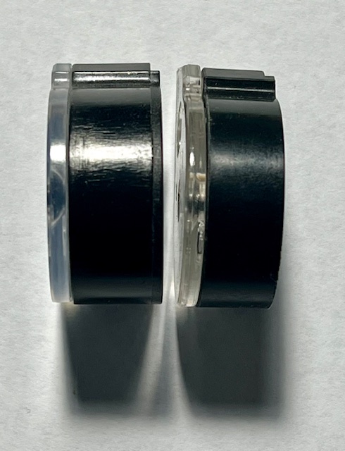

Benjamin PROD magazine
No, the Prod mag is thicker than the MRod magazine. They are not interchangeable.
The Prod mag is on the left, the MRod mag is on the right.
I took 25 thousands off the bottom of 2 marauder mags for use in the prod, that's the only real difference then they slip in and work just fine a little loose but it works
