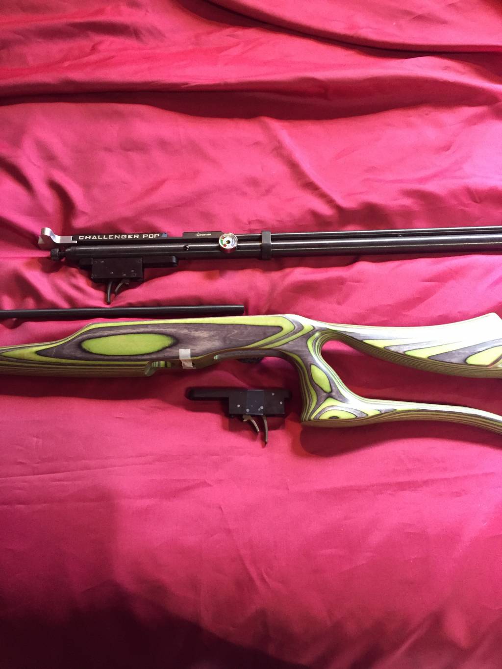

I’m thinking of trying to fit a Prod into a Marauder rifle stock. I’ve got a Challenger trigger group and trigger guard which will work on a Prod. The forearm on the rifle stock would need to be shortened so I’m thinking a wood stock would refinish better than synthetic. Barrel band would also need to be inletted. Can anyone think of anything else that would be needed? Without a stock in hand it’s hard to visualize major stumbling blocks. The gauge hole may be a major problem. Any ideas or input will be appreciated.

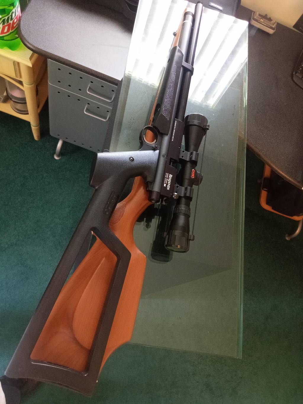

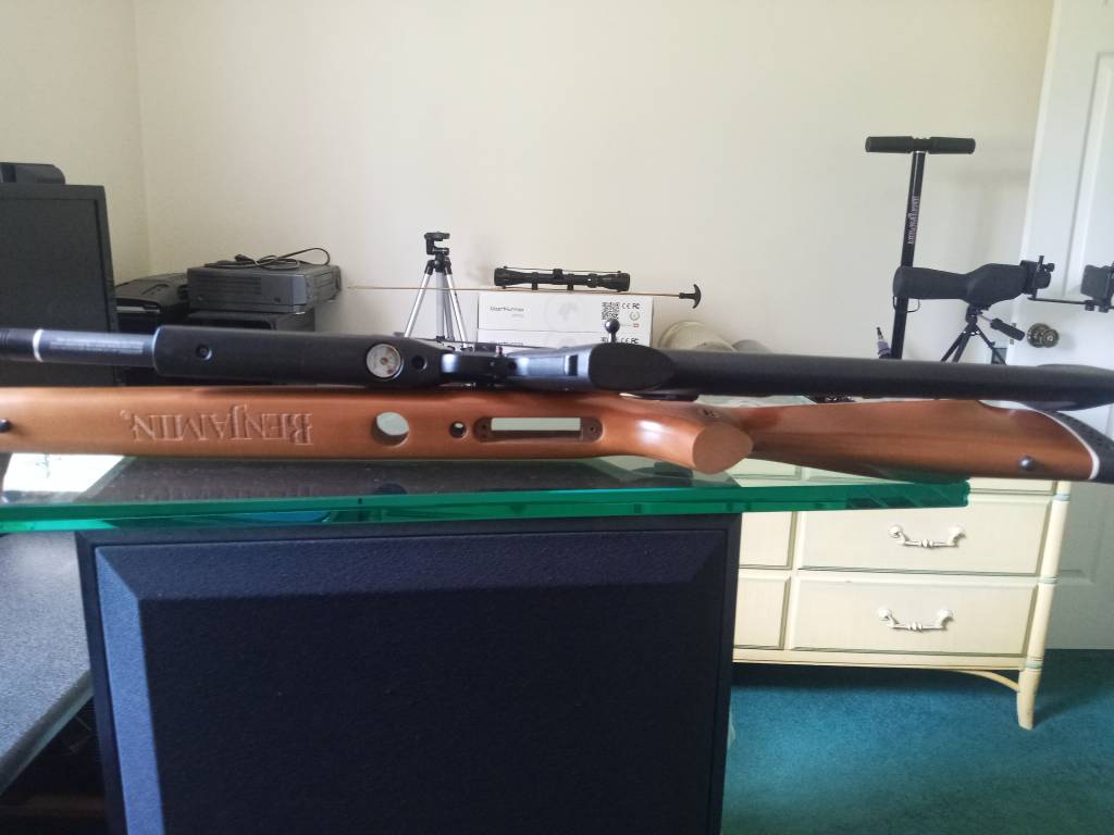

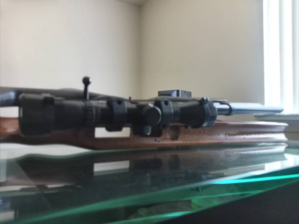

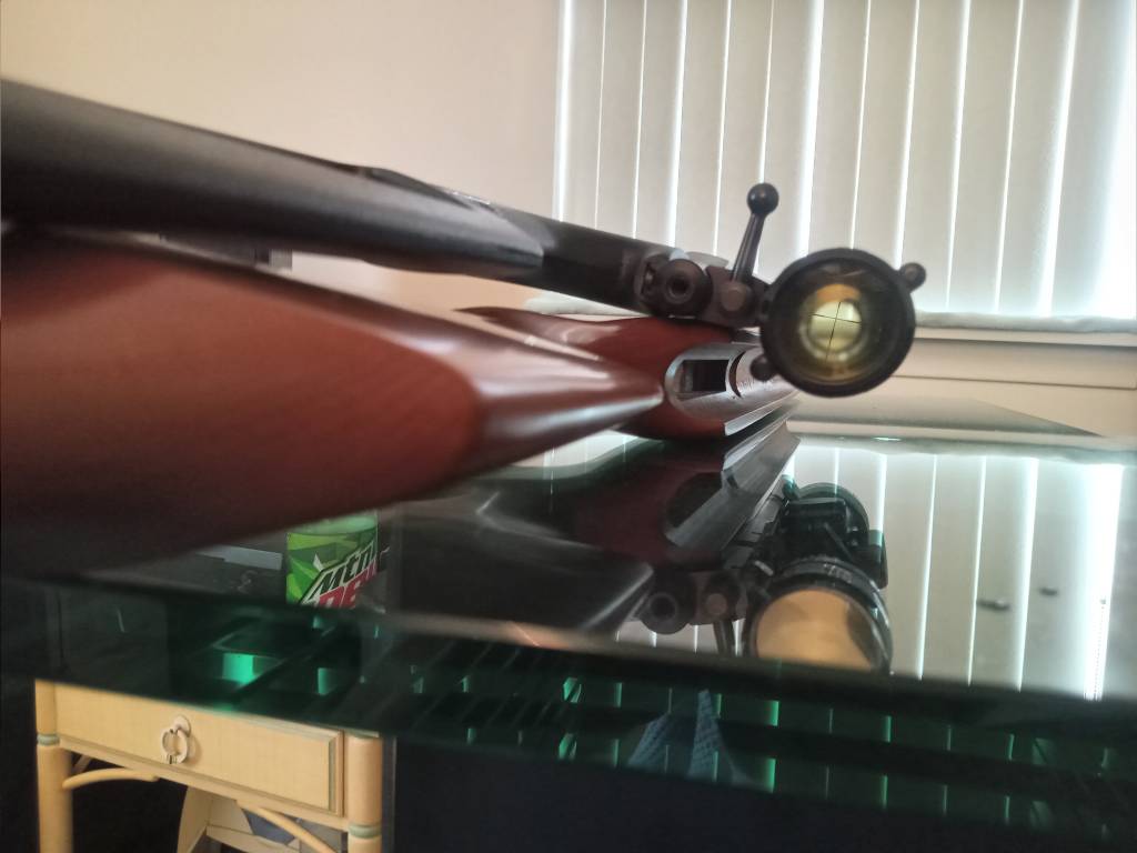

i just happen to have one onhand ... looks like it would take some extensive shaping, and youd probably need to fab a plate in the end to cover the trigger area ..interestingly the gauge hole looks like its about in the right place, thats about it though .. im sure after its cut down and shaped theres enough material there to inlet the tank .. anyway heres a few pics for reference ..
I looked at a Marauder today and agree it will take some bedding to fit the air tube. I thought the same about the gauge hole being very close.
