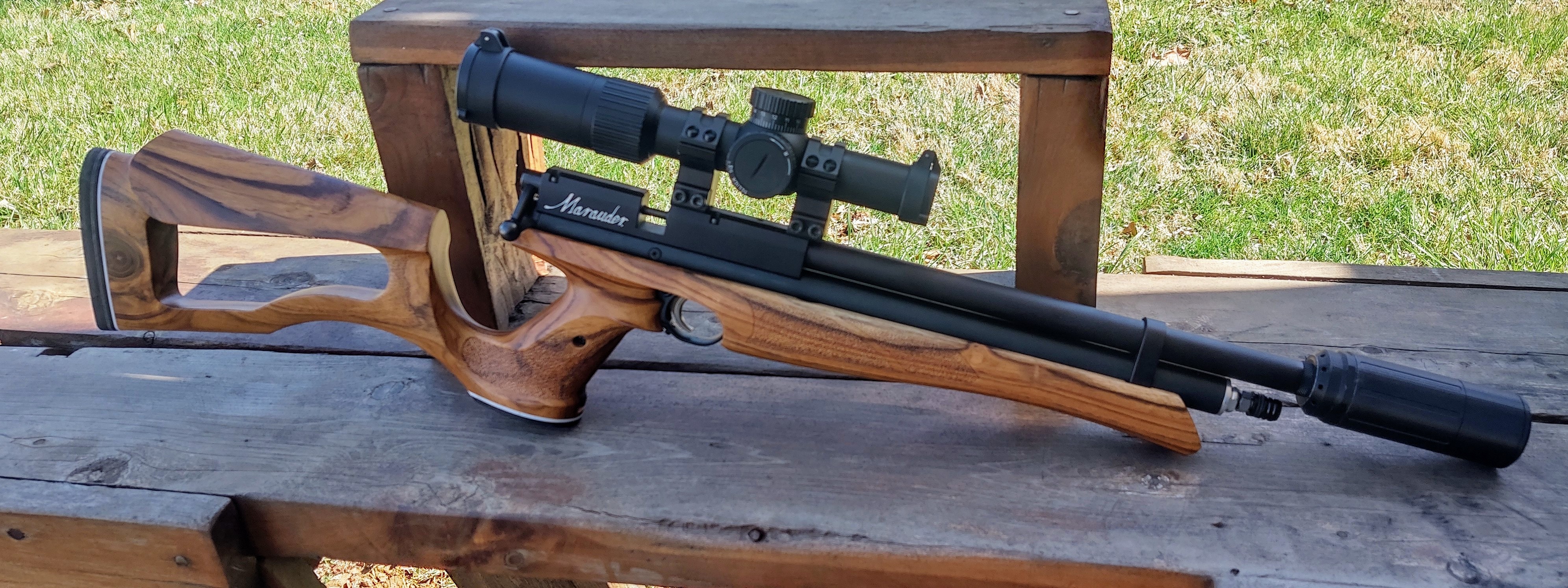

My first Prod turned into a rifle by adding a 160 stock along with Mrod trigger and LW barrel. It is very accurate.
My second Prod is still stock and I keep saying it is not accurate enough. But that isn’t really fair as I compare it to the first one or my 1720 or 1701.
I also have not given it any love to make it “More Accurate”. I will work over the barrel out of the first on some day and see.

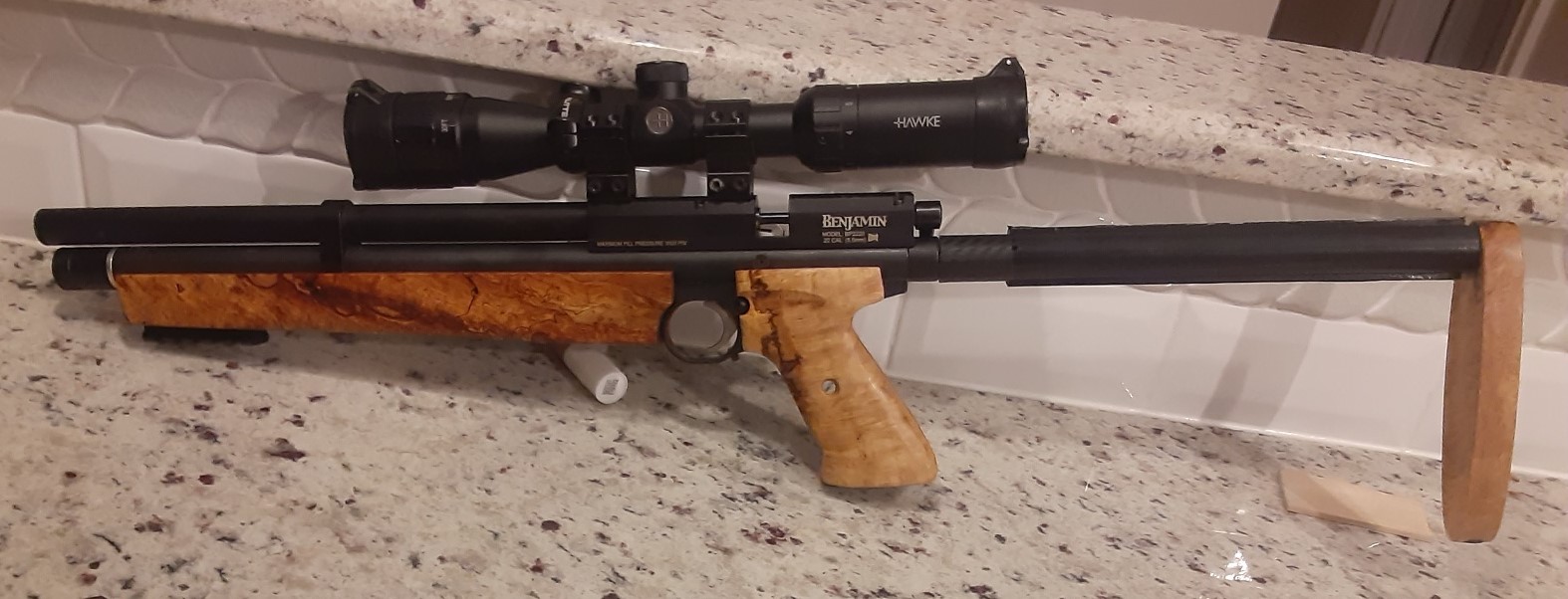

My Prod is most accurate with H&N copper plated FTTs. Your gun would be better for bench shooting than mine but I shot a little over 190 on the 30 yard challenge with it. I did a B-staley mod to get 20 shots at about 25 fps velocity variation and 3 full magazines with something like 40 fps variation. I shot the entire 30 yard challenge target (24 shots) on one fill. I was holding up a little for the last couple shots, however. It normally wears the Hawke 2-7 in the picture but I put a 32X scope on it for the 30 yard challege. Awfully big scope for a little gun. I'm getting 17-18 fpe.

That’s an awesome build! And pretty respectable scores to boot
