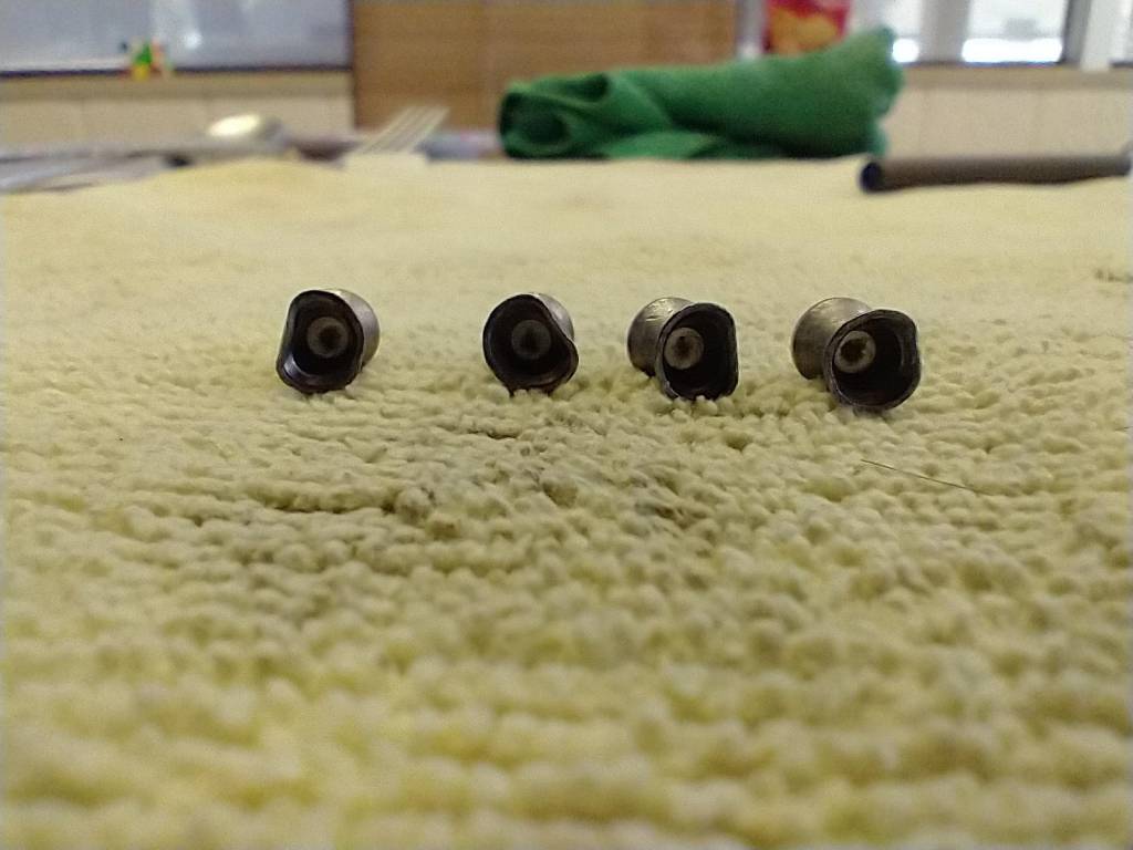

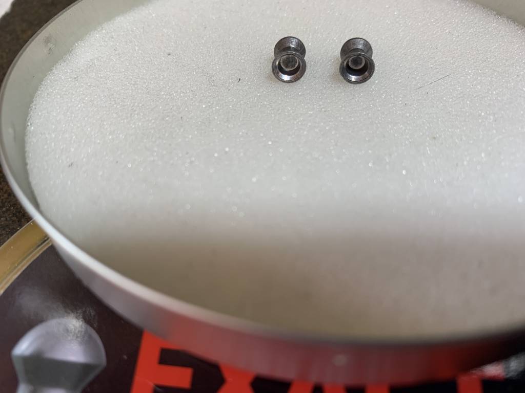

Sorry for the long read. Over the last yr my wife and I started shooting .22cal pcp air rifles. We purchased several types and brands of pellets. My gun seemed to prefer the JSB Jumbo 15,89gr and hers the JSB Jumbo RS and the Jumbo. So here's what's going on. I purchase several new tins of the JSB Jumbos which have been on back order for awhile and found neither of our guns shoot the new Jumbo 15,89gr very well. 2 tins have some damage to the tins and several of the pellets are damaged as well. So today I did a little testing. I pulled 10 random pellets from each of the undamaged tins, weighed them, inspected them, chronograph and shot 5 from each can. 25yrd bench rest. I also did the same from 2 type of Crosman premier pellets and the JSB Jumbo RS. I feel there is a problem with the new pellets.
Here are the results and some photos.
JSB Jumbo 15,89gr
80 samples (10 from each tin) 16 pellets damaged, weights vary from 15.6gr -16.3gr. 662- 685fps targets #1-8 (all 4 corner targets)

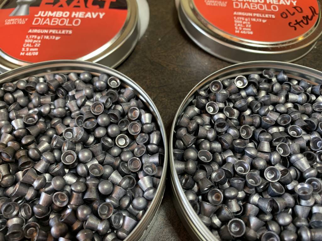

Thanks for the info and opinions. This post is to see if anyone else has had the same issues or is this normal for this industry. At first we purchase several different brands, weights and styles of pellets. Did a lot of target shooting to find the pellets the guns like/ dis-like then purchase several tins. Now that we are running low on pellets and I re-stocked on what I assumed would be an "exact" replacement, I'm not seeing it. I tested several of the JSB Exact series pellets from our testing phase and found the weight variances mostly .1gr. It appears that JSB QC maybe an issue. I have contacted the vendor I purchased these from to see what they recommend. See I also shoot ELD and do all my own re-loading so I'm very familiar with projectile-load-primer variations to see what a particular gun likes. I wonder if should start the process back over of finding a new " lot" of pellets?

bubblerboy64 I recently purchased 10 500 rnd tins for one of the main online stores and I got what they sent me.. (no names as its not their fault and they are replacing the 2 damaged tins). There is nothing on the tin as to indicate a production date or "lot" #. I was wondering if others have run into a change in QC from JSB. Up until I have liked their products. I don't want to re-order and have the same problem. I'm wondering if they are rushing production to fill back orders which may be hurting QC or I got a bad run etc.
