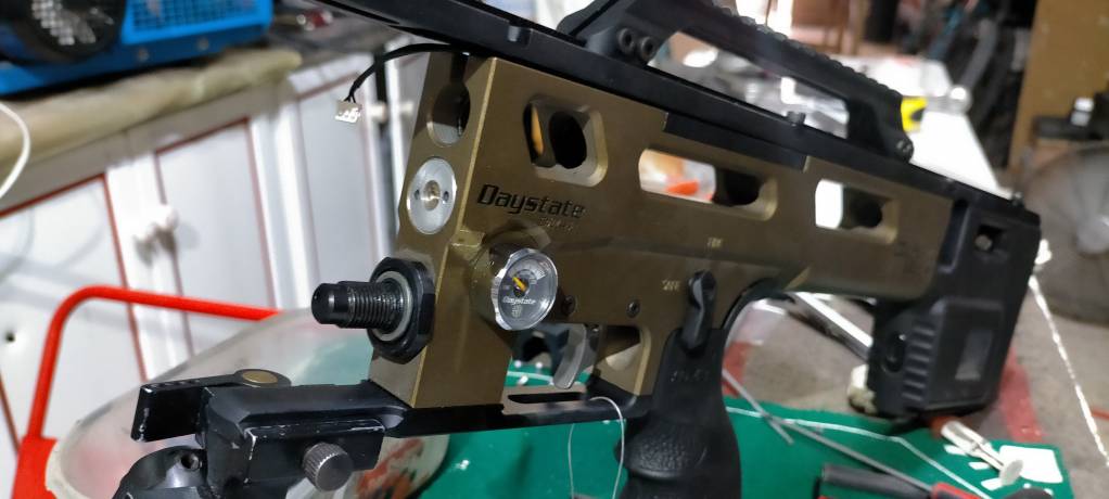

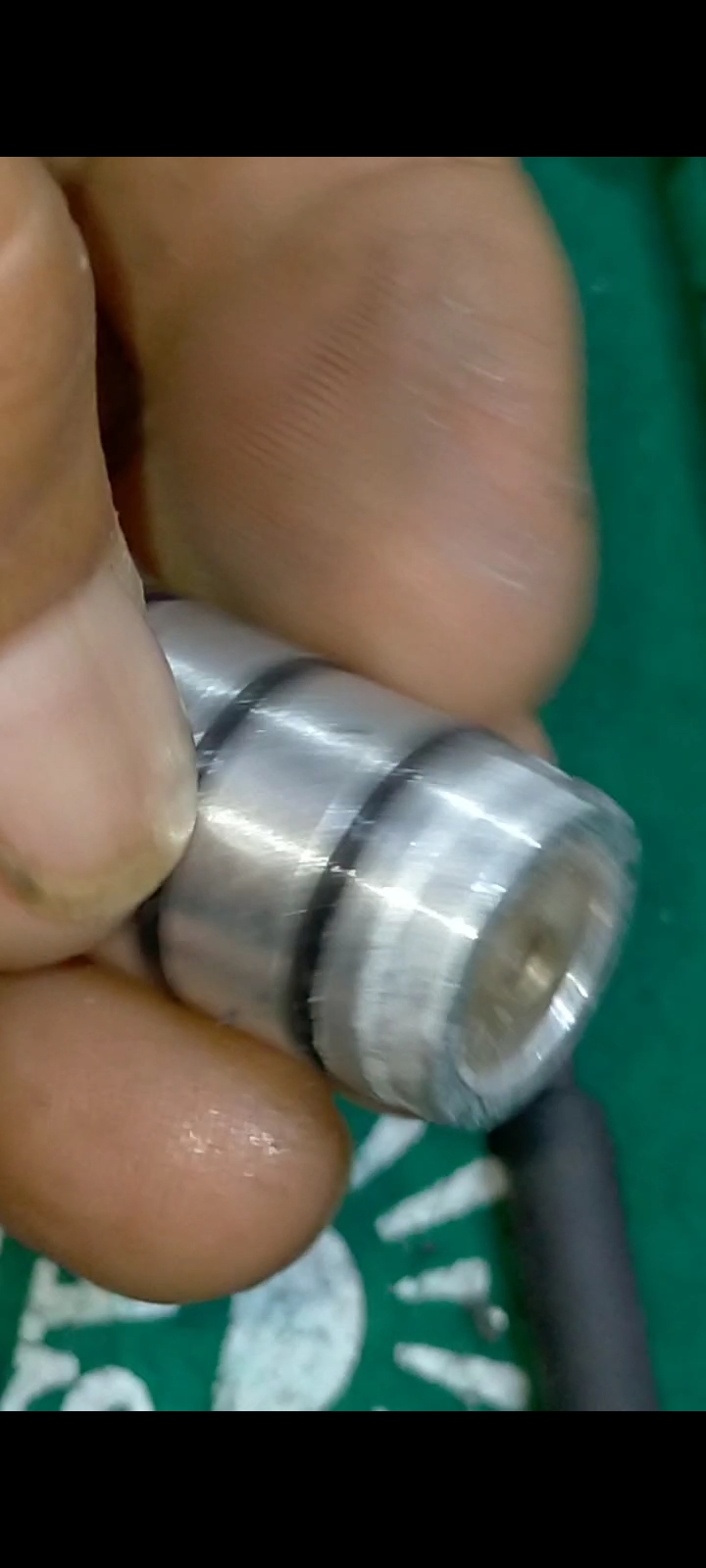

Ok back again, now I have some problems and I did send back my delta wolf .22 HP to the dealer and I hope that he can fix it. problems are :
1- Leak from Valve
the gun now cant hold air anymore, an air leak coming out from barrel or actually from transfer port area, my guess is that it leaking from the valve it self.
2 - Degassing problem
I cant de gas the gun easily, when I remove the Bottle and let say that the regulator is on 150 bar and I want to reduce pressure, I have to dry fire so so many times ( like 40 times ! ) until the air leak from plenum, which is so painful to do.
3- Carbon Fiber bottle Oring problem

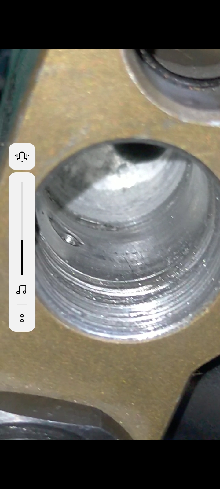

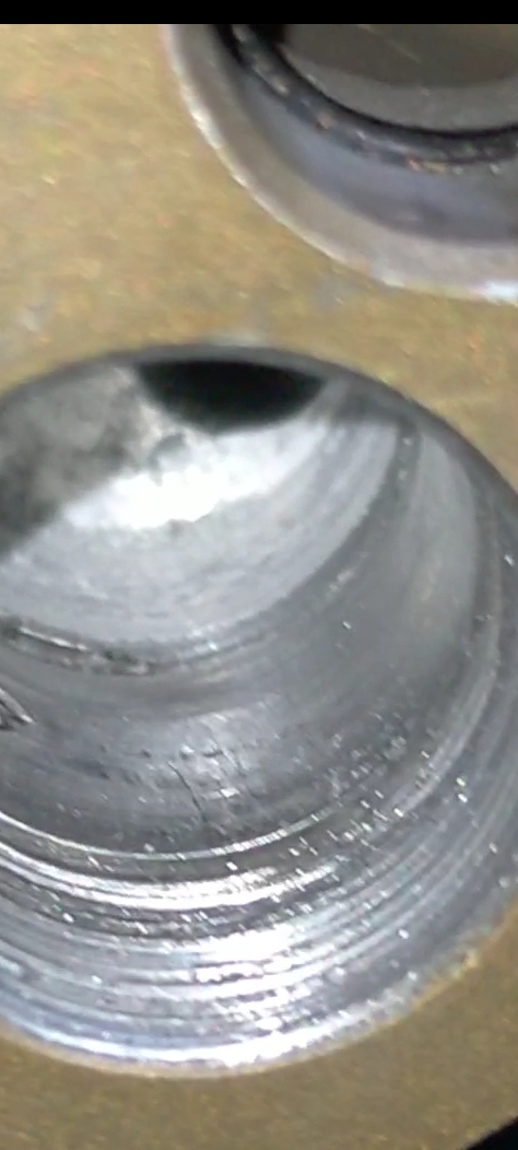

one time I opened the carbon fiber bottle, and it was hard to turn, and after I remove it ,the Oring inside the carbon fiber bottle is removed from its place, and it was squeezed in the thread grooves and ofc was in bad shape and need to be changed ! how in the world this happen ! no idea.
4- Factory mode problem
the factory mode is not working properly on 14,15 and 18 grain. when i set the speed on any speed, the gun shoots far less than the given speed yet it works flawlessly on 25 grain!! I don't know why this is happening.( ofcourse I did adjust the regulator as requested from the screen )
5- Regulator cant set lower than 100 BAR
when i try to lower the regulator lower than 100 BAR, the gun leaks air, if you ask why you want to do that? well the gun it self ask to lower the regulator to 96 bars for shooting 18.13 grain on Factory Mode.
6- Magazine fit
you have to try more than 4 times to put the magazine into the gun. it is not fitted well tbh, really a shame for this price tag.
this is so frustrating tbh, i have 8 air guns and never ever have any problems with them, and this Delta Wolf have a lot of problems, and i am kinda regret to have it.

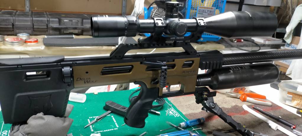

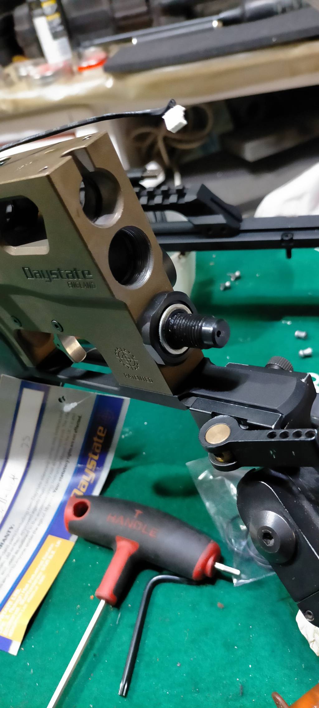

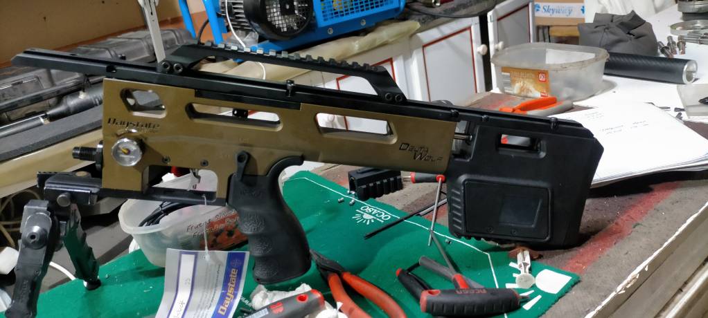

finally, I have discovered something I think it is really bad, now the rails of the scope base are tightened on the top of the body of the airgun, I mean on the long aluminum piece that has 12 or 10 screws, these screws are paired on each side, now if you tighten the screw that is near the magazine area, you will never been able to insert the magazine! because it will move down few micro-millimeters and will block the magazine, which means that the long aluminum piece will not be on fixed and accurate position and since the rails of the scope base are tightened on that piece, definitely the accuracy will be affected by this and this might be the answer why many users have zero shift problem . I might be wrong on my conclusion, what do you think ?
