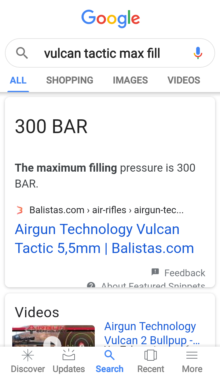

Fill it to 300 bar and run it over the chrony post first 30 shot chrony numbers.
