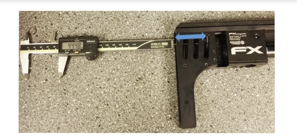

villaman, did you measure this ? To make sure the transfer port is perfectly aligned with the barrel brass port.
Yep the kit is all good it’s probably me
