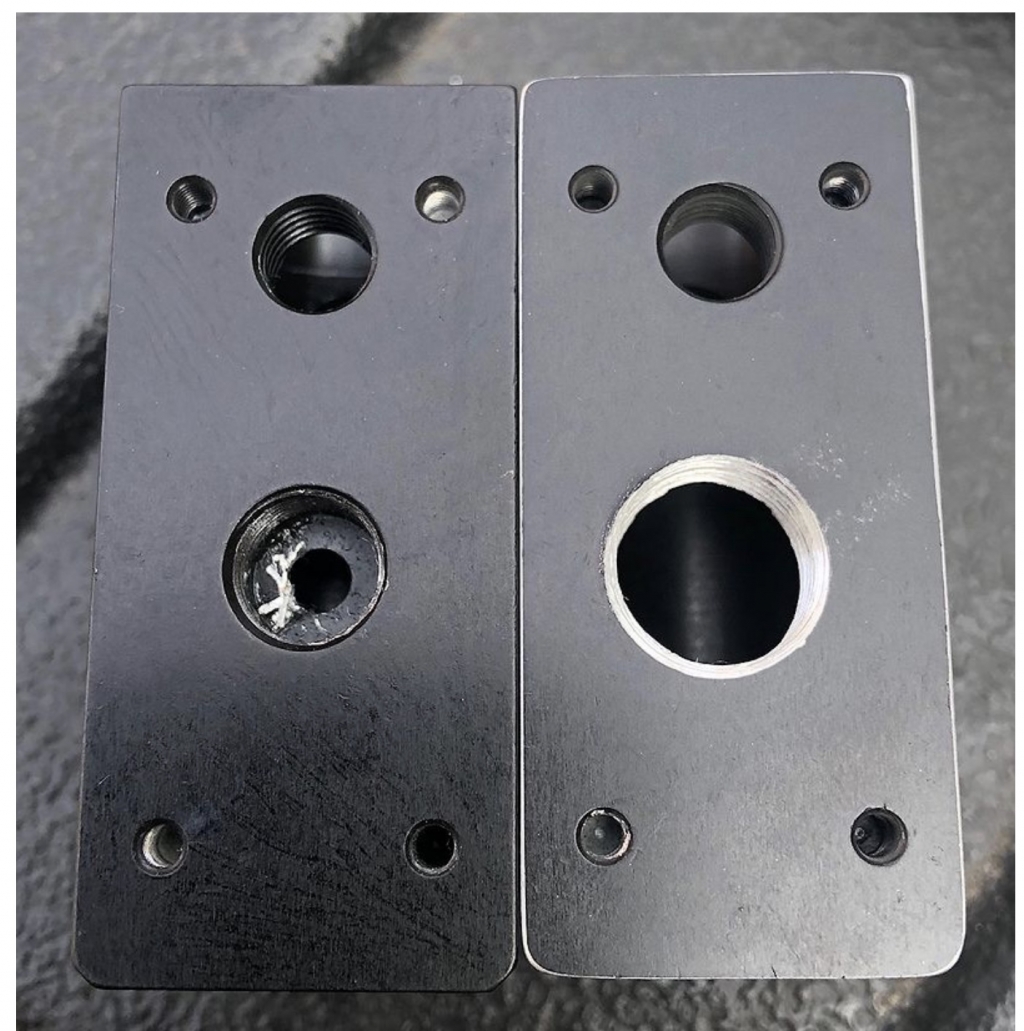

Is your valve seat have been modified to 6.5 mm ?
And the rear block is more efficient when modified for less air obstruction.
Am I wrong ?

The block on the right is like mine and has been milled and threaded M14 for high flow. This isn't required for normal external plenums. They use the block on the left with the center hole drilled to 6mm.

Did you drill the gauge hole in the rear block to 6mm ? If not you need to disassemble and carefully drill it through the teflon seal. Remove any burr on the inside where the o-rings will slide over to prevent nicking them. I use 3M pink polishing paper for this.
