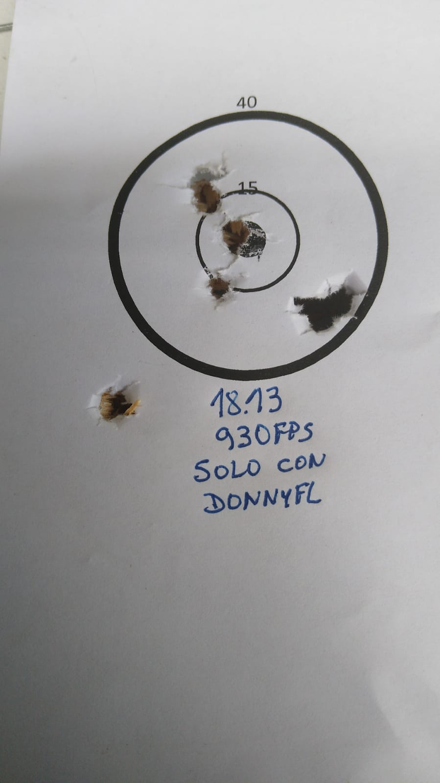

Problem with my new cricket 2 tactical NO Accuracy

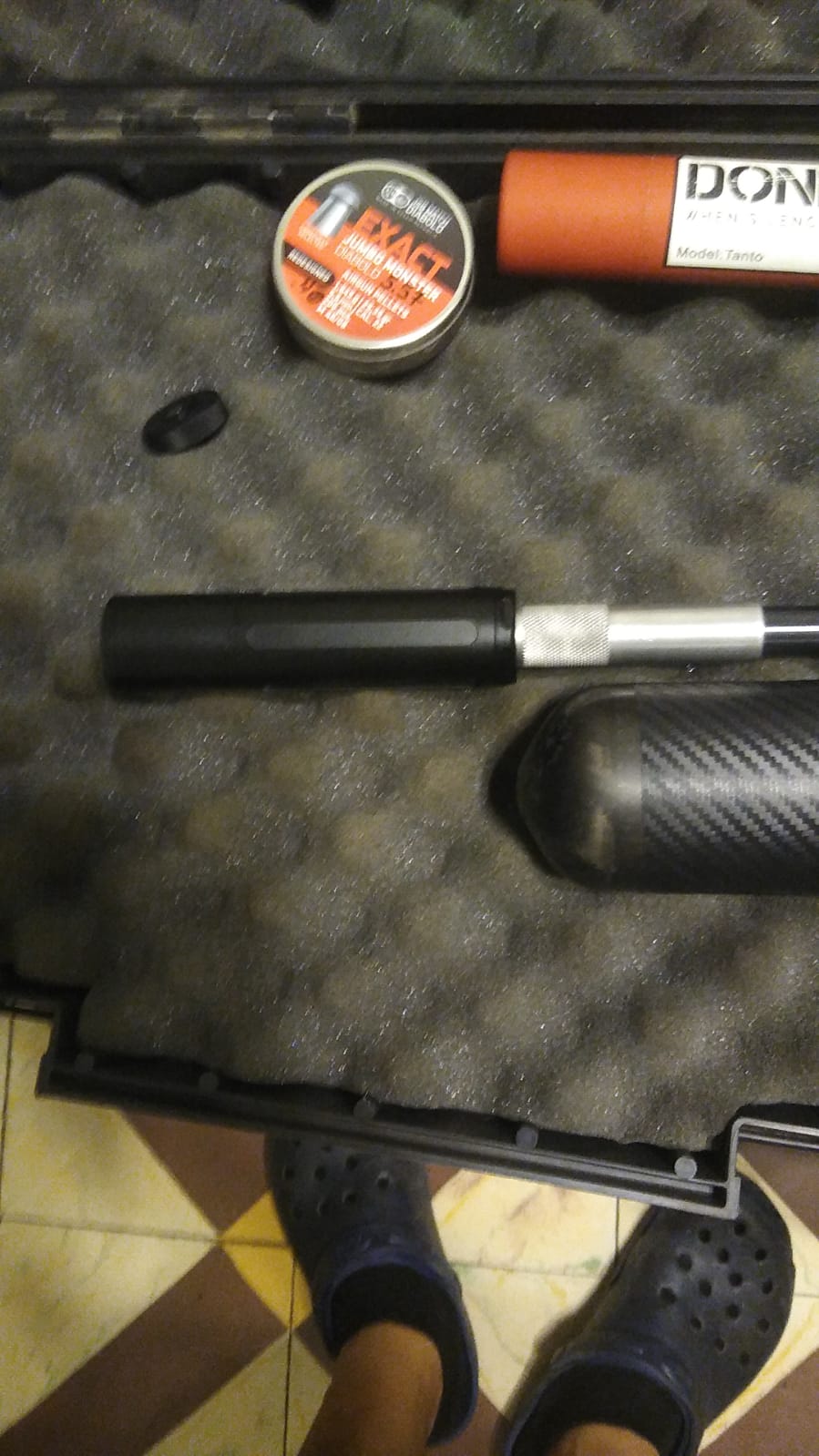

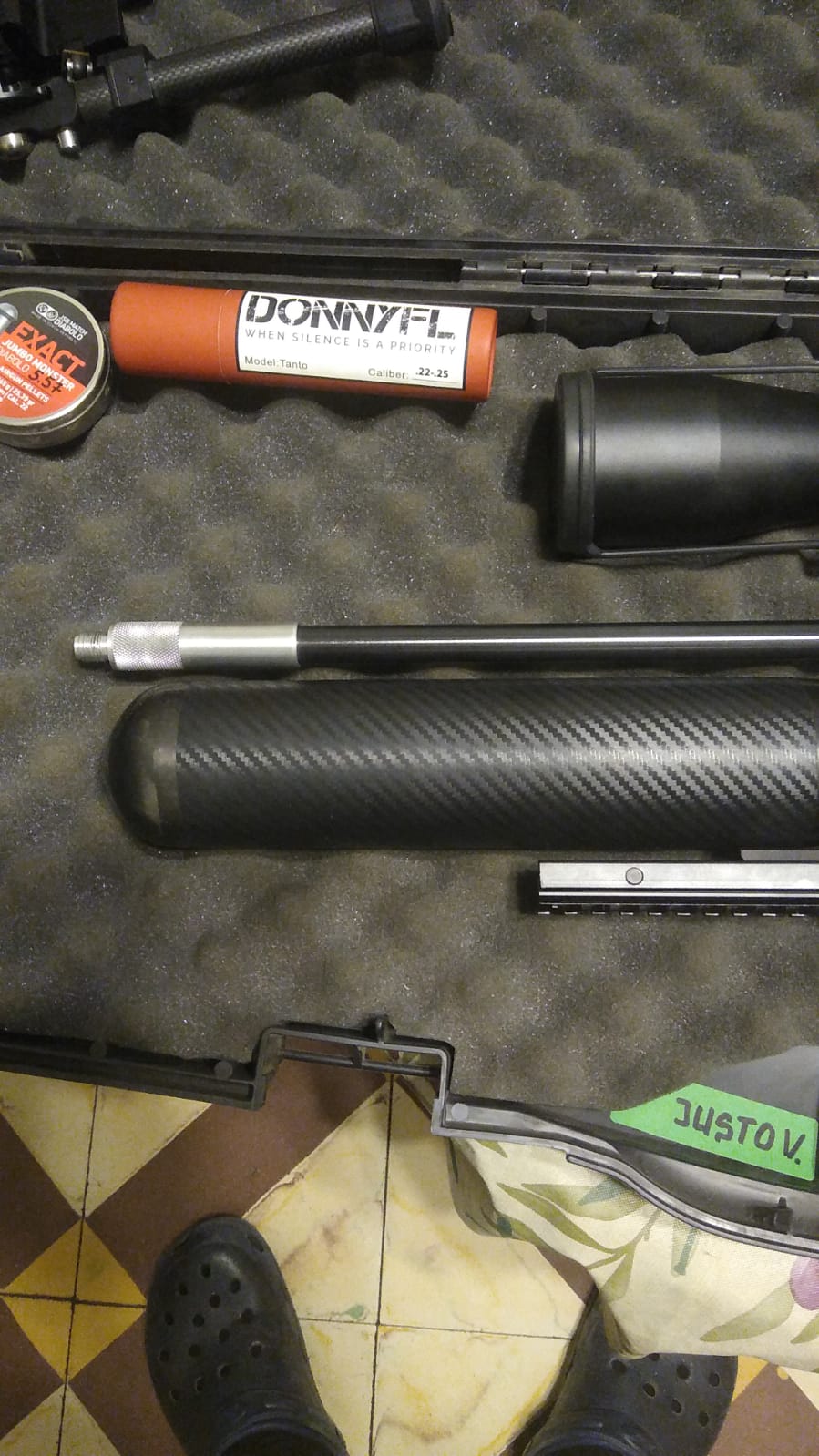

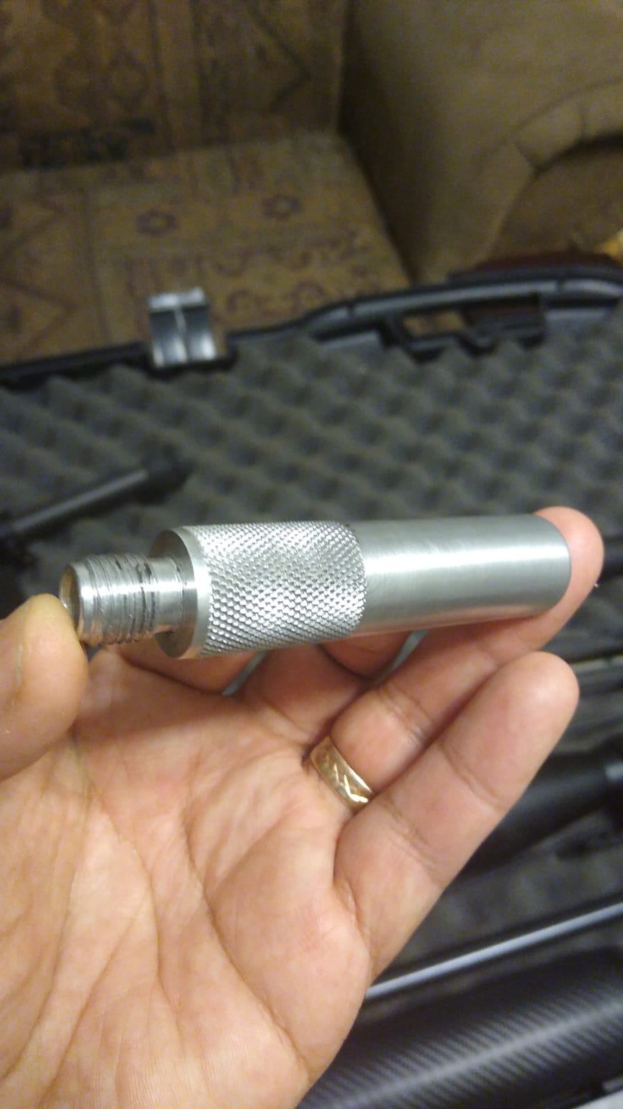

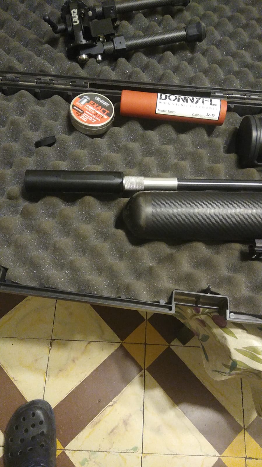

Hello friend, I shot without shroud and it groups very well at 50 meters with 890 FPS. With shourd, falls to either side, does not clump. What do I do friend? You are totally baffled! The first three images are WITHOUT shroud and the last two WITH shourd.Thank you.
