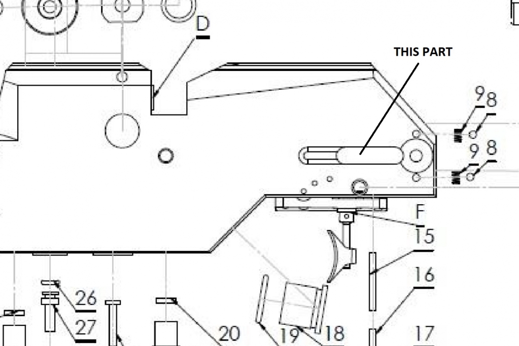

The small sliding block with the adjusting screw gets "stuck" for lack of better words... I notice this when I remove the action from the stock, it "pops" back to being loose with light finger pressure...
This part...
The labeled part in the image above gets "stuck" towards the adjustment knob side of the opening, has a slight "hang up" and requires me to push it back towards the breech, it then slides freely back and forth...

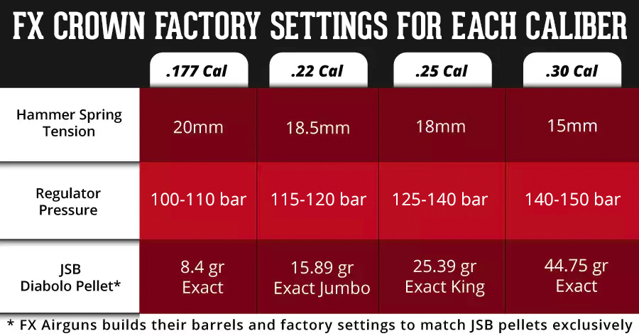

Two votes for this method, I will use this method next time I need to... From talking with another member it may be my hammer spring tension is too high and my regulator pressure too low at 115 BAR... Can others offer a better starting REG pressure for JSB 25.39s...???
One thing I notice is this: no matter what regulator pressure you have the cam mechanism has a point of adjustment where each click is felt to move the slide, out of this range the cam has zero effect after a certain point, a low limit... This tells me I can only increase the hammer spring tension from that point, and to lower it I must use the power wheel... I'm no dummy and it seems there is only one correct setting for this set screw that allows for the full range of adjustment of the power wheel other than increasing the hammer spring tension... Am I missing something here...???
Hey, I'm learning here...!!! And the part I identified in my drawing above is not identified on the parts diagram I downloaded directly from FX Sweden... I don't know what it's correct nomenclature is...

On the hammer spring adjuster being stuck. Does it feel like a mechanical locking up or could it be some oil on flat surfaces that creates like a suction effect? Have you unscrewed the hammer adjuster and checked it for burrs or other reasons it could be hanging up.

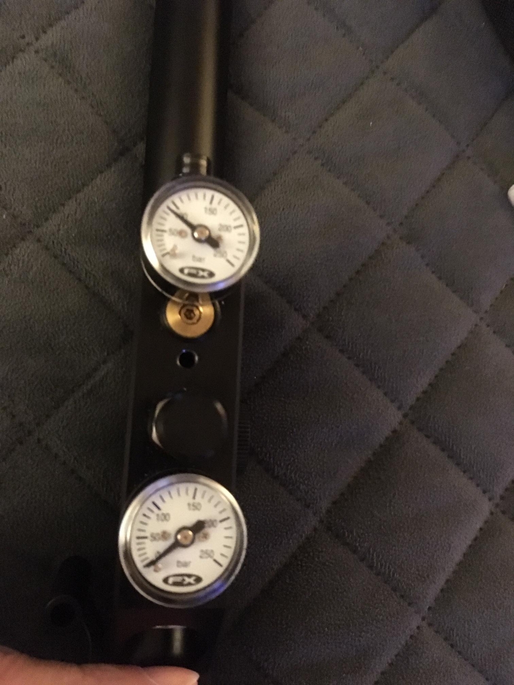

Thank you for all of that, I will be calling FX tomorrow as my Crown is only about three weeks old... I did better tuning it with just the chronograph, although the gauge read a lower than expected pressure it was consistent... Others said it was too low at 115 (per my gauge) The gauge that is obviously faulty is the bottle gauge...
I m going to watch more videos before I get into removing the hammer adjuster, it does feel like a mechanical lock up, if I cock and de-cock the action it will release, sometimes... I do appreciate all the help and advice I get here...
