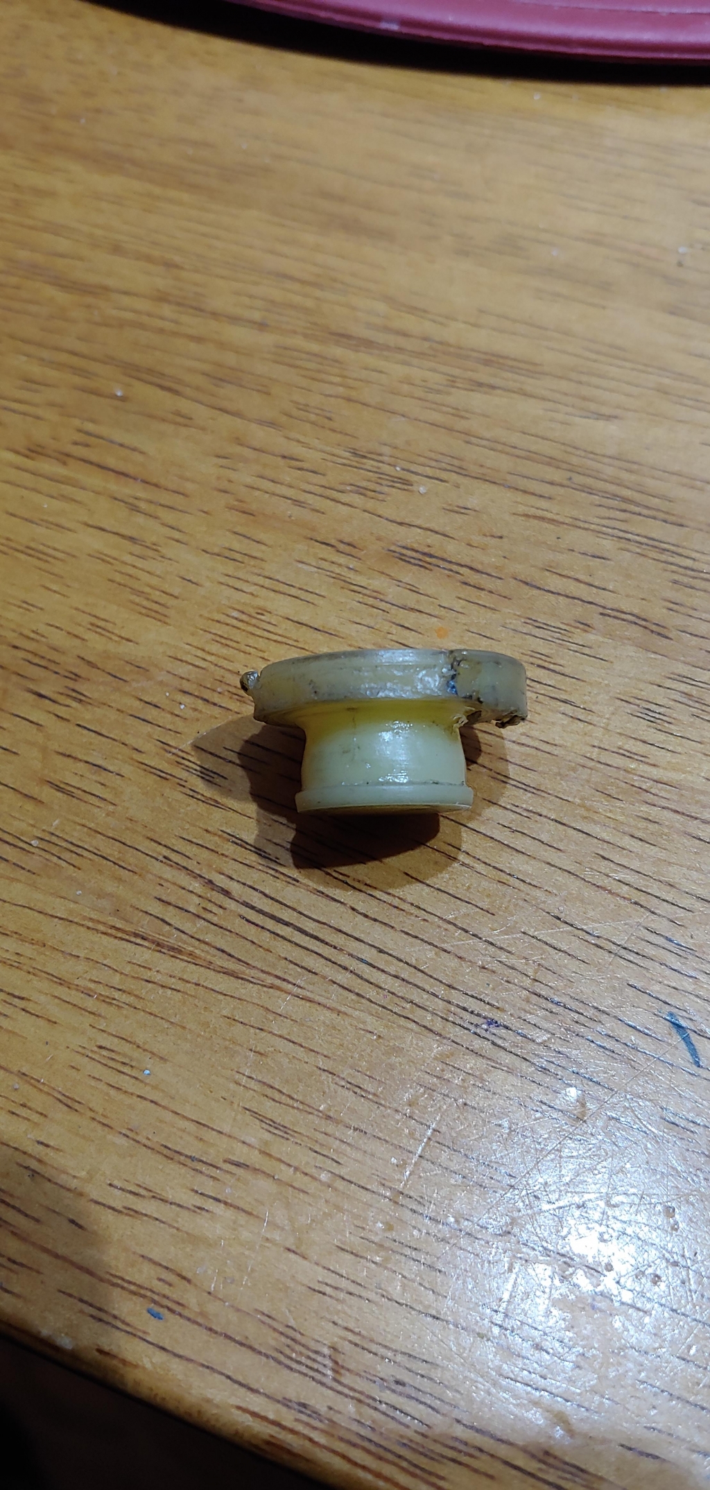

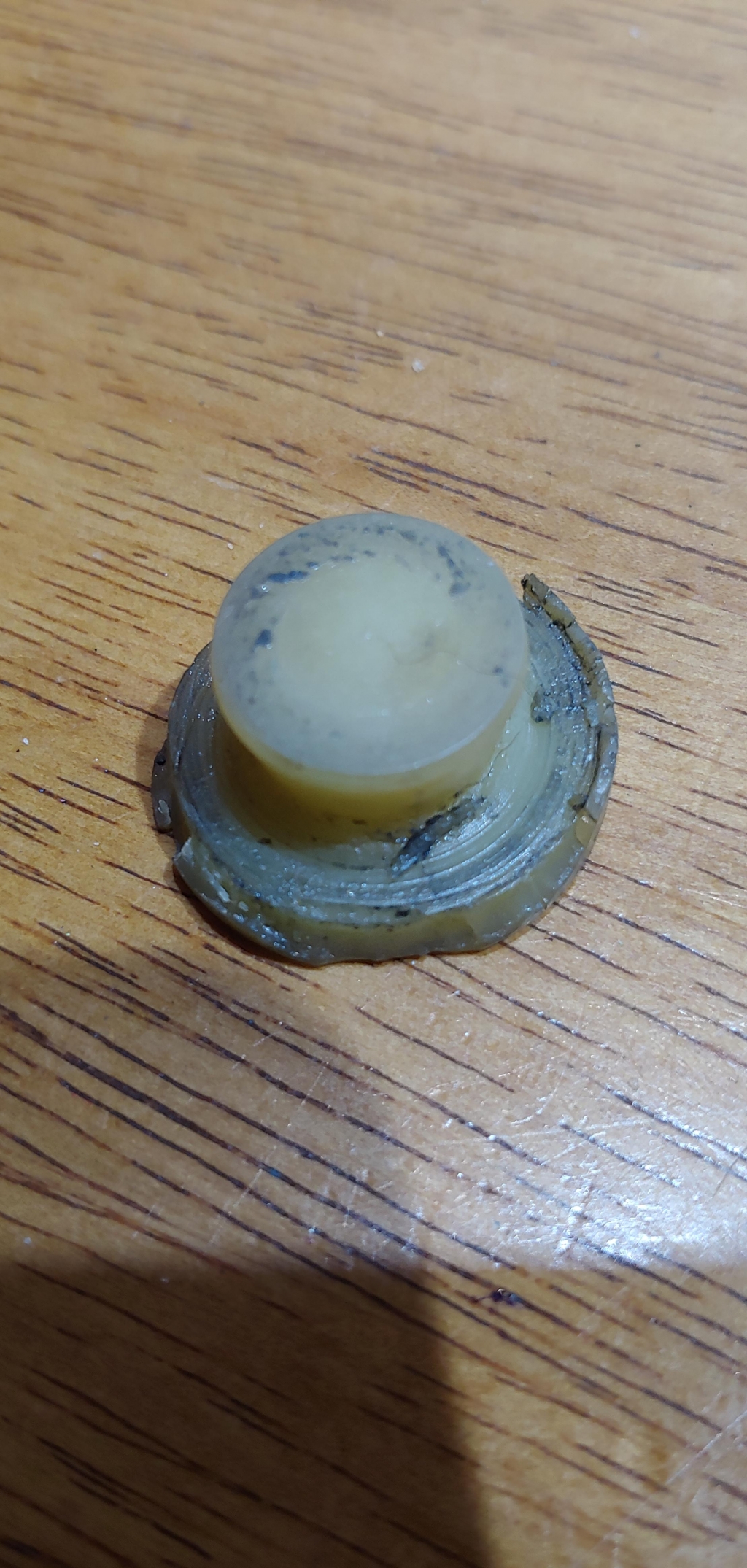

Problem with my FWB 124
Indeed, if the 124 has never been opened up prior it has the original piston seal which by this time in years is totally rotted away and in pieces.
Air rifle headquarters sell a modern material replacement. getting out all the old seal which whats left will be well beaten into the roof and corners of compression chamber needs to be diligently removed.
Common with these 35+ year old treasures and well worth having done by a competent airgun smith or one who has been there before.

@ohiochuck, your piston seal probally look worse then this fwb 124d seal.
