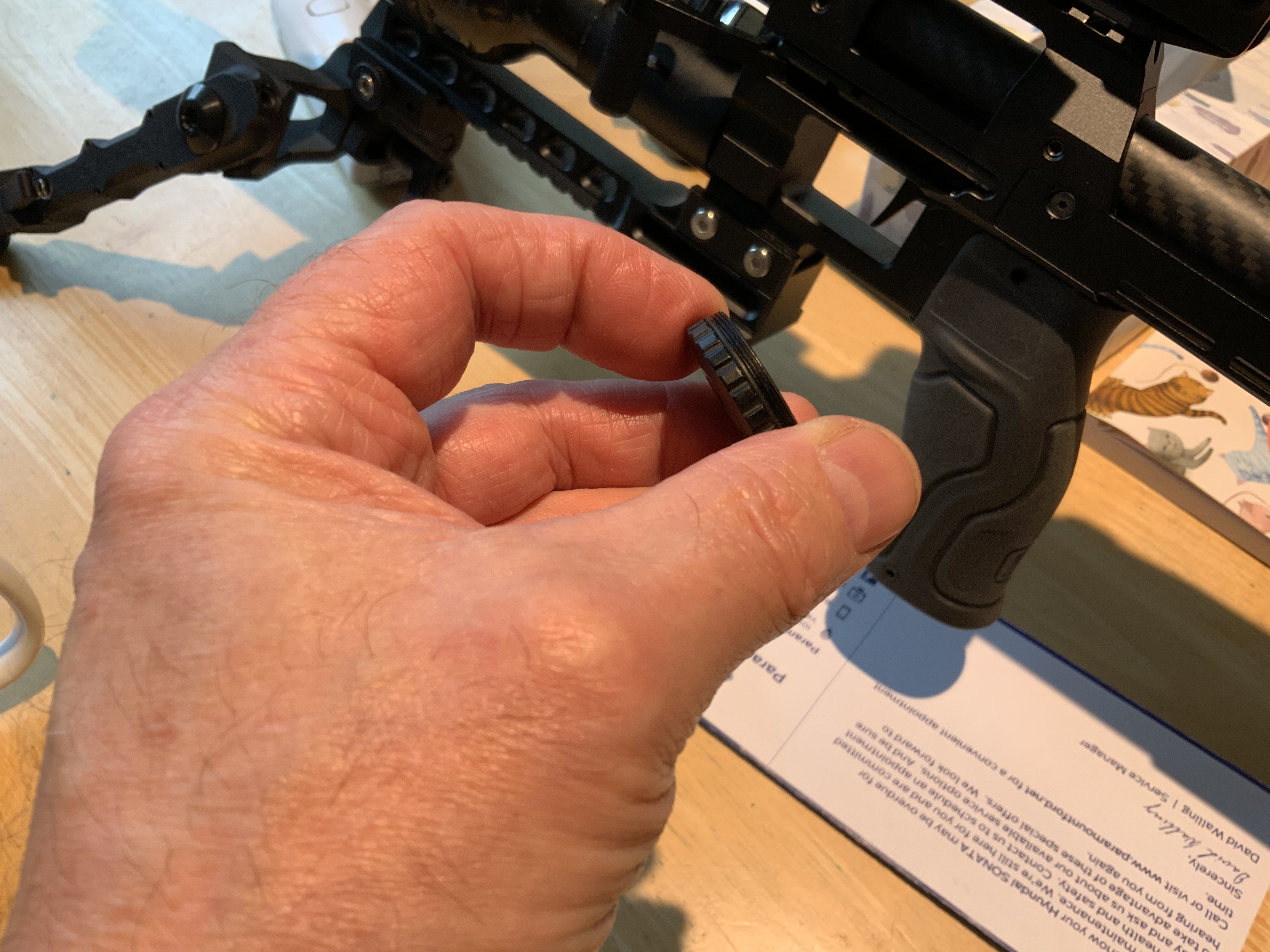

I will bear this in mind when using the pliers. I am not sure how the threads work in my cap. I wasn't even thinking about male/female threads. I'll start easy and see if that works. I am now thinking that I will need two sets of pliers: one to grip the coin-edged cap and one to steady the illumination dial that abuts it. Here's a picture. S7

Copy. There are a few ways to skin this cat (cap). I just said to another member I realize I will need two sets of wrenches/pliers. Thanks. S7

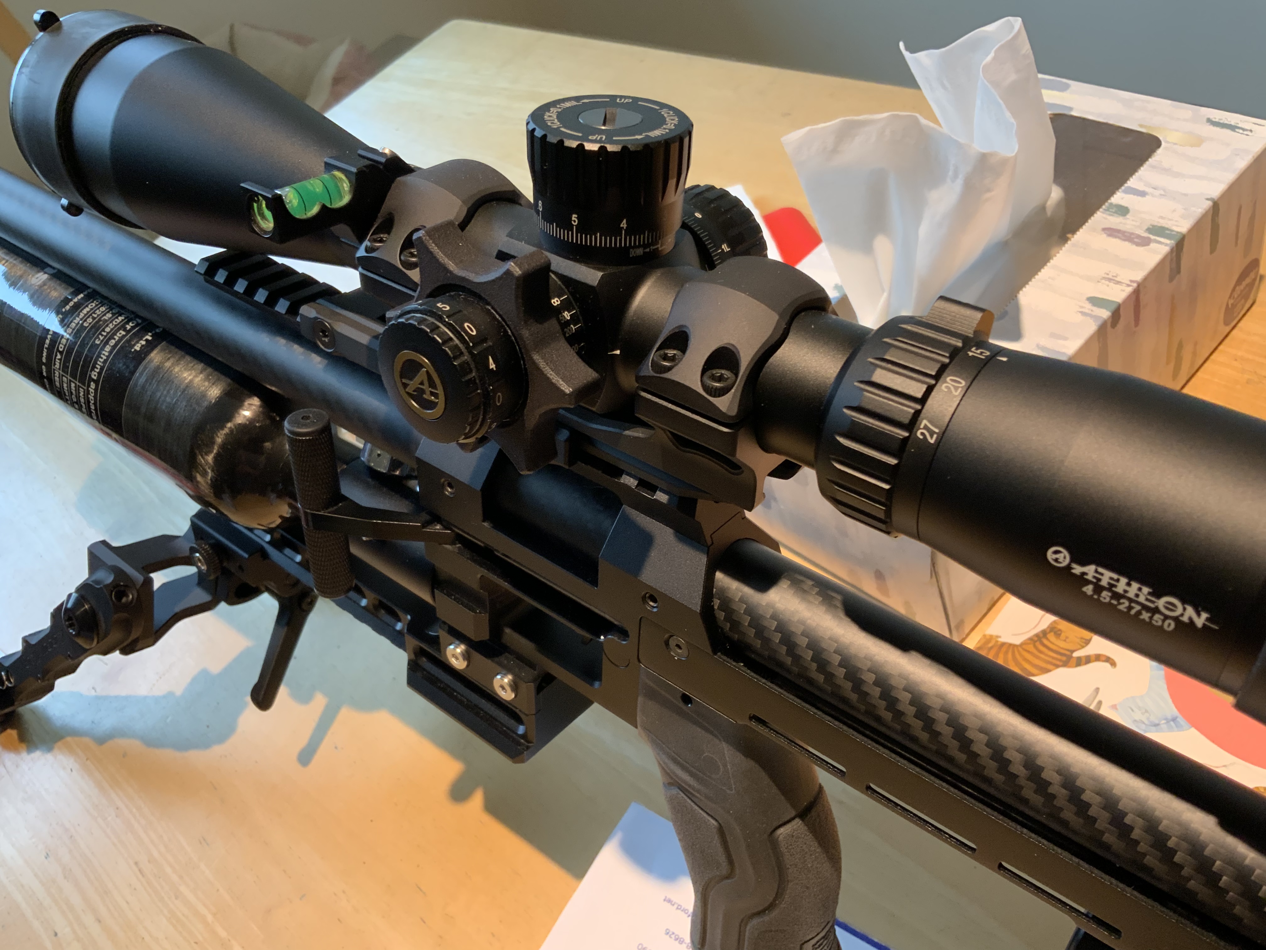

Here is my Ares BTR, not sure if yours is the same.

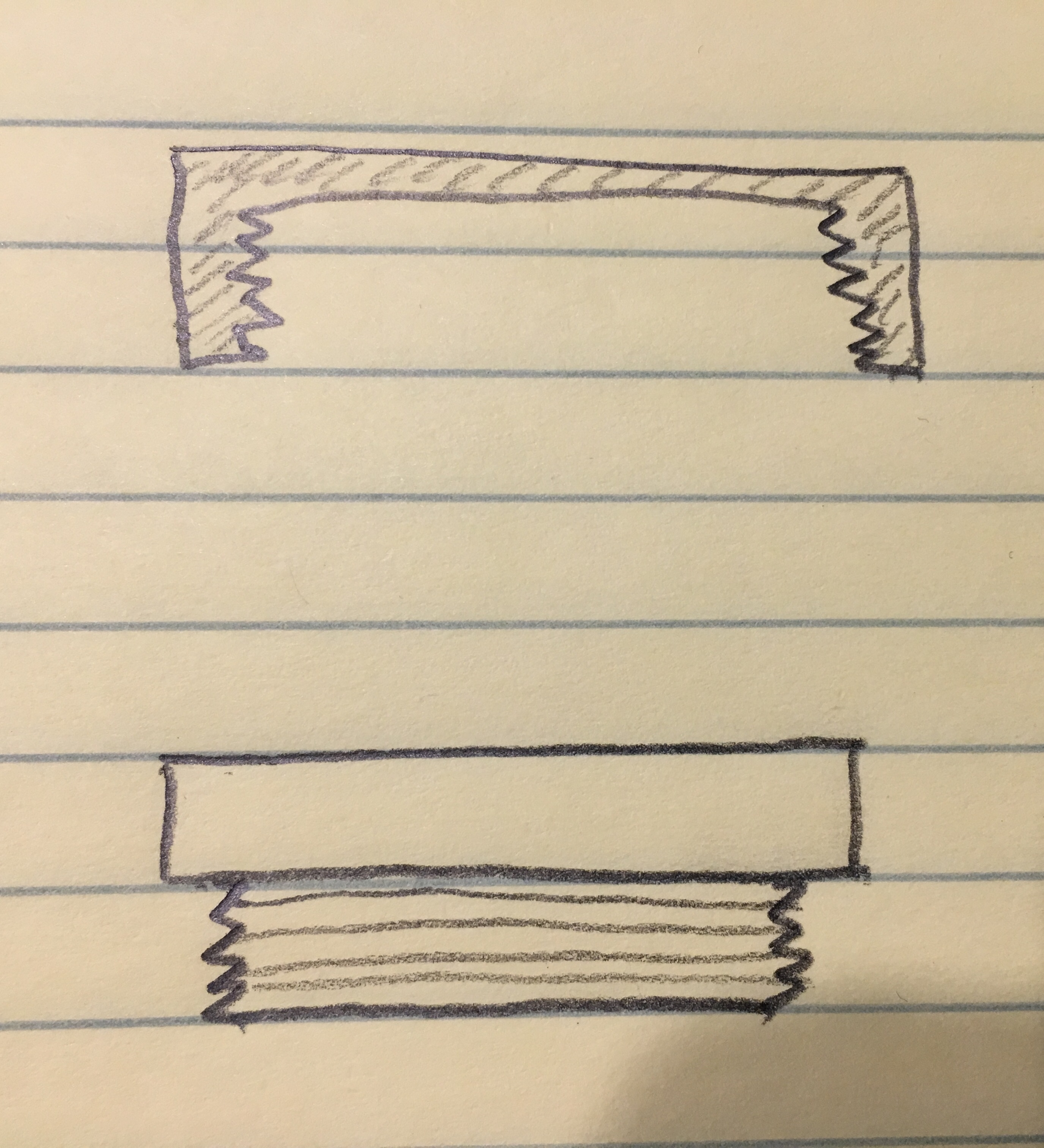

I do not know what your cap design is. If it is internal threads like the top sketch, when gripping hard with pliers, whether hard jaws or soft jaws, it can be squeezing the threads tighter on the scopes male thread. Gripping as little as possible of the top of the cap is critical.
If your cap is like in the lower sketch, squeezing the cap will not cause the threads to squeeze tighter on each other.
When I was working, I have made more than one special wrench to remove caps just like on scopes. Always custom made for the job at hand.
If my situation is the same as Scotty1’s with his Ares BTR (the photo is in this thread), the second photo seems the match. Thanks. S7
