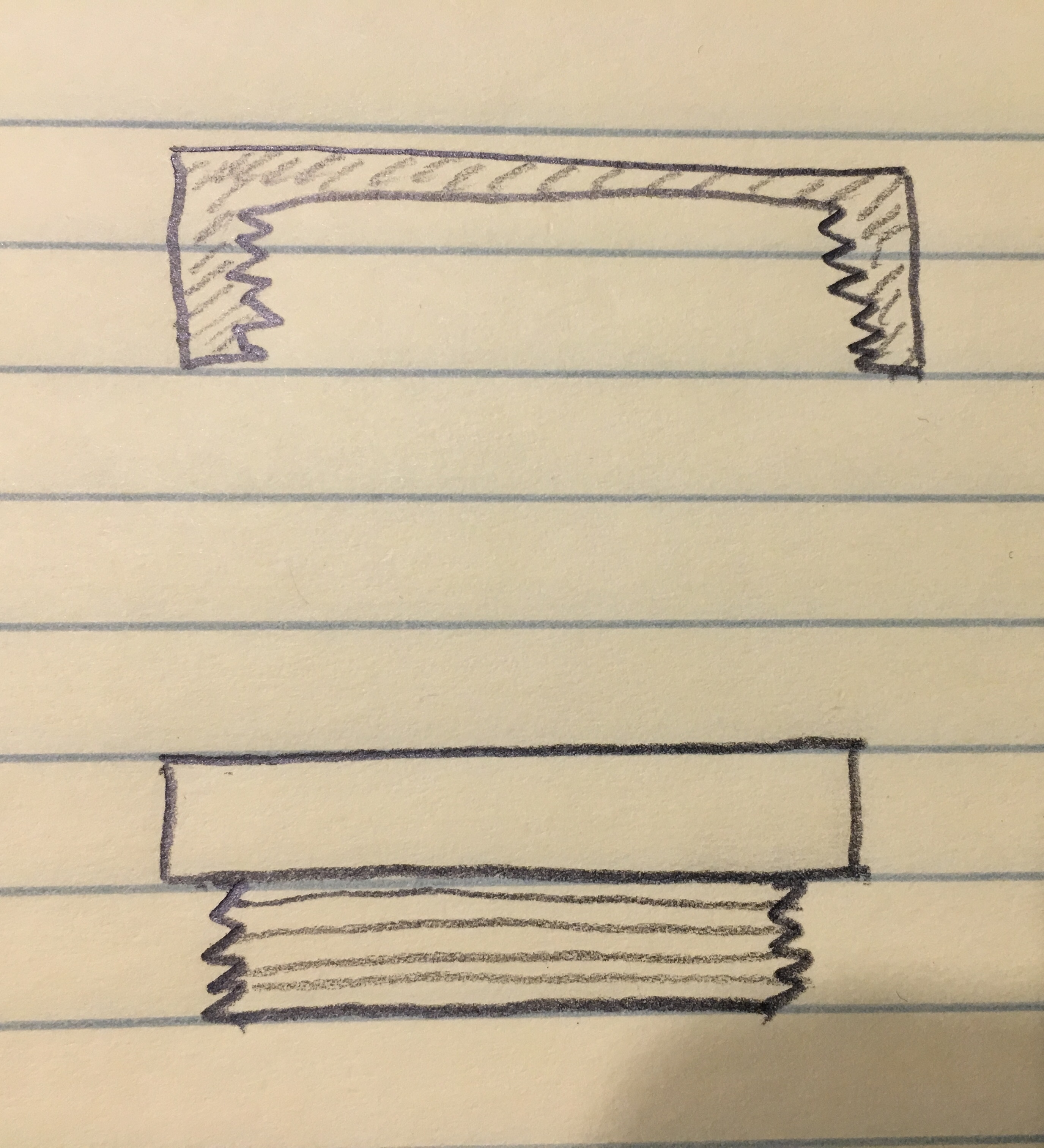

I do not know what your cap design is. If it is internal threads like the top sketch, when gripping hard with pliers, whether hard jaws or soft jaws, it can be squeezing the threads tighter on the scopes male thread. Gripping as little as possible of the top of the cap is critical.
If your cap is like in the lower sketch, squeezing the cap will not cause the threads to squeeze tighter on each other.
When I was working, I have made more than one special wrench to remove caps just like on scopes. Always custom made for the job at hand.
