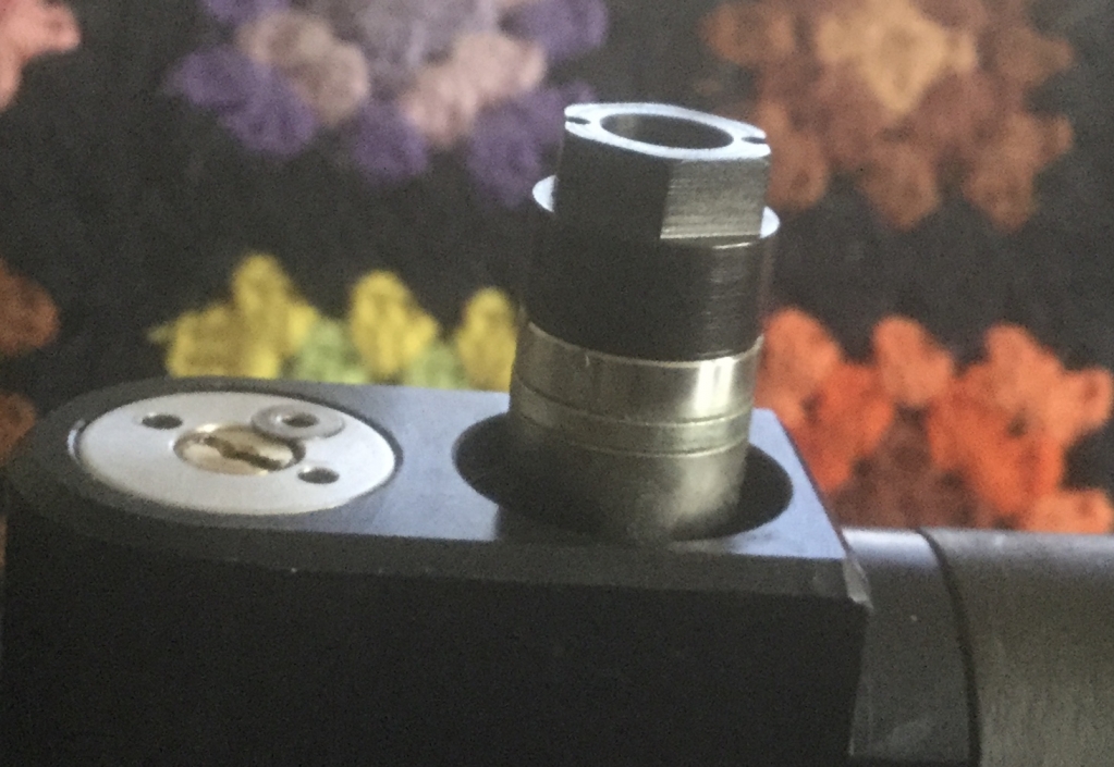

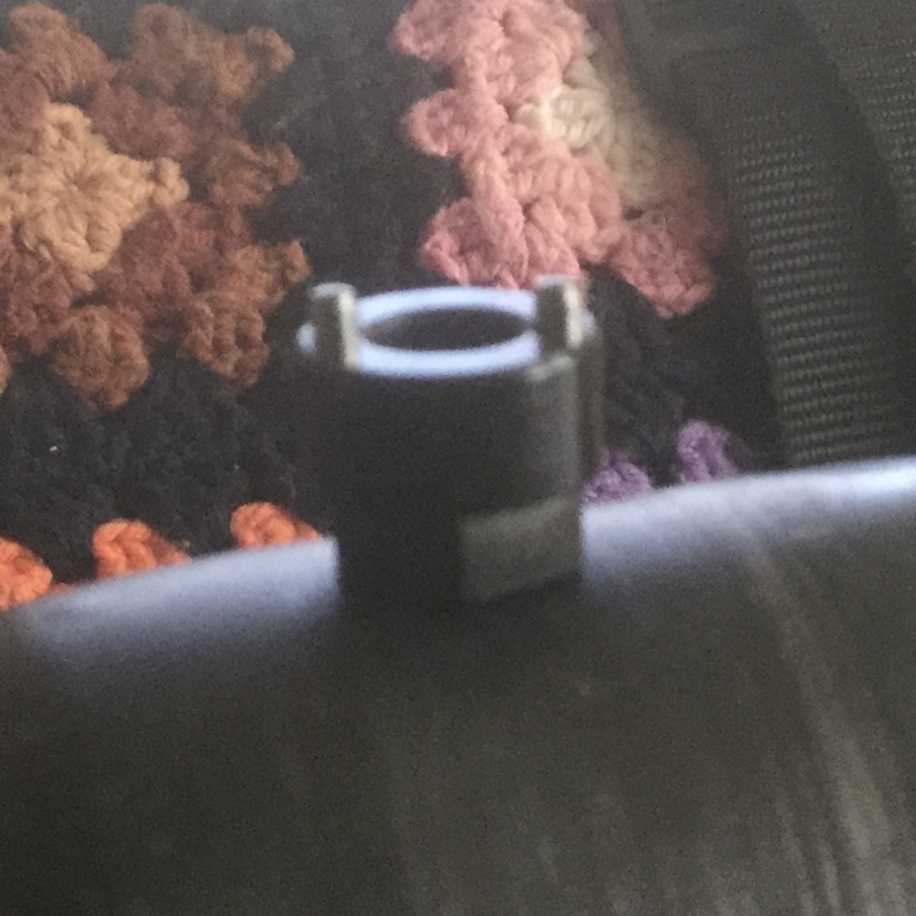

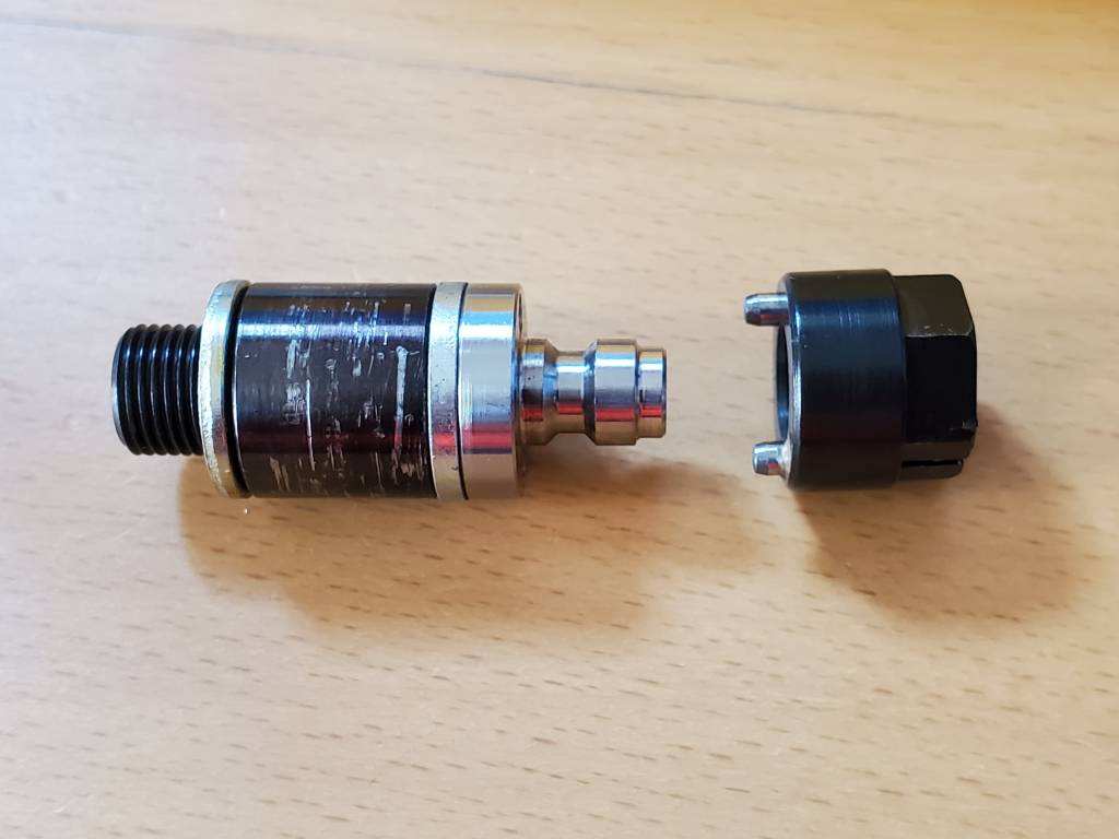

Apparently this happens enough that Brocock now supplies a dedicated tool to remove the fill valve (see pic below). I can get the fill valve itself out using this tool very easily...the problem is, unlike on your Commander the other end of the fill valve is very firmly attached to a round extension piece that prevents you from accessing the other end of the fill valve to get to the o-ring. Since this extension piece is round, its nearly impossible to get a grip on it to secure it enough so that I can unscrew the fill valve to expose the other end it of. Thats why others have said they have to make contraptions out of wood, leather and other things just to get a grip on it.
You can see from the light scrape marks on the dark extension piece below the fill valve that it had been worked on before (it came to me like this, I did not mark those marks today). Really frustrating design.

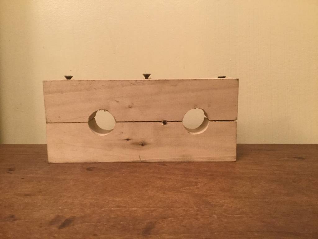

@yenniedn, two pieces of wood as a vise would help. If you have any paddle bits for your drill, drill a hole the diameter of the smooth part you can’t grip into a piece of wood. Cut block of wood in half and use as a block clamp. This is what I use on both my Compatto and Bantam. AOA provides the tool because they should’ve right off the bat... otherwise you needed snap ring pliers? When I had the “issue” your bent on pushing. I was more pissed off at not having the tool for the easy fix. Then the dislodged Oring. It really is an easy fix after watching the video.

My point is, if you have an o-ring inside the fill valve that is prone to get displaced, why attach it to another smooth, round piece that's damn near impossible to remove? In the video link provided by Airgun Advisor in the second post above, it shows that when you unscrew the fill valve from the COMMANDER, it just comes right out since it doesn't have this round extension piece connected to it. From there, you just unscrew the other end of the valve assembly, take the parts out and re-seat/replace the o-ring. However, on the SNIPER, you have to contend with this round extension piece - and if you're going to have it there at all, why not make it notched so that any dumb-dumb can get a good grip on it with an adjustable wrench? That would make too much sense, right?
I've tried leather around it with pliers and electrical tape using a Bionic Wrench which would otherwise fit it great - but neither is strong enough to hold it without the round part twisting under pressure. L.Leon showed a wooden block clamp he had to make to get his off - which is ingenious . . . but should it really have to come to this if this piece was better thought out in the first place?

You can have the following tool from AOA by simply asking... They also have a revamped foster fill that will solve your particular problems and allow you to use the magnetic cover.... Again why the ranting... ? Brococks are super solid PCPs. Non issue being blown way out of proportion...
