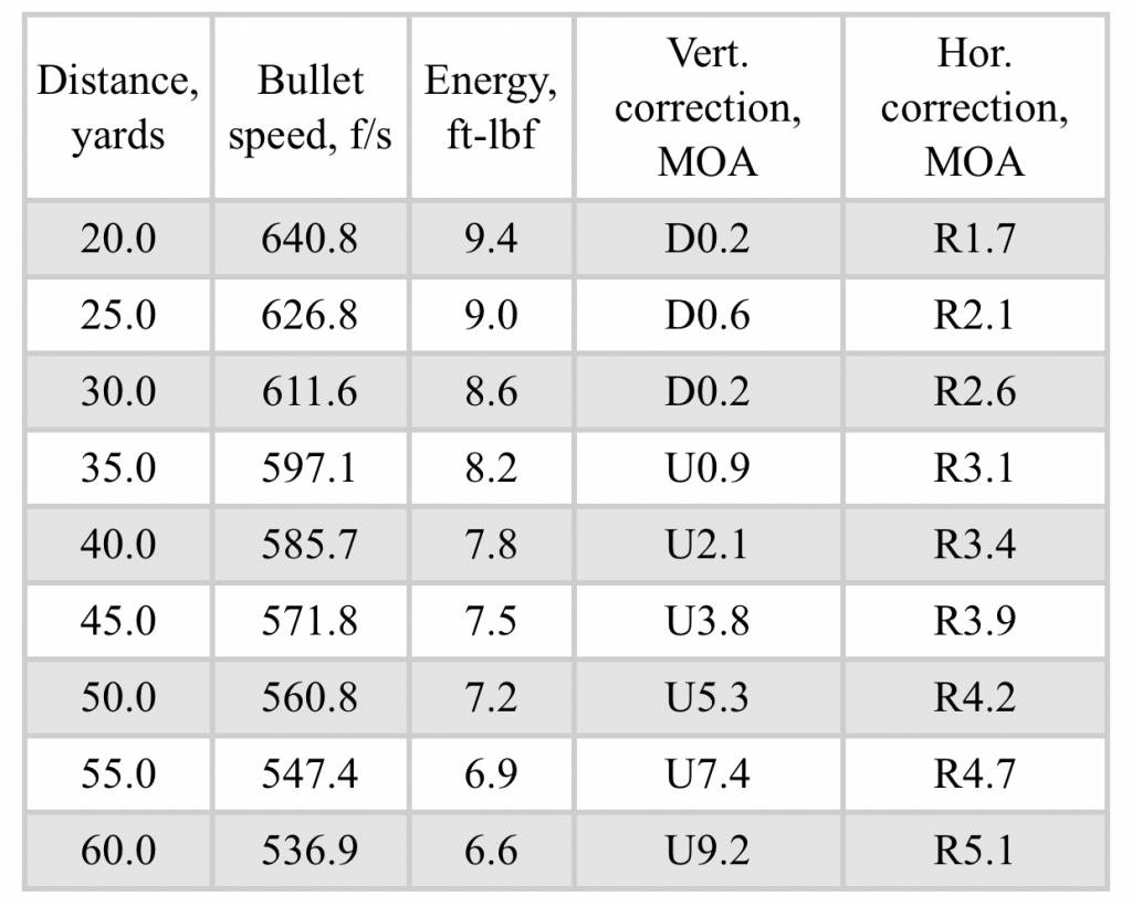

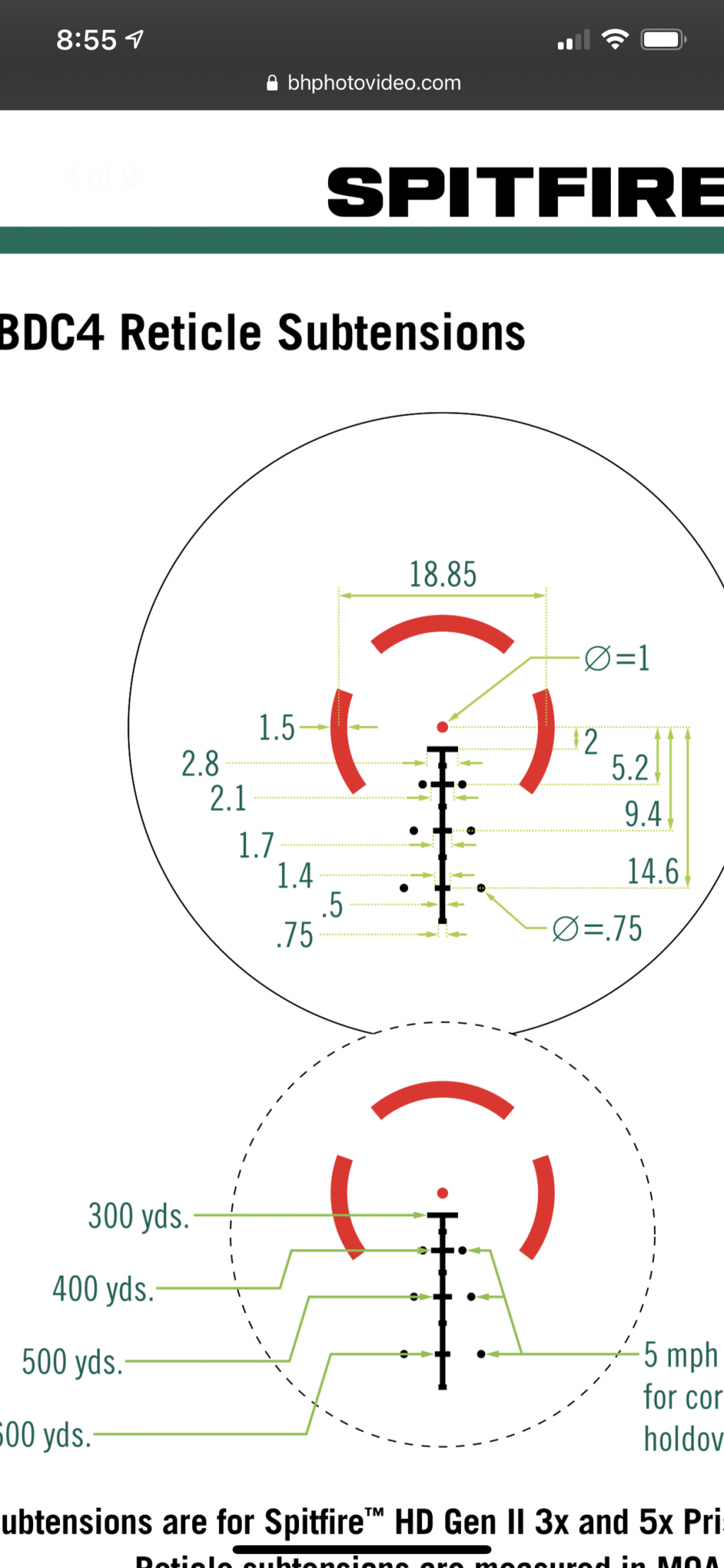

Here is the drop table for hades @700fps with 5mph wind at 90 degrees so near zero is 20 yards and far zero is 30 yards. For the short barrel 700FPS is it’s sweet spot and plenty to kill squirrels with a headshot or even vital at 50 yards.
then map your yardage to the reticle hash marks and you are covered. Most yardage points mostly maps to a hash point so it’s really quick and easy like 60 yards is the third or 500 yard mark, 50 yards is 400 mark and 40 yards is 300 mark then everything ended 40 is center dot. Even the windage marks are pretty close!
Here is the drop table for hades @700fps so near zero is 20 yards and far zero is 30 yards. For the short barrel 700FPS is it’s sweet spot and plenty to kill squirrels with a headshot or even vital at 50 yards.
This is an incredibly useful post. Seriously, thank you!
