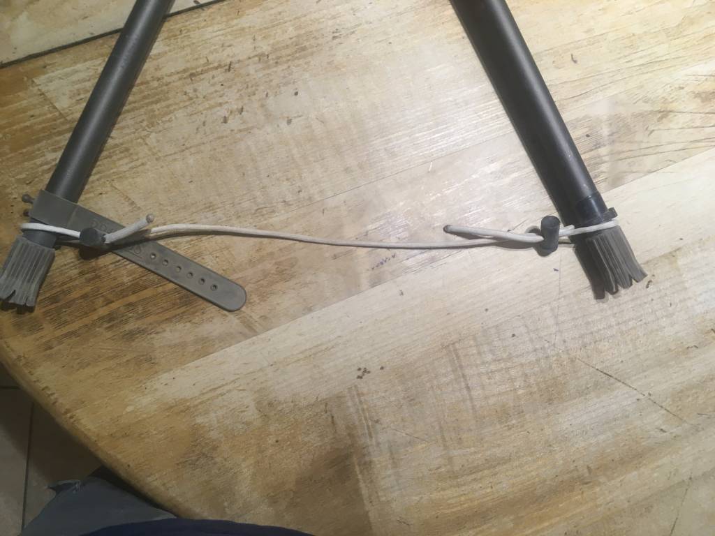

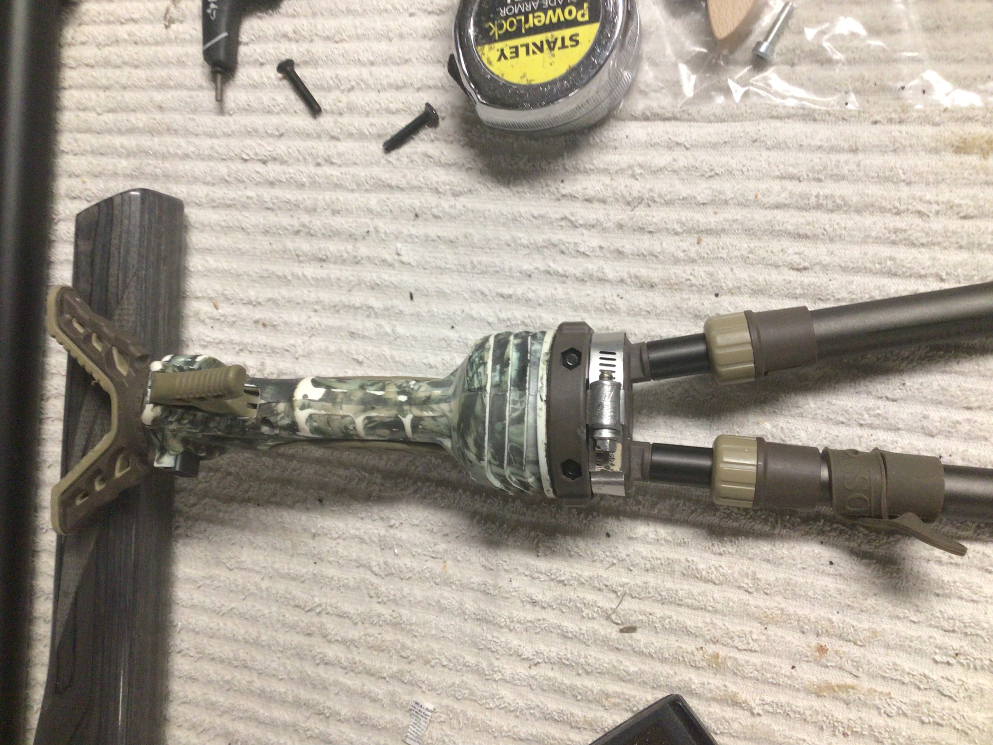

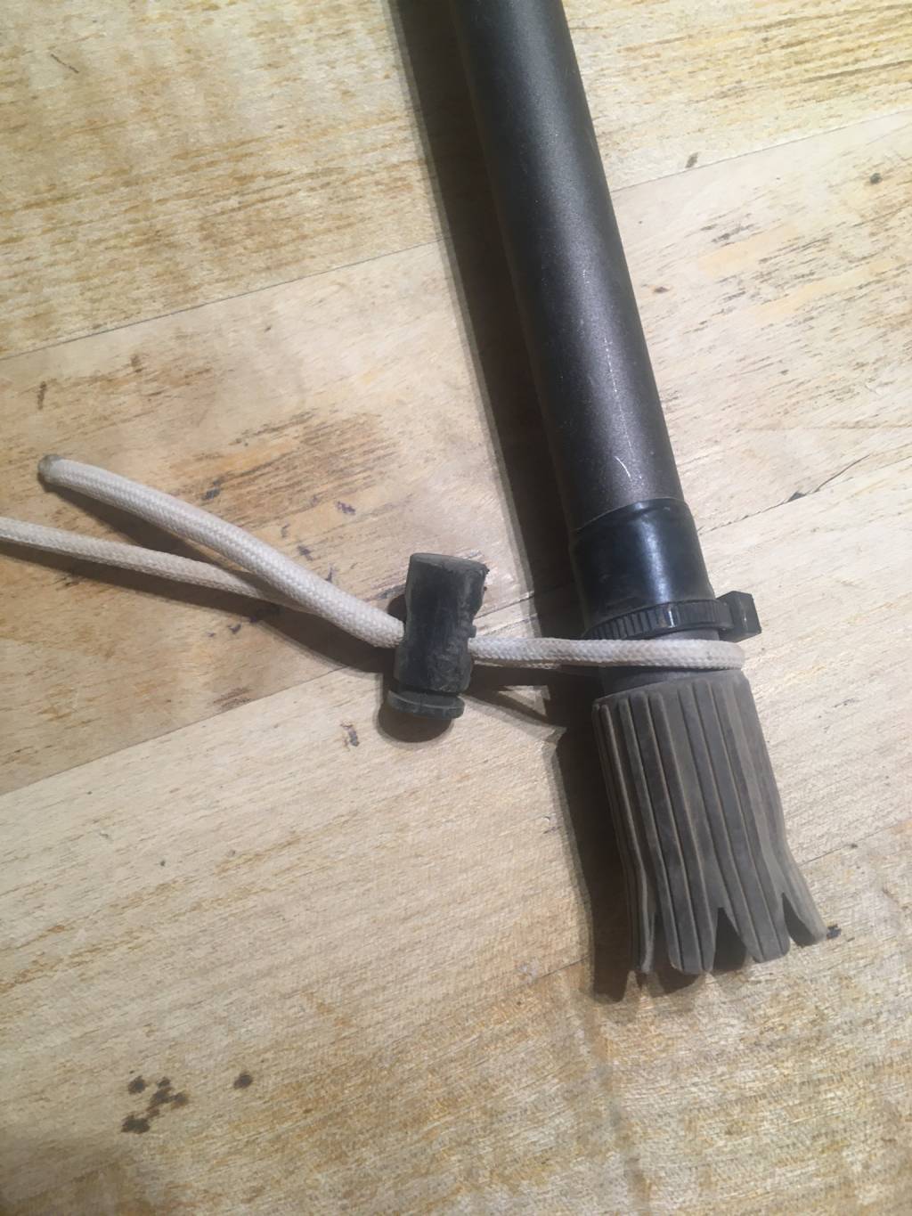

You can slightly tighten the two bolts in the head to reduce the head wobble a bit. I also tie a length of parachute cord at the bottom to limit leg separation. Sometimes I will use the cord to step on to hold the legs down while I adjust the height.

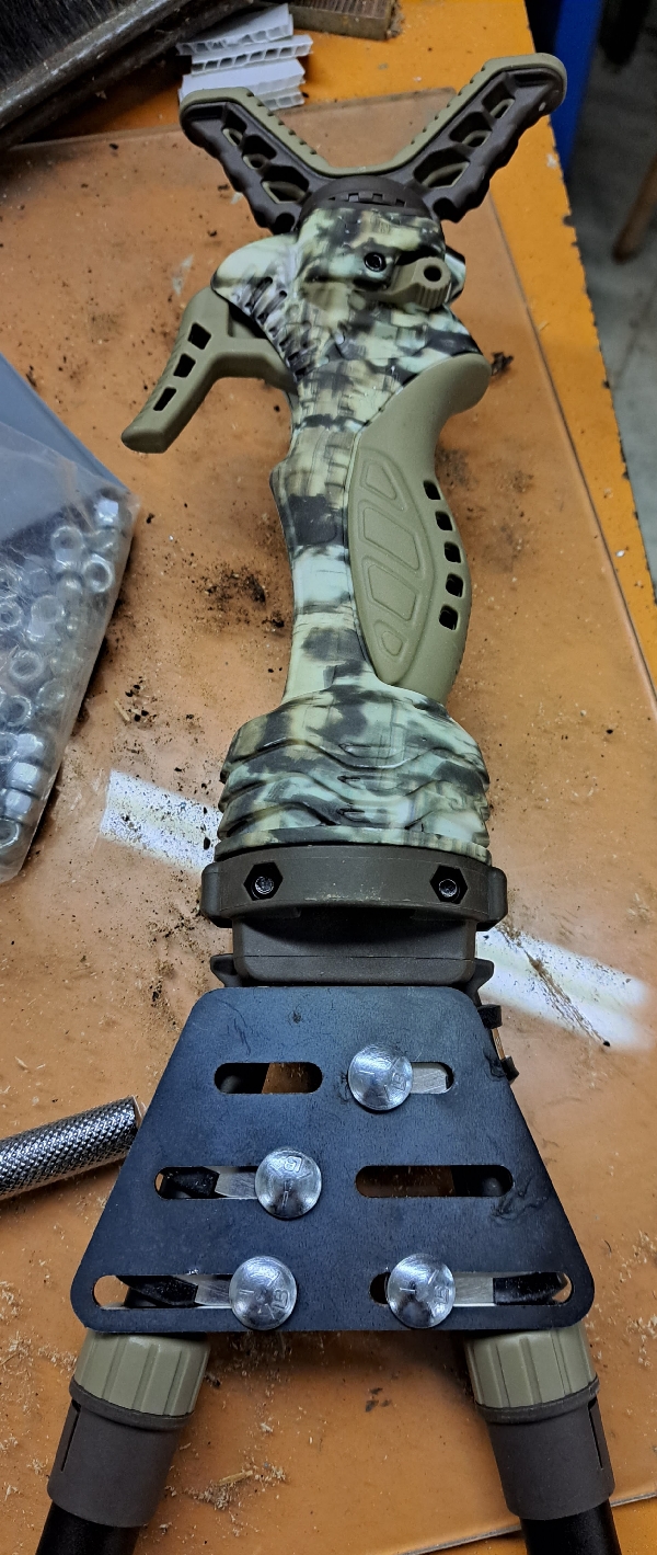

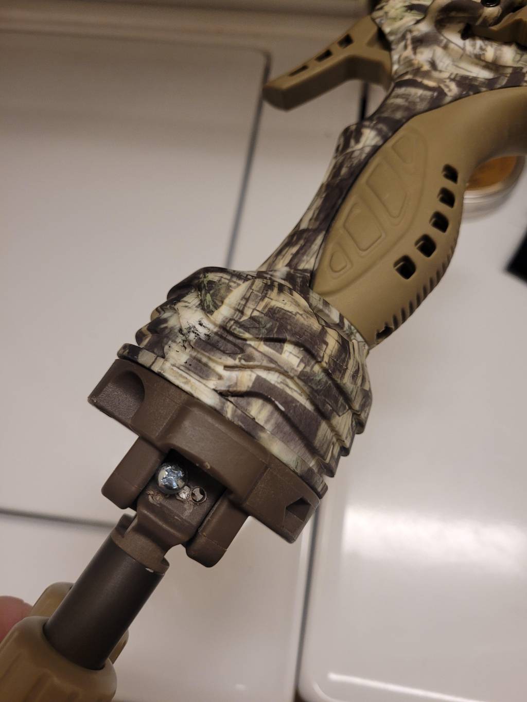

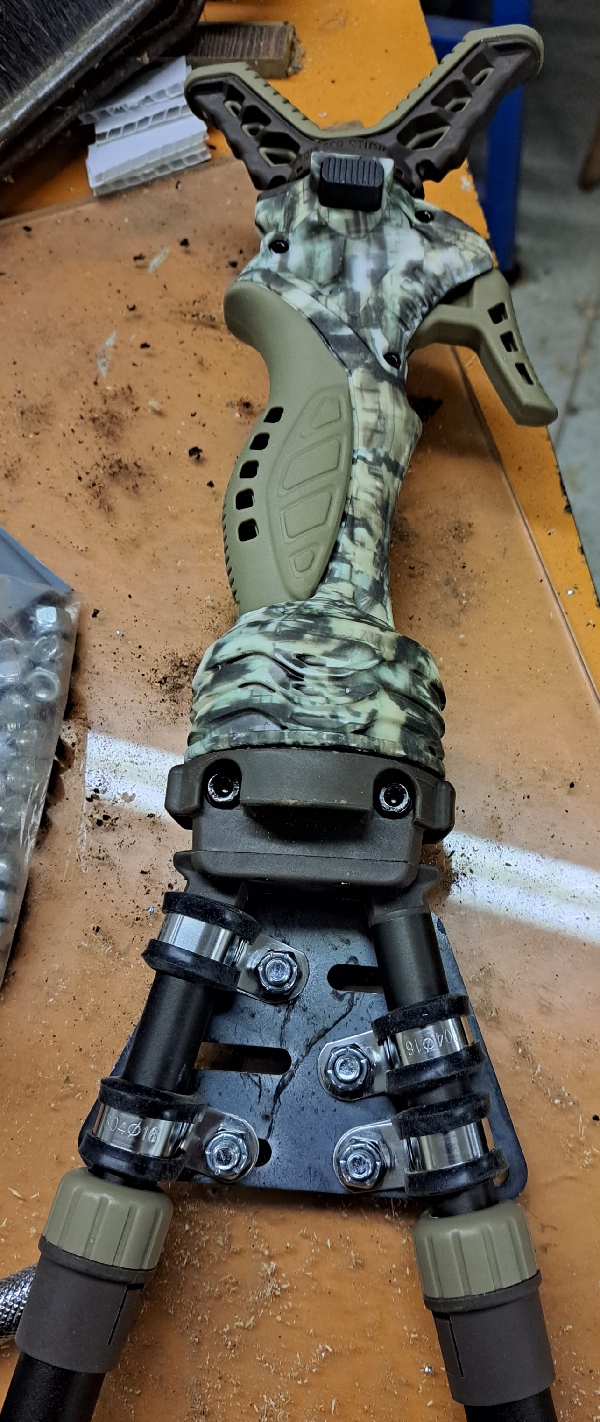

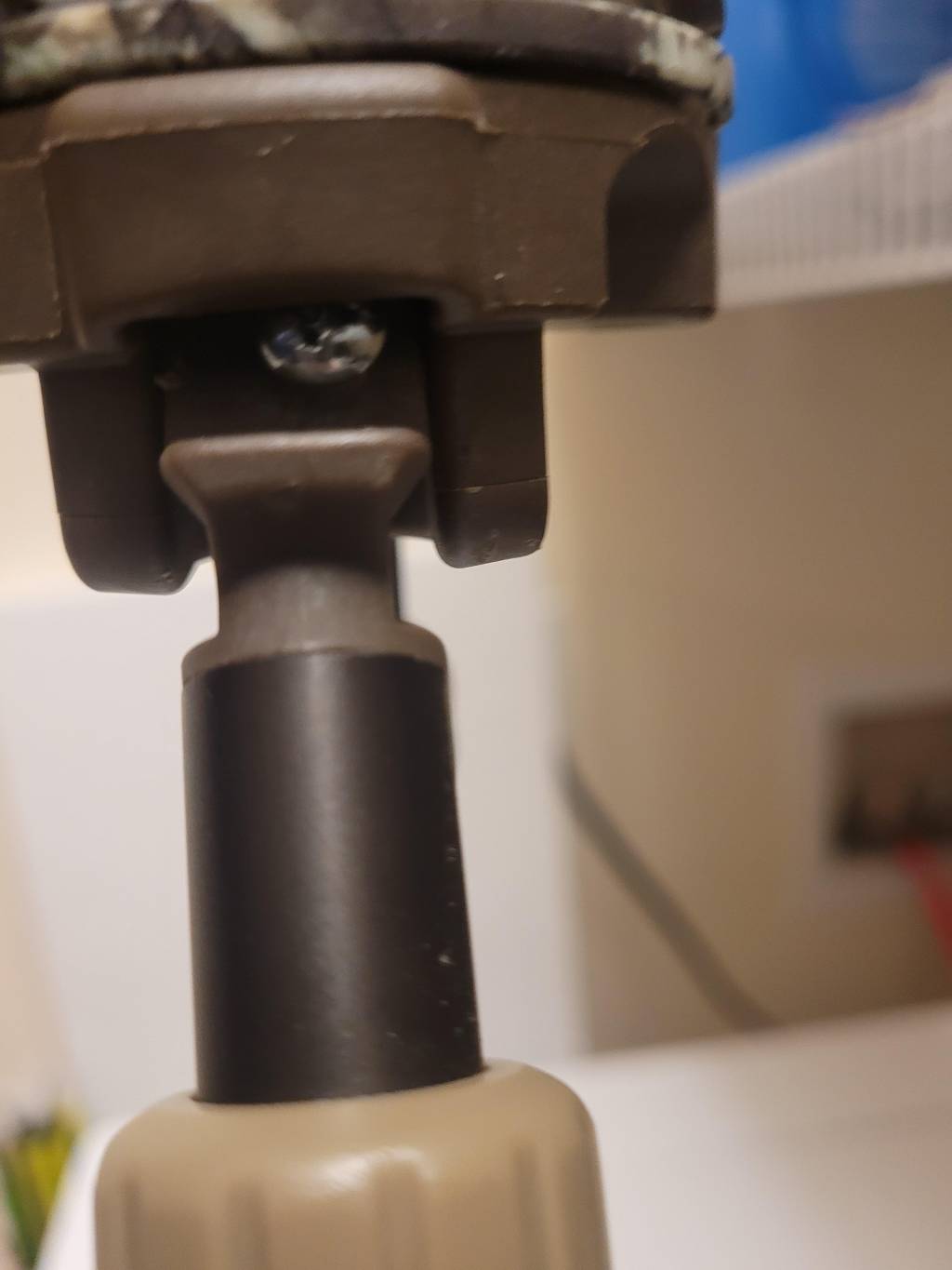

I really like mine, but like you there was just so much movement. So I tried this. You may notice that there is a drill bit broken off, there are actually 2. I do not know what is in there but it is hard. I got lucky that I did not screw up legs locking mechanism. I would consider putting something on the top to stop the legs and grip from moving.

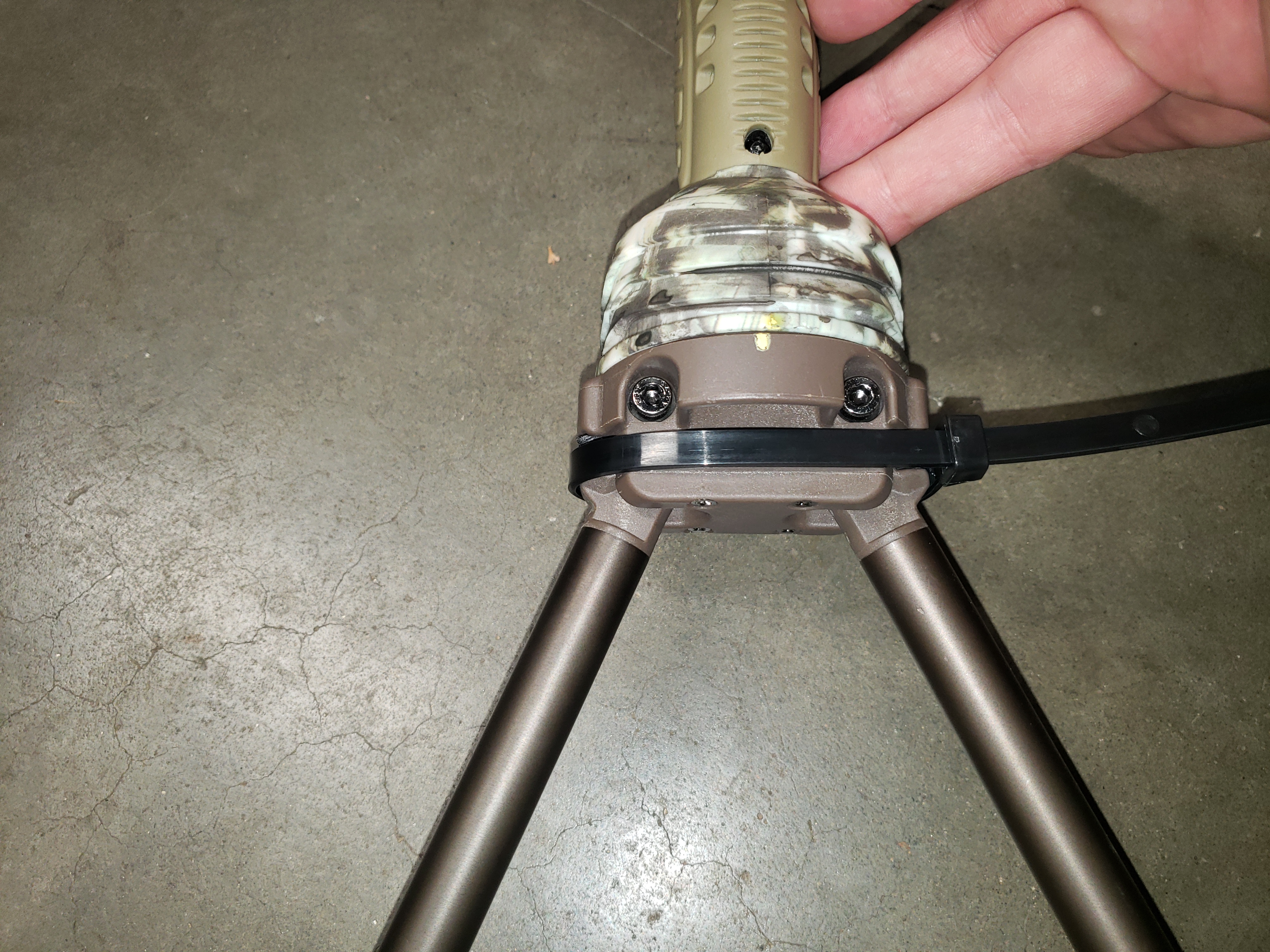

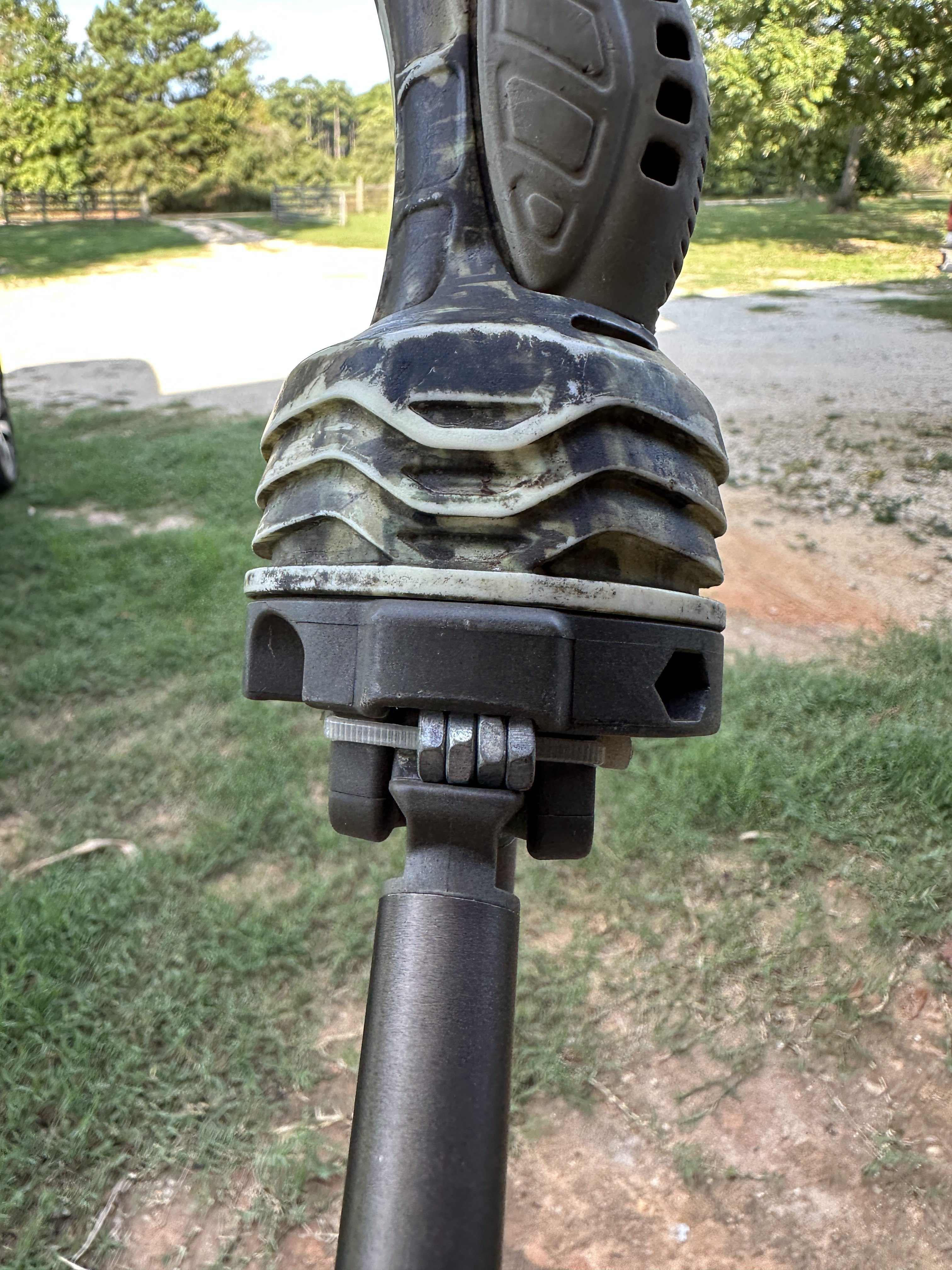

But, you can simply lash a large width zip tie around the base. I have helped 2 people with the zip tie method at matches this summer. I could not just sit there and watch them fight the floppy trigger sticks any longer. If it was a GP, I might not have said anything, but a local match, I'm all for good sportsmanship!
The picture below is with the zip tie in place, but since mine has the plastic spacers, I can't show the exact zip tie placement, but you get the idea.
