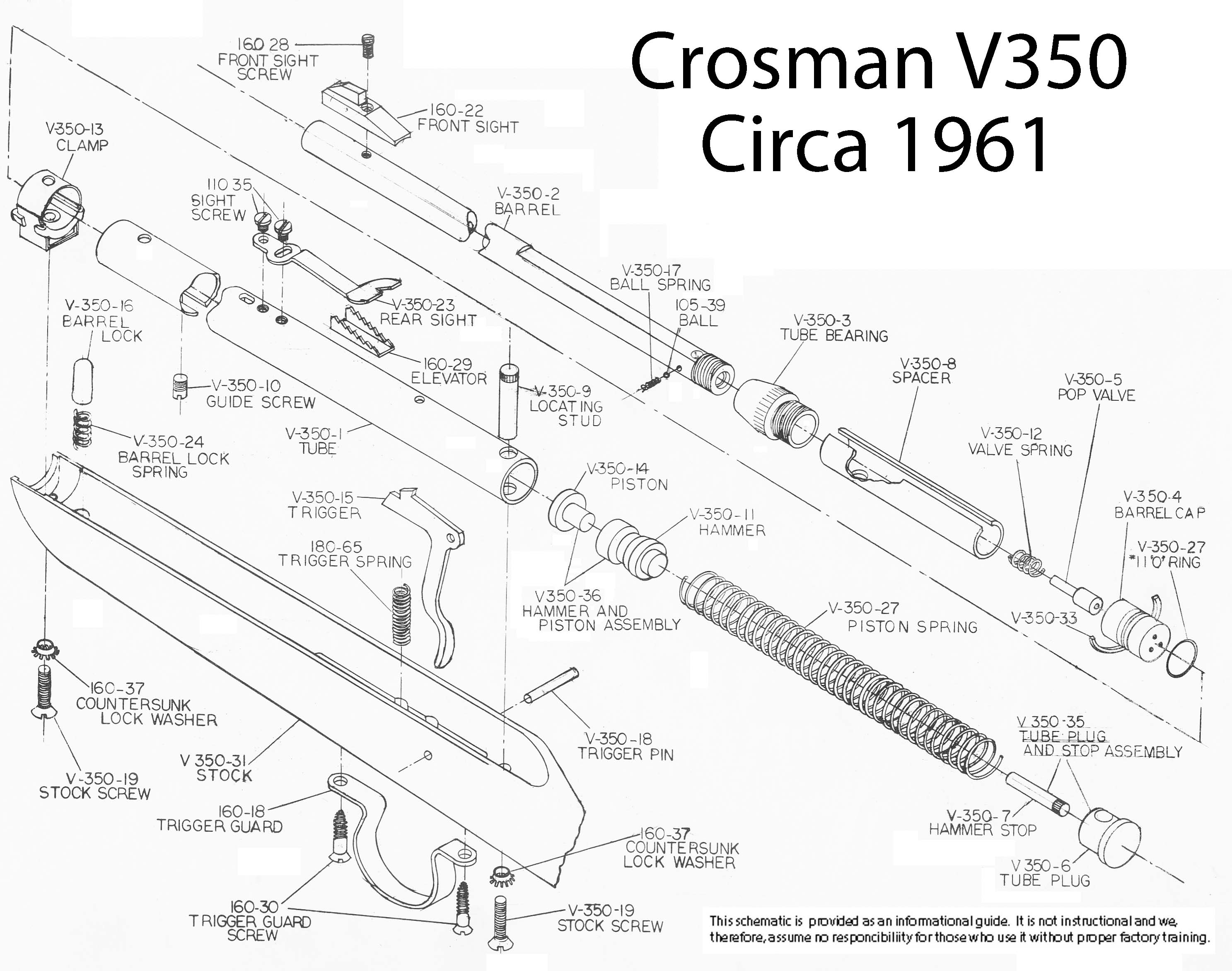

The Crosman 350V was a spring powered bb gun that used a pop valve in a similar way.
