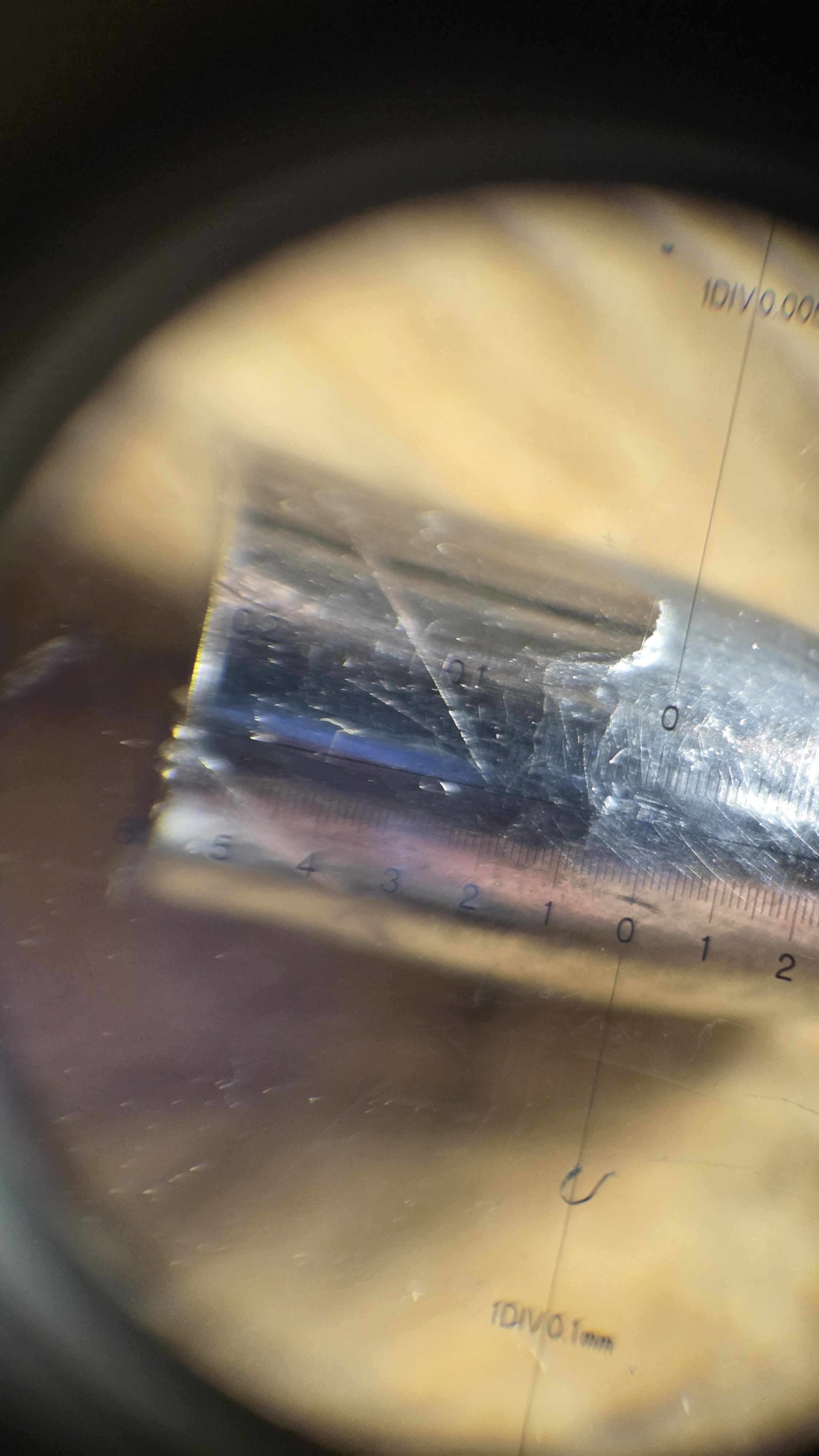

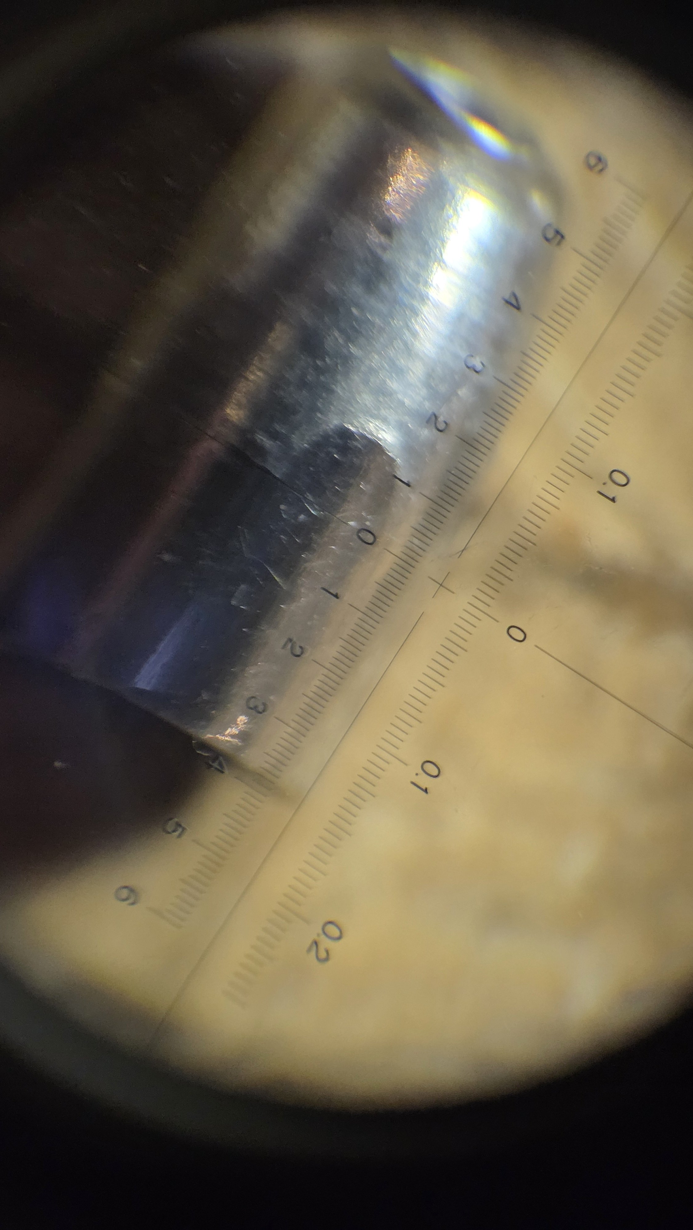

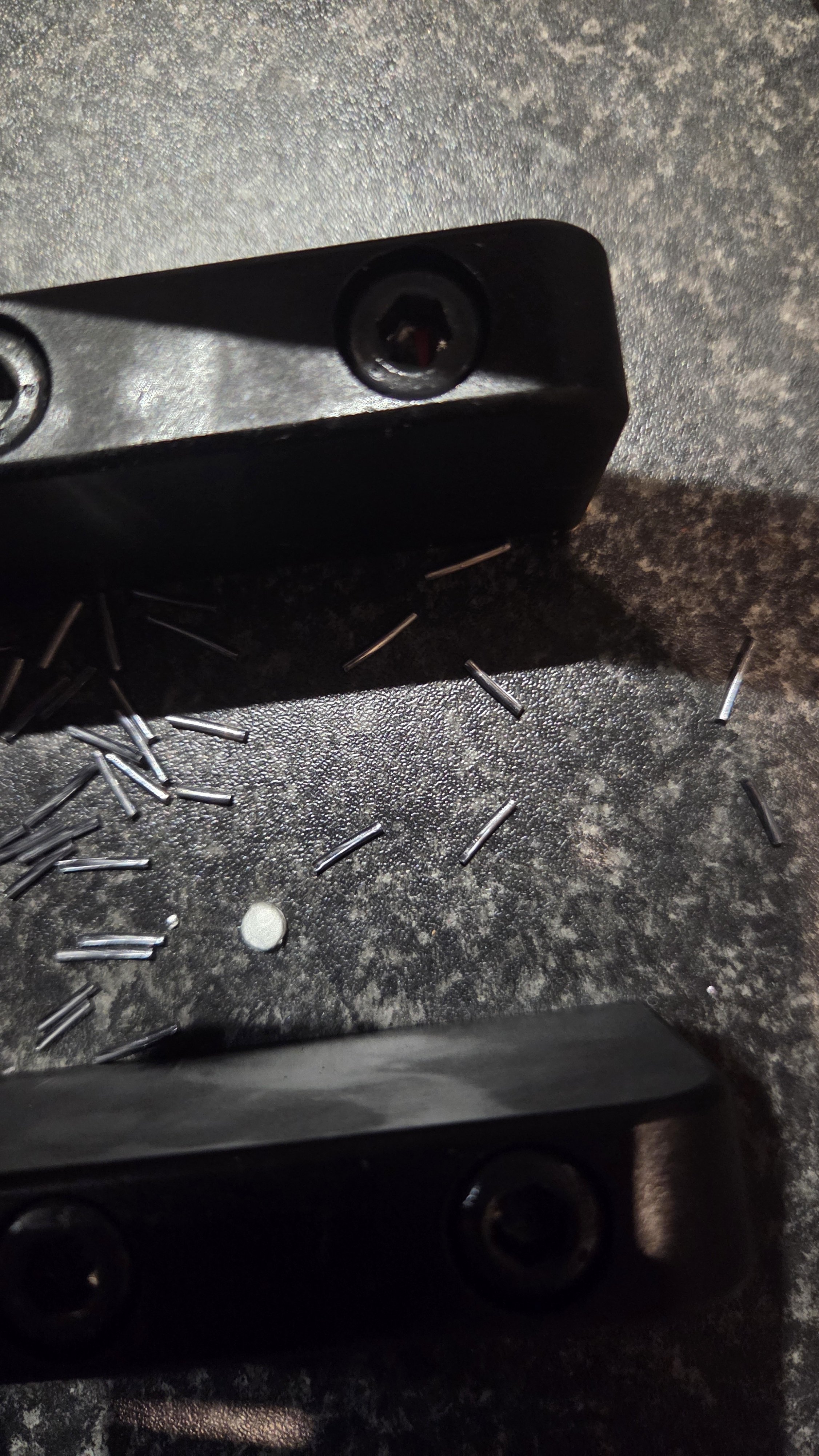

I know one of the Questions asked earlier what is the diameter of the breached bits, it's 1.45mm

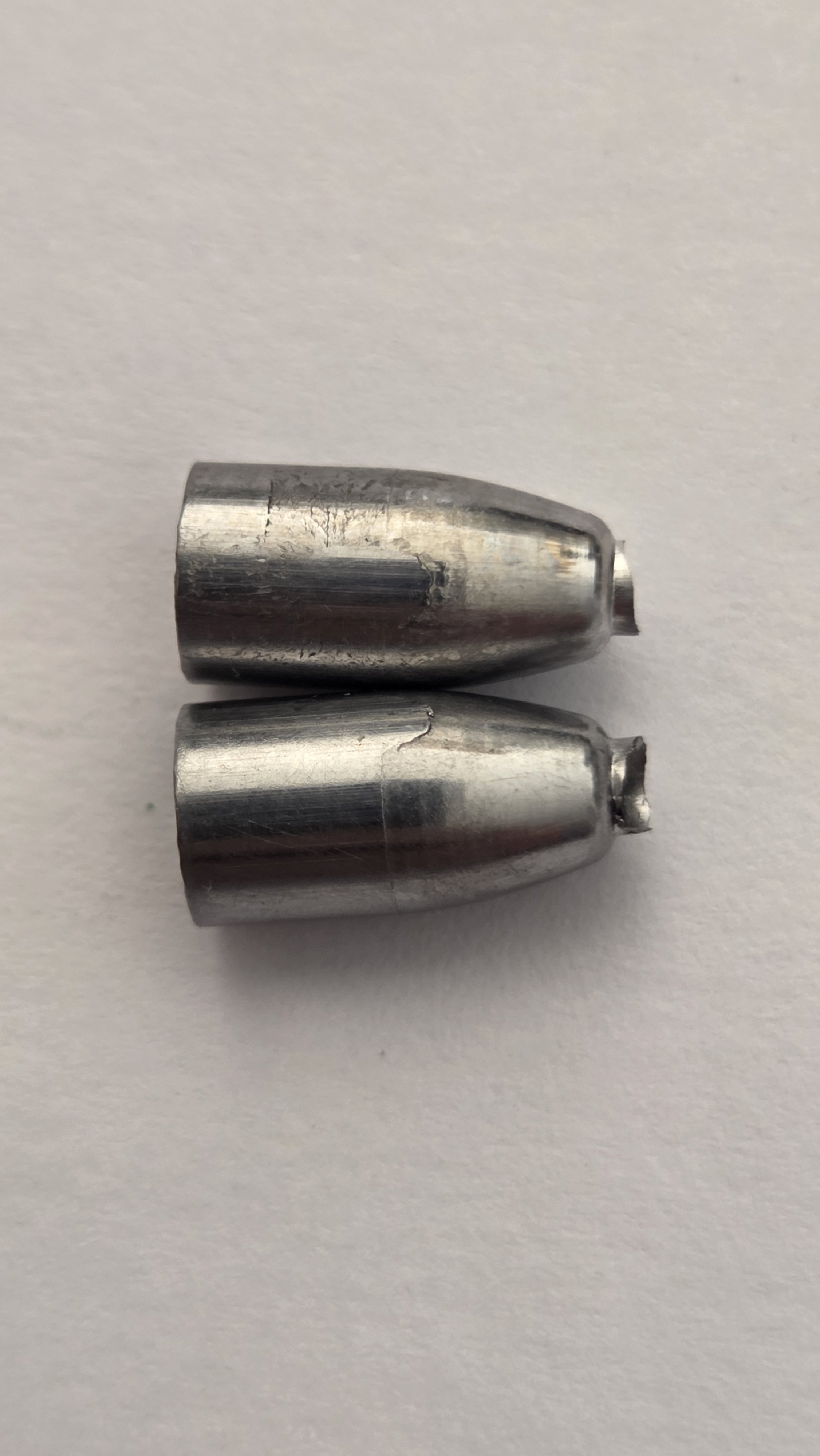

Definitely looking much better.
It’s good you can make your own dies! I have a little cnc saddle for my mini-lathe I use to make mine. Very time consuming to set up but it works for me.
I suppose the 1.45mm should be fine, I don’t have any factory swage dies to compare to. Mine are 0.040” and that seems to work fine for me.
As for the tumbled ones shooting better, it may be that the flash is gone. Just a guess though.
