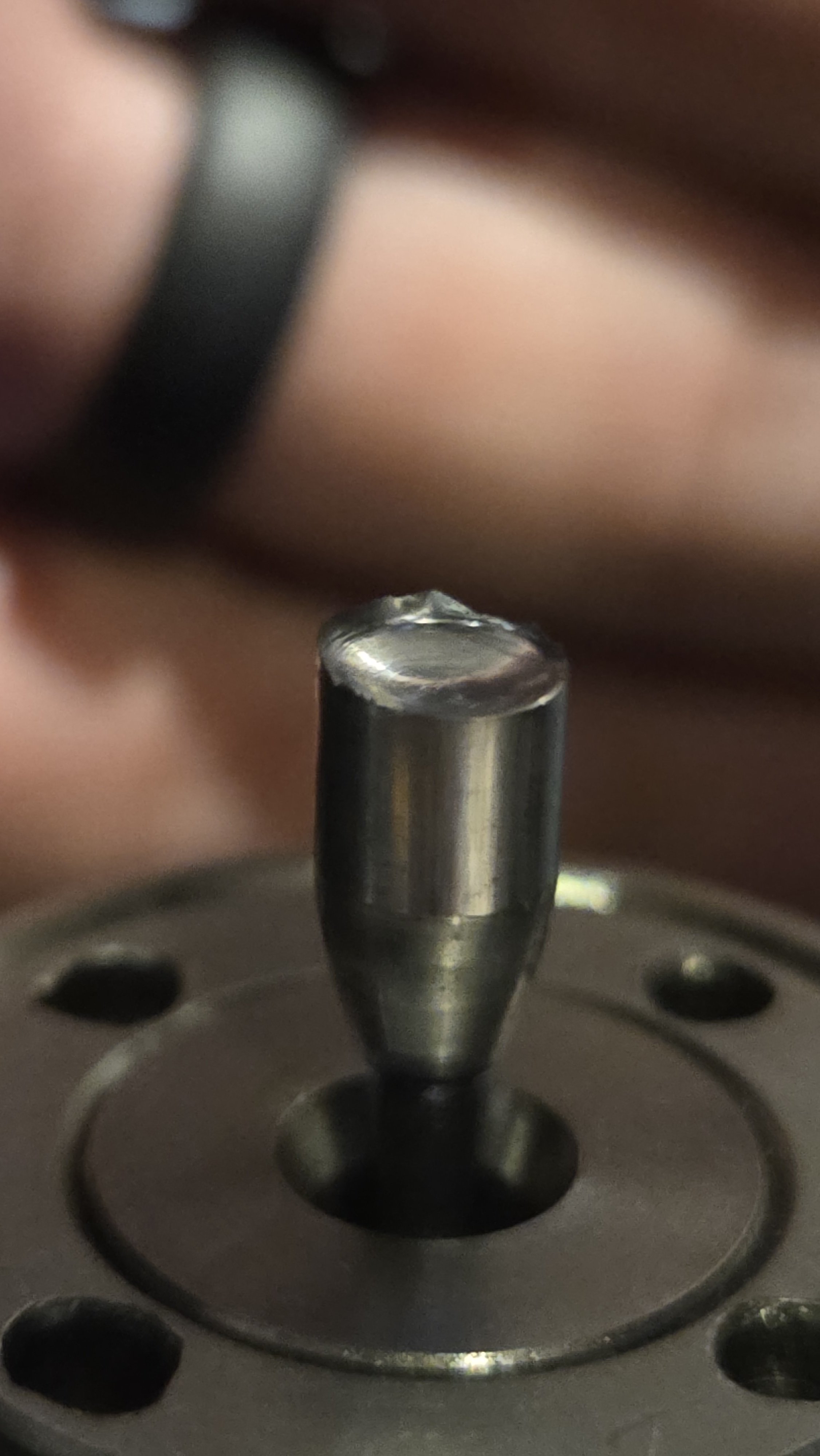

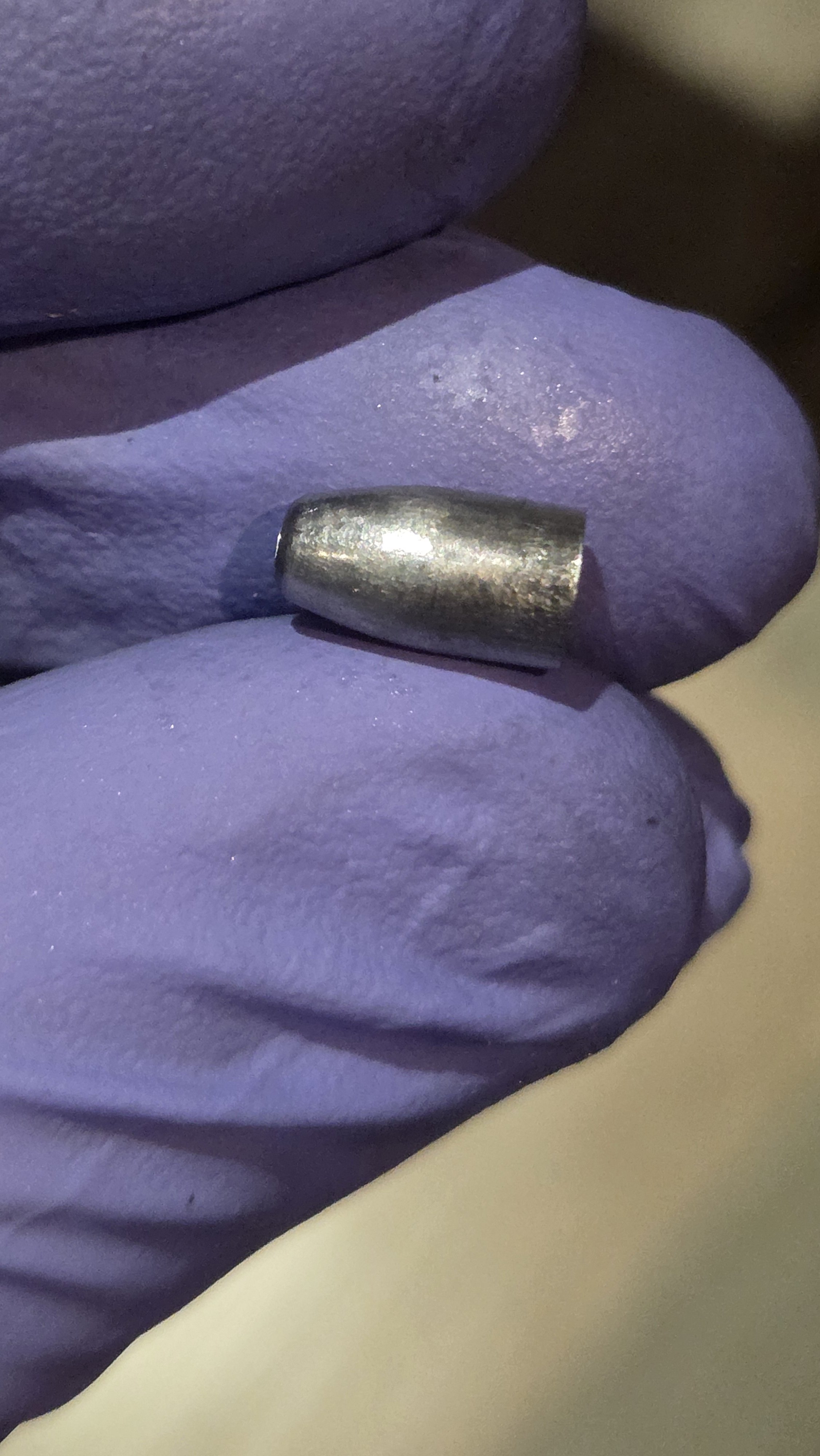

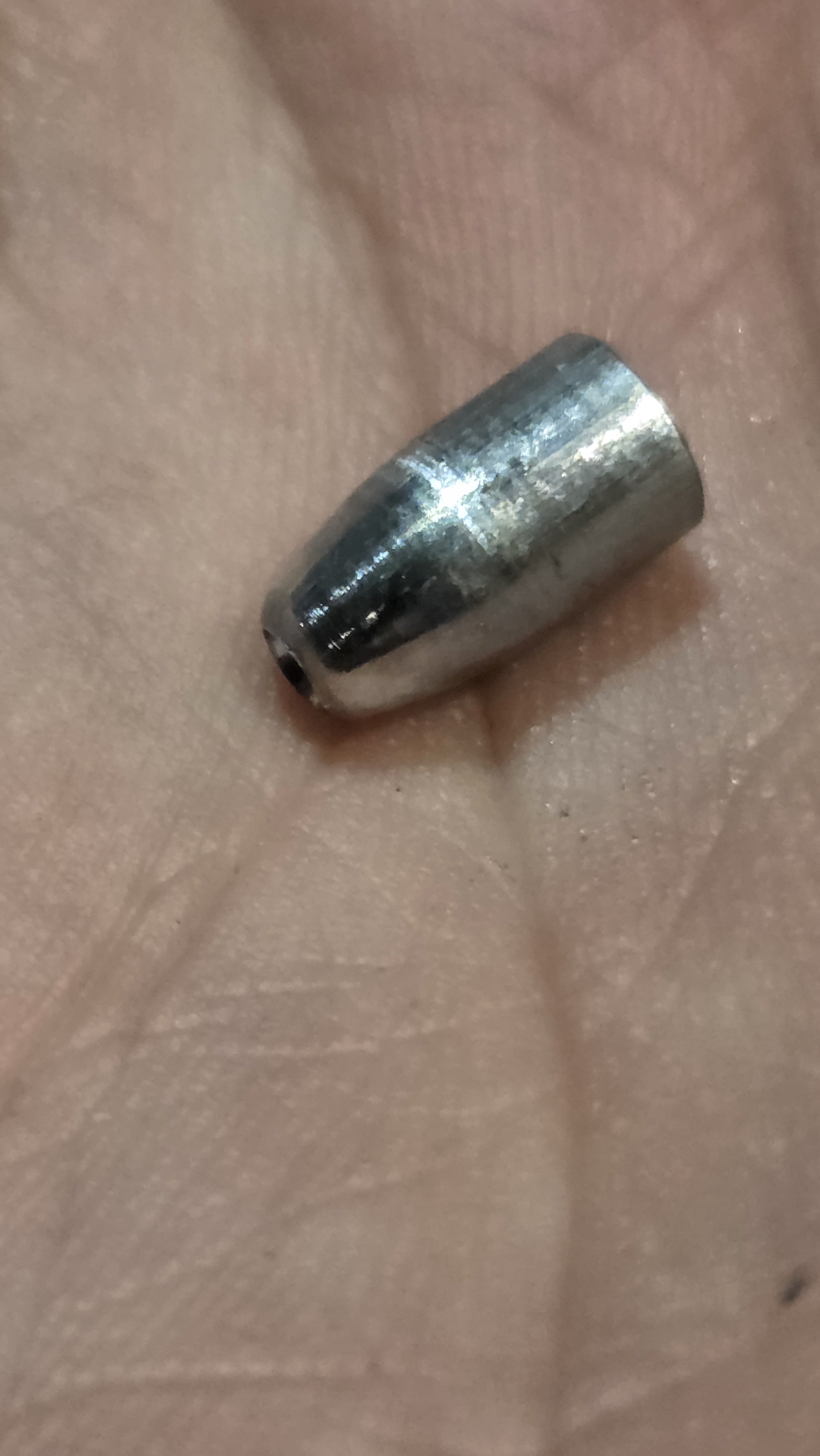

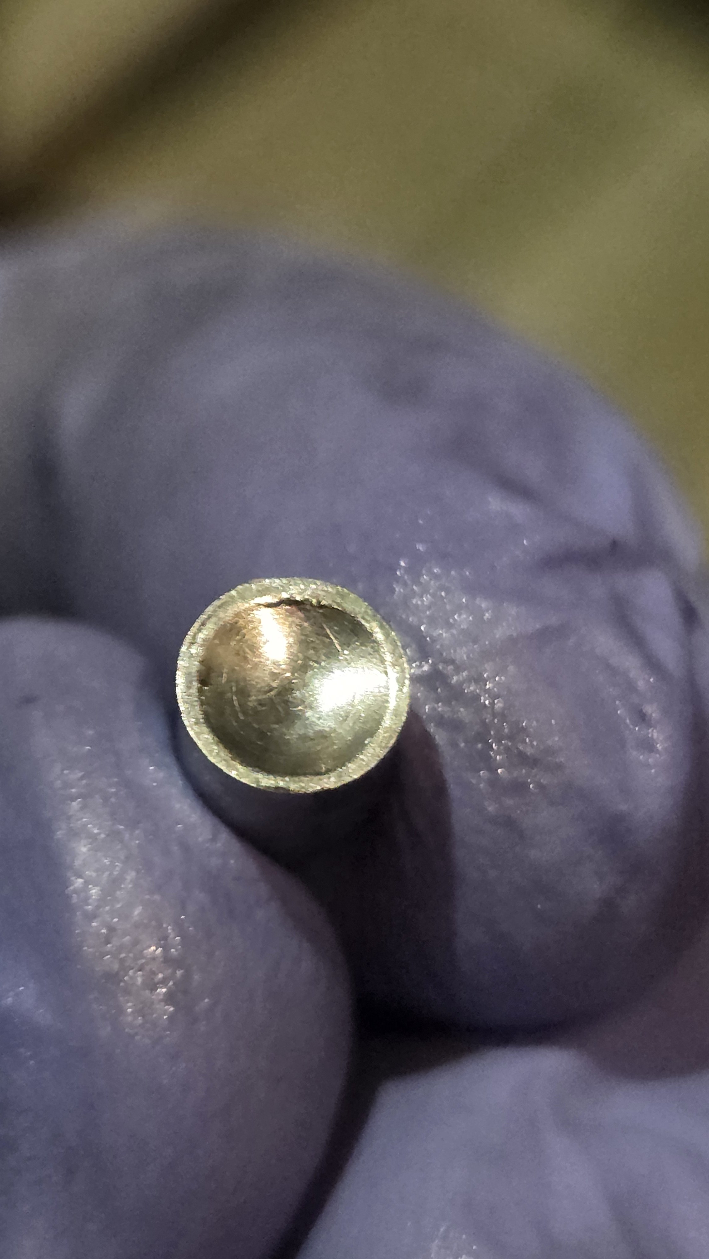

Yikes, what's your core weight and where are you getting the wire from. What cal and what size wire are you using. Using to much lube will cause pitting. For the back of the slug, getting a flashing usually means the punch is undersized, or the die is oversized. Punch to die should be just a few .0001.
Hi, my core weight is about 33 grains, and my finished projectiles are 30 grains. So, my lead squirrel is about 1/2 to 3/4 inches. I'm swaging a .217 caliber at the moment. I get my lead wire from a local source, and I was told it's pure lead. For swaging lube, I've mixed lanolin and castor oil, which is suspended in isopropyl alcohol. I then spray this onto my pre-cut cores prior to swaging. Thanks for everyone's input. I'm quite frustrated at the moment.
It sounds as though your core weight is sufficient.
Local and ‘being told’ it’s pure lead may be a little suspect. Maybe not. Definitely something you may want to verify somehow.
Bleed hole diameter has an effect on pressure created, you can measure the squirt diameter and get that information to compare with others here.
And again, wire condition (mainly discoloration due to oxidation) matters.
As for swage lube, I find that less is better. And I mean as minimum as possible.
Good luck with getting this sorted out.

So I reduced my lube which I already thought was minimal and this is the results. Only some flashing on every other slug. Not perfect but an improvement.
