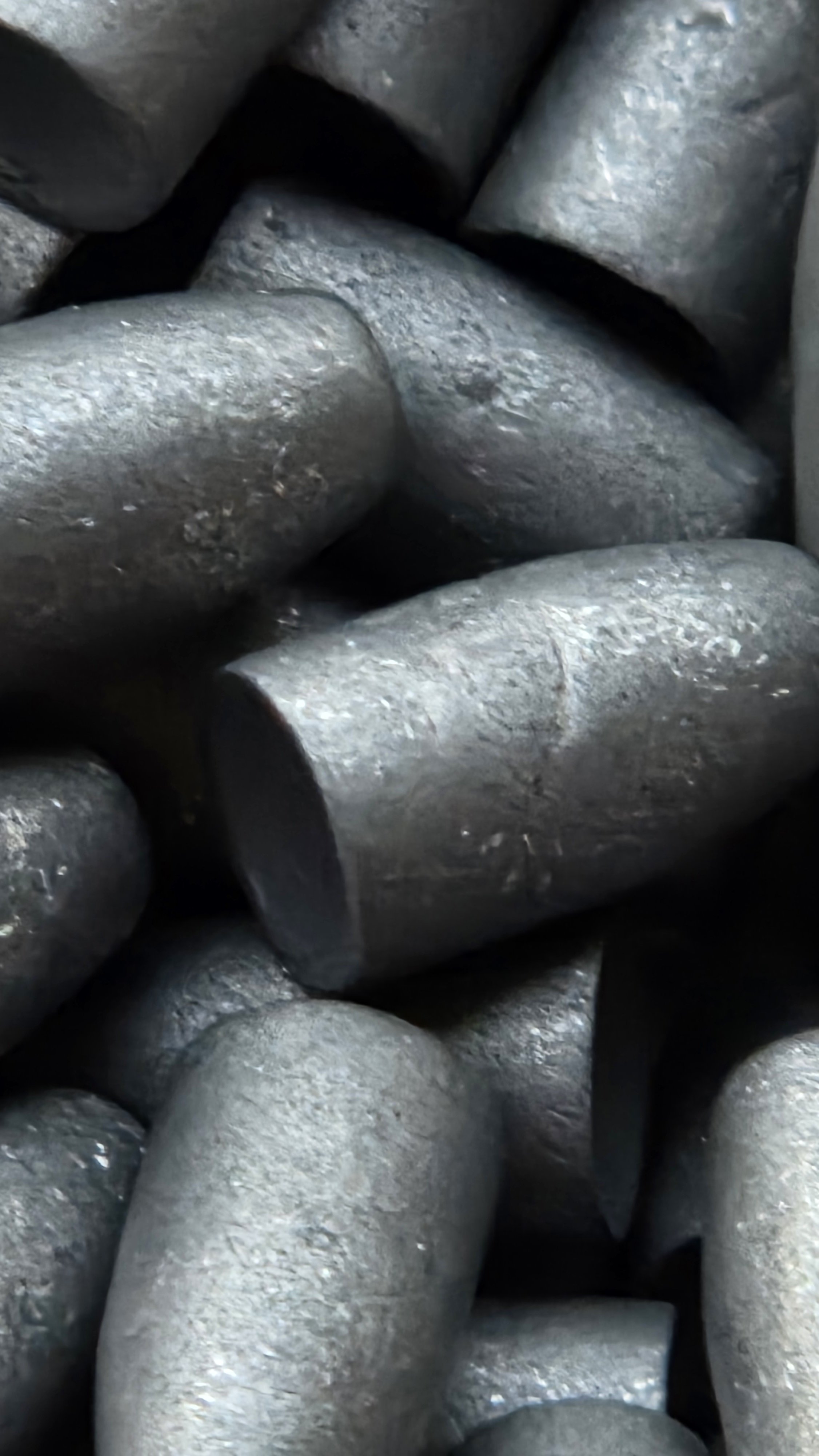

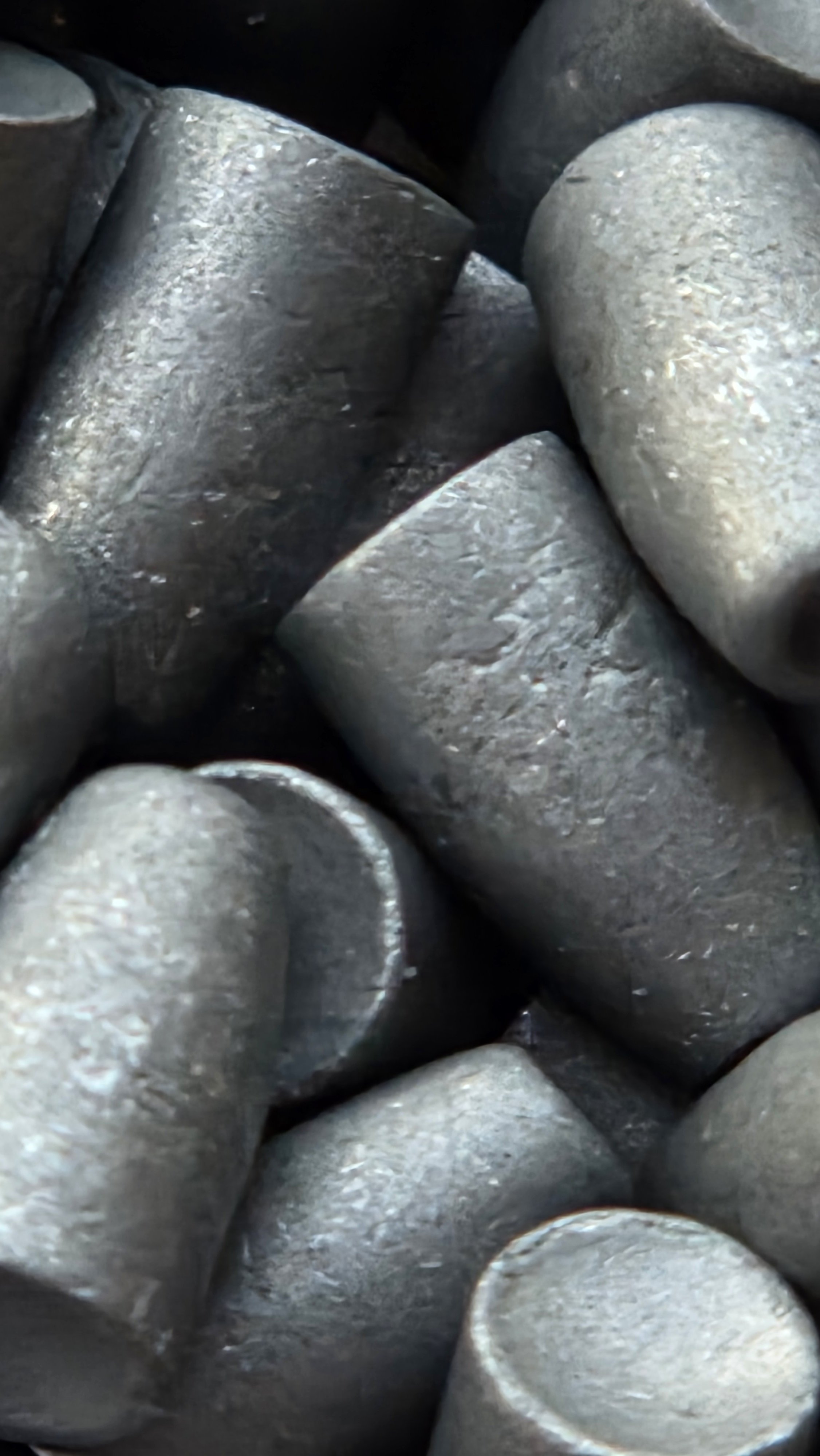

These werw my initial slugs produced

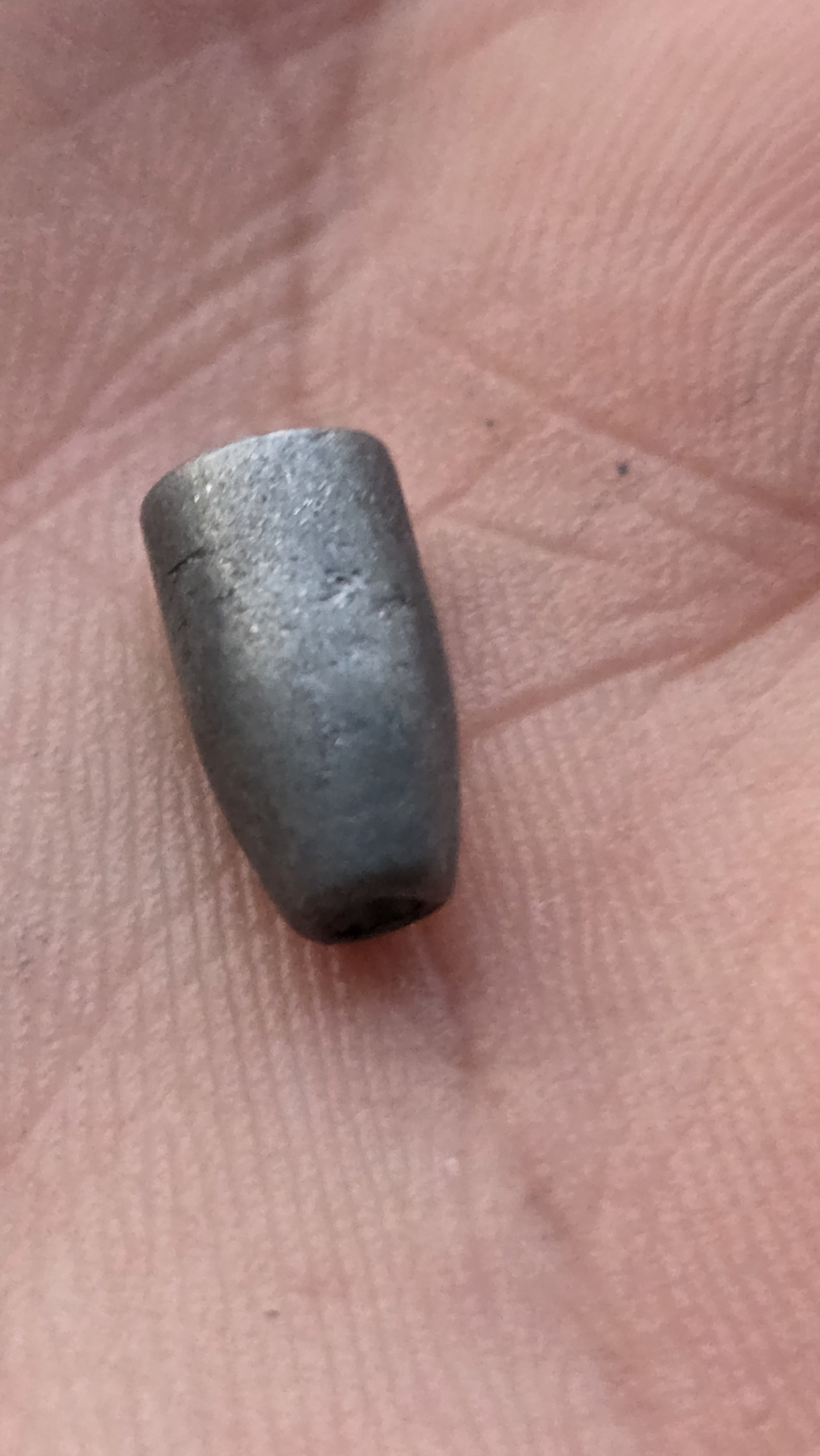

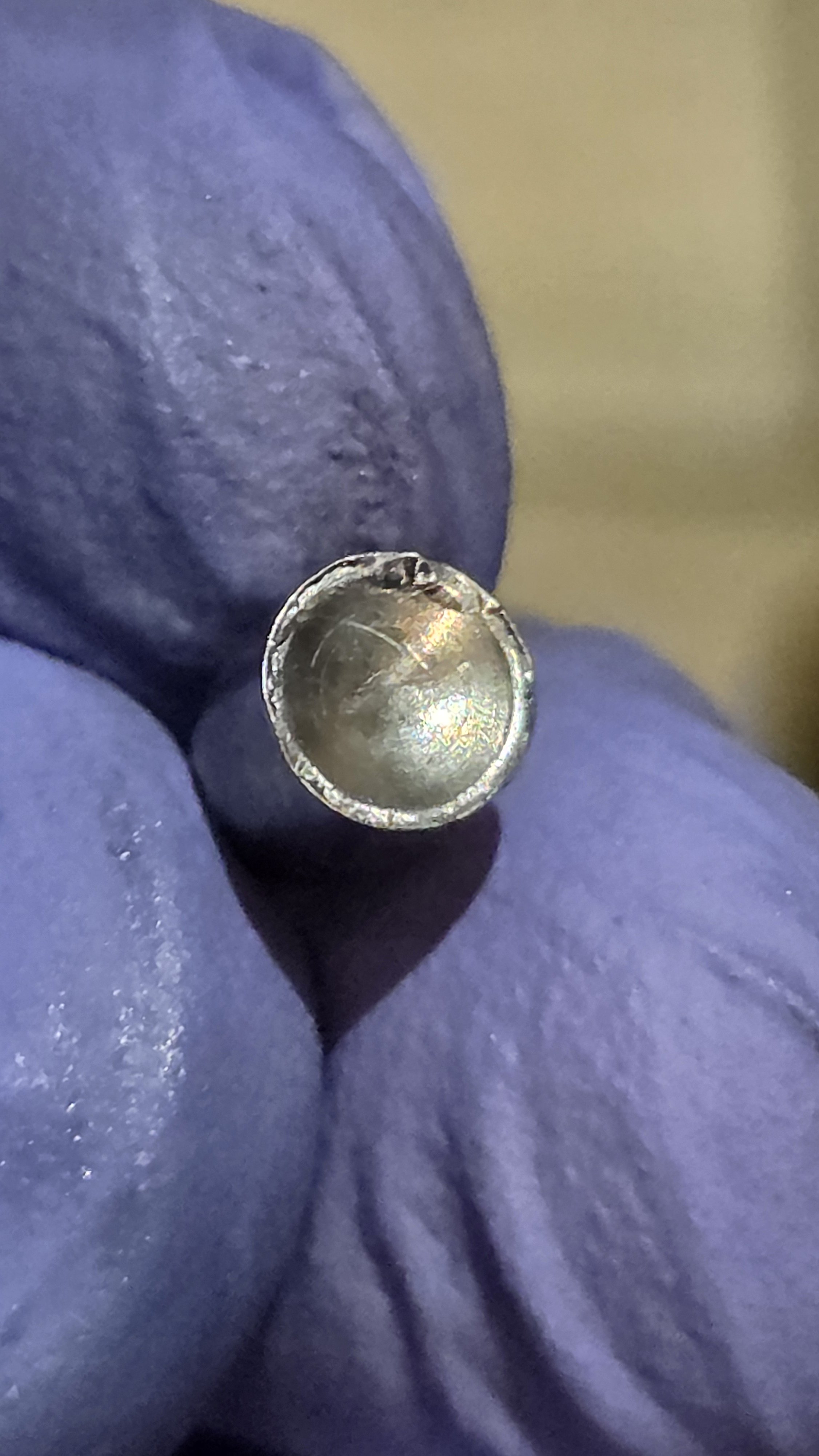

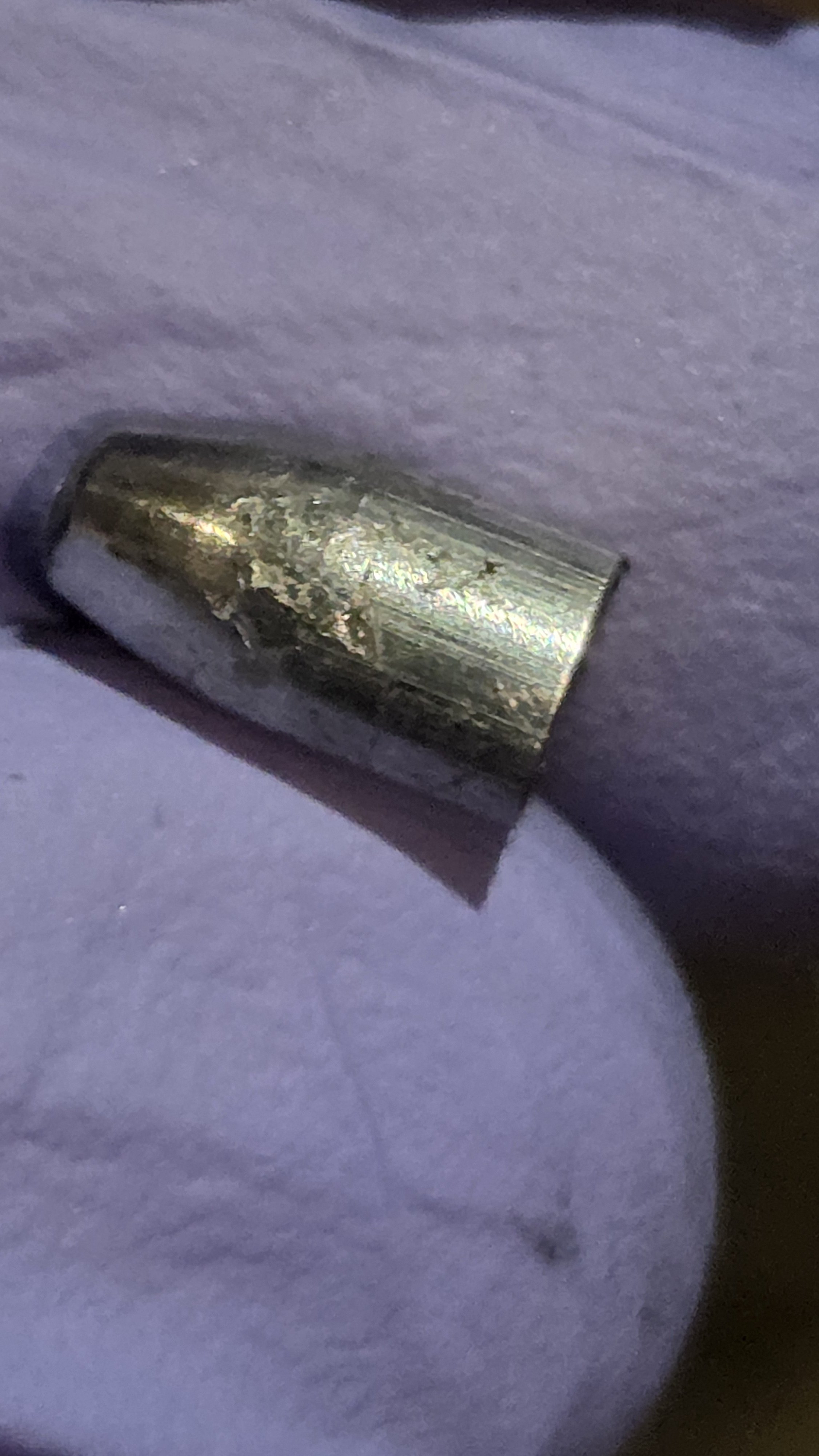

I do have issues with finish, as shown with these images, hence trying tumbling with corn cob as part of an experiment. I've polished the die but still getting these results.
Yikes if thats the finish from new press slug dies i would be contacting them for new die set. I woud guess thats unacceptable from any manufacturer. Or at least i would hope so. Also are you useing new pure lead

Yikes, what's your core weight and where are you getting the wire from. What cal and what size wire are you using. Using to much lube will cause pitting. For the back of the slug, getting a flashing usually means the punch is undersized, or the die is oversized. Punch to die should be just a few .0001.

Tumbling is ok but I wouldn’t use any media. Just the slugs in a clean tumbler. Then re-swage. This should not be necessary but if you are trying to eke out every bit of perfection, it works.
It does appear as though your cores are not heavy enough, how long is the ‘squirt’?
Also, what is the condition of your wire? Oxidation does not occur evenly and can cause voids. New clean wire is important.
