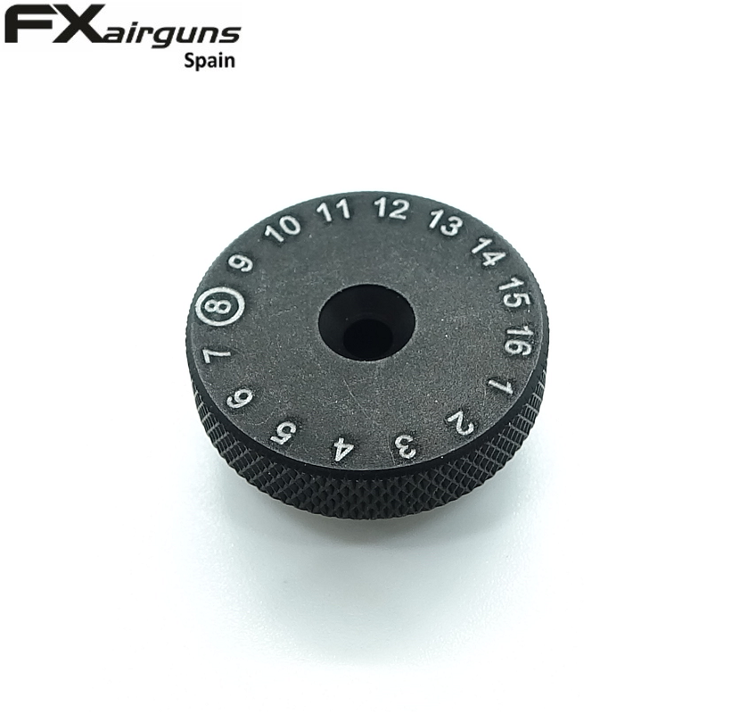

Hi
The M3 has no transfer port adjustment but you do have 16 easy hammer spring adjustments.
Regards
Enkey
