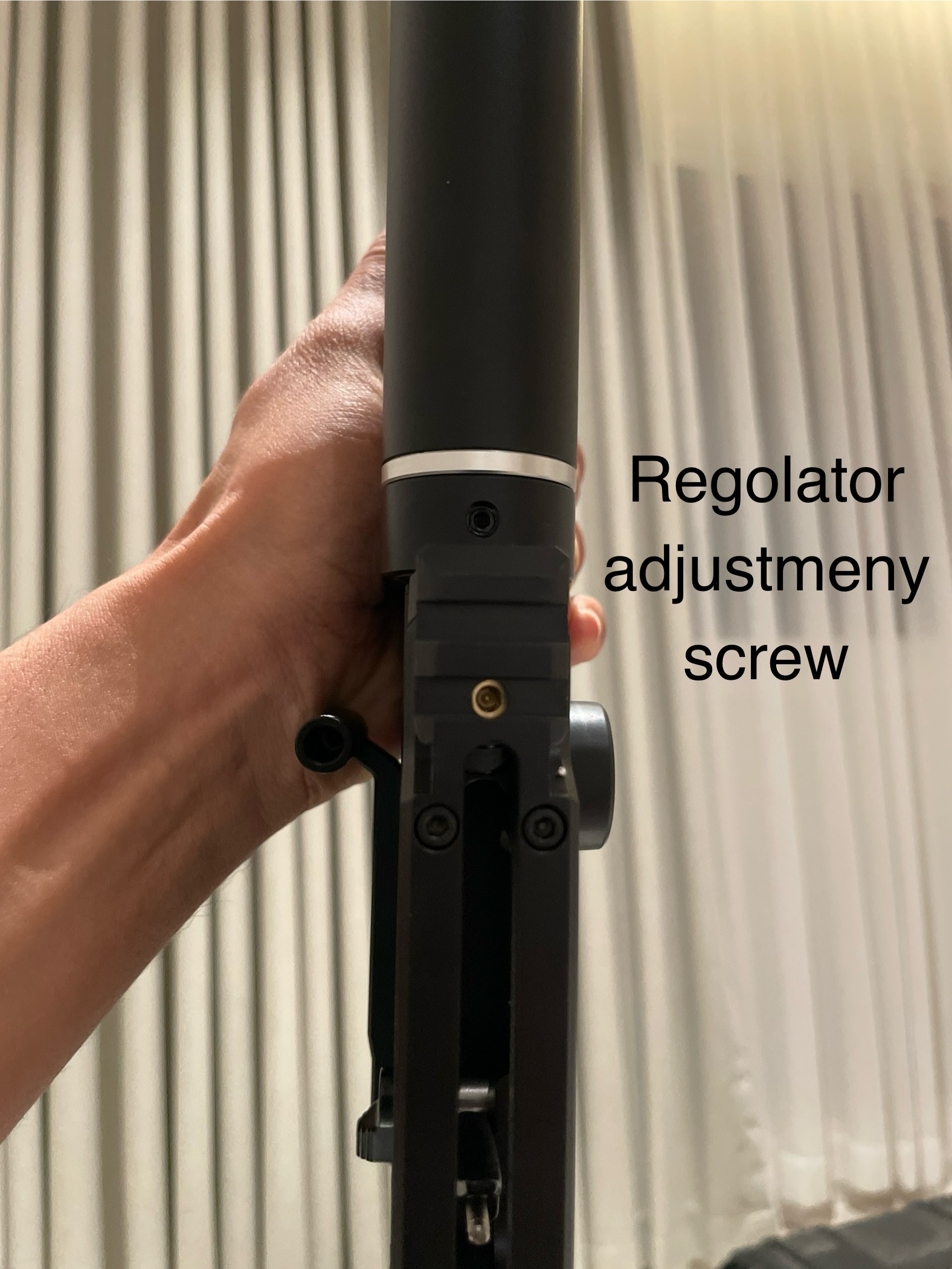

I think he means where is the external screw/nut we will use to adjust the reg setting from factory default. It's not obvious when we look at the few pics/videos available right now.
Correct. Snowpeak only has one photo on their sight and no diagram yet.
Maybe it's in the same spot but recessed inthr collar that connects the over barrel cylinder and normal cylinder.

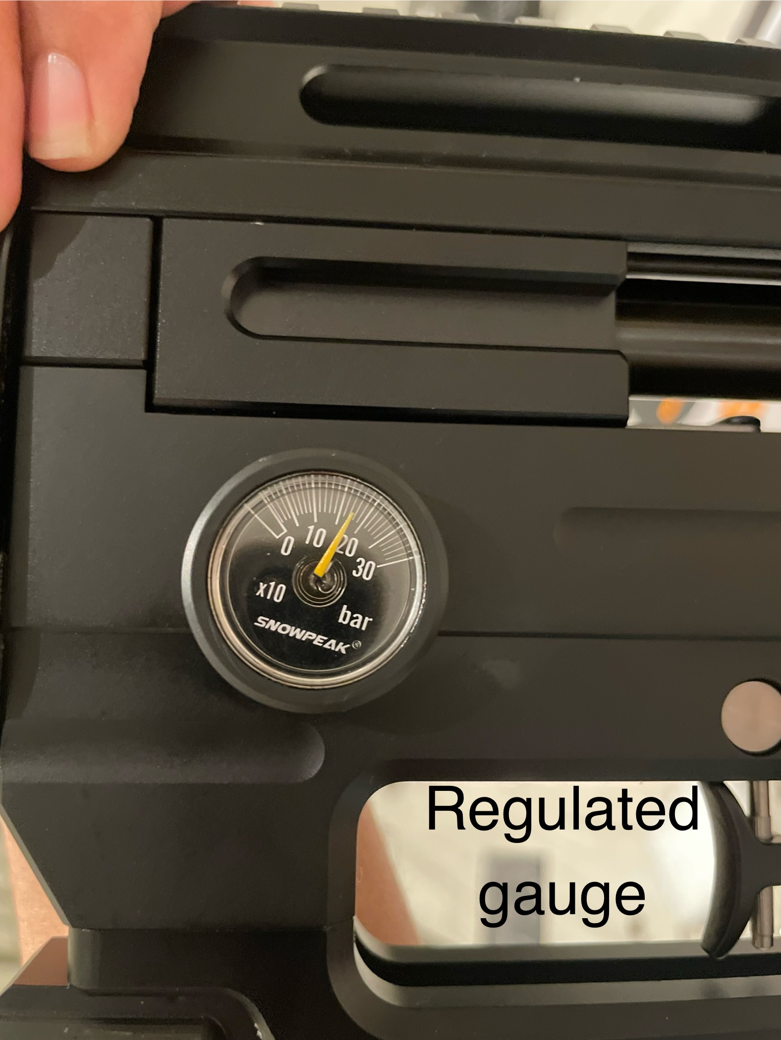

I just tested one in 22 cal out of the box its come with 3 magazine,fill probe and oring bag.
first thing I noticed when filling the gun is that the regulator gauge reading the same as the cylinder. Degassing was easy to around 50bar decrease the regulator as the manual guide the set the pressure to 160bar just for testing. At that pressure it shoot the 32.2 altaros 840fps and there is regulator creep around 10 bar after setting for 5 minutes but it’s stop there.
Cooking is smooth. Trigger is bad now but there is adjustment for will play with it later . I think it have a balance valve .there is silencer on the barrel end but it’s very noisy.
