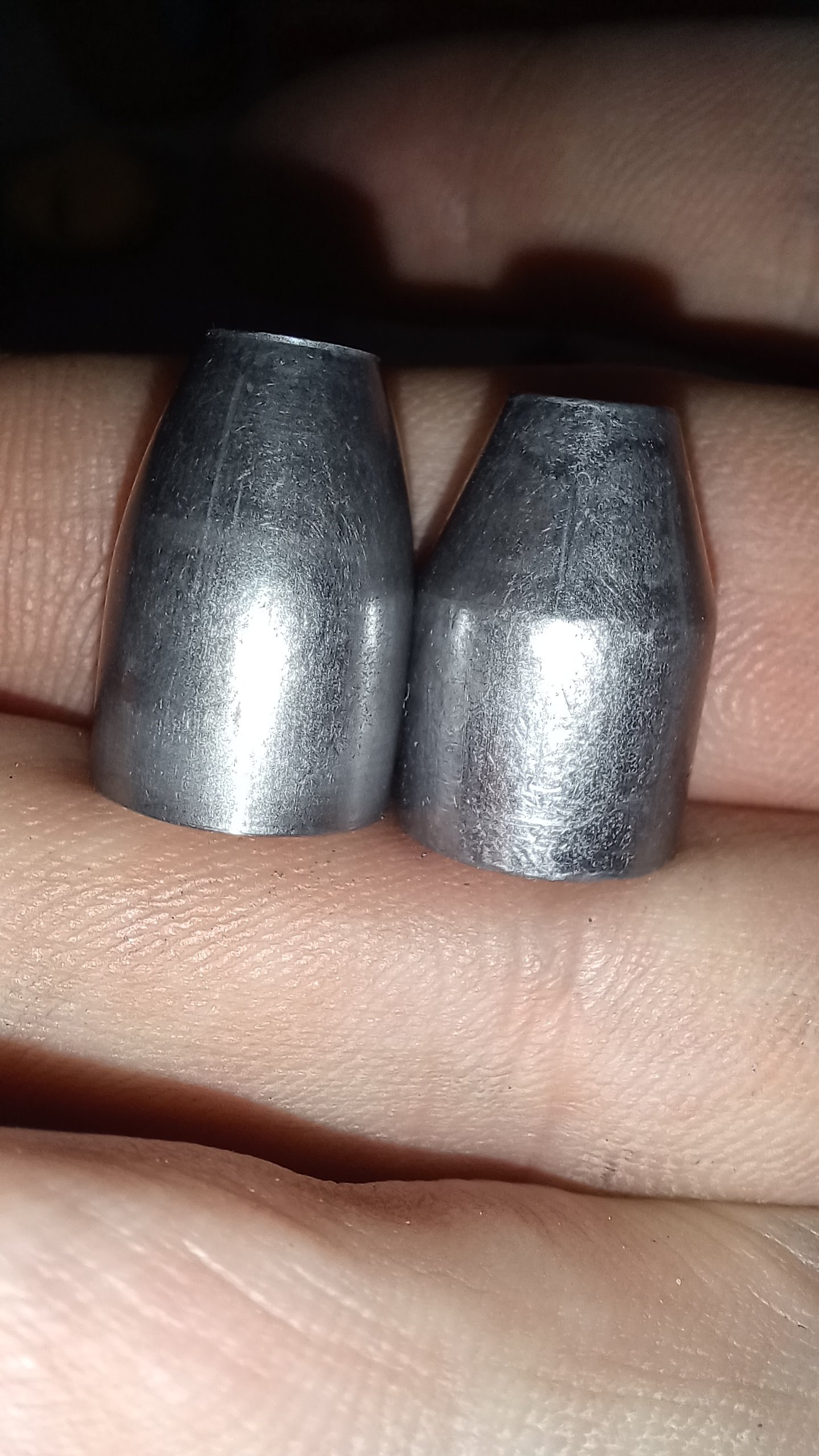

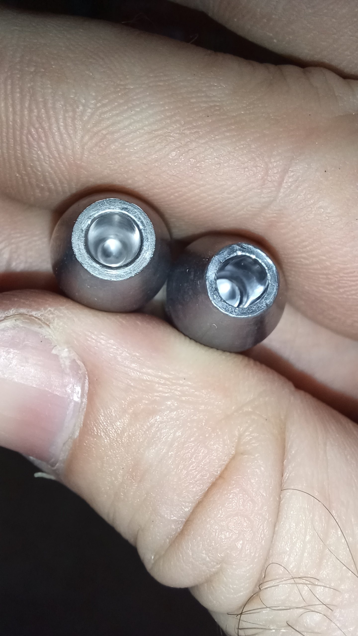

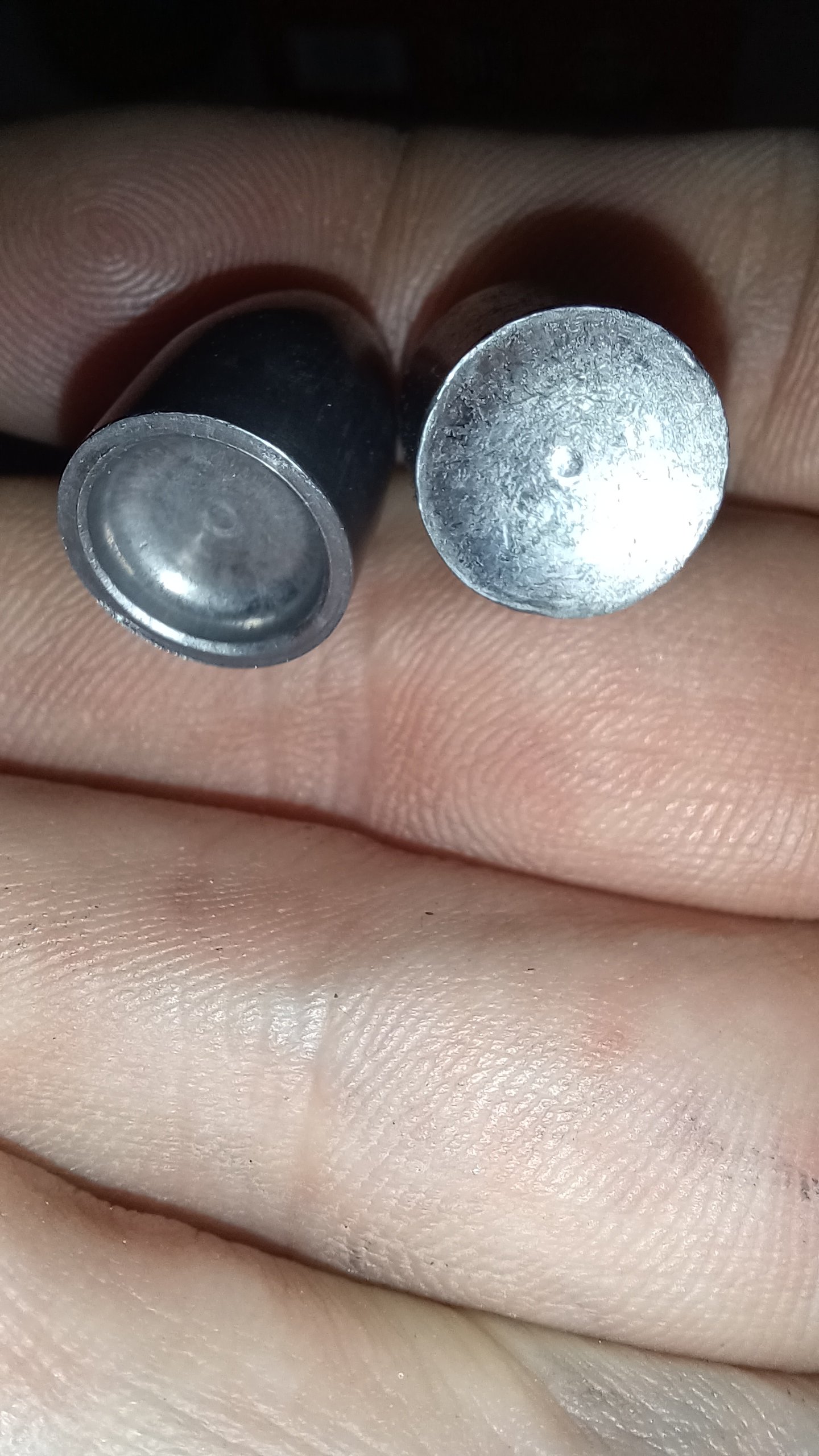

Here is a 220 grain NSA slug on the right, the slugs I made on the left. I tried not to make them too much lighter, they came out at just a hair over 217 grains

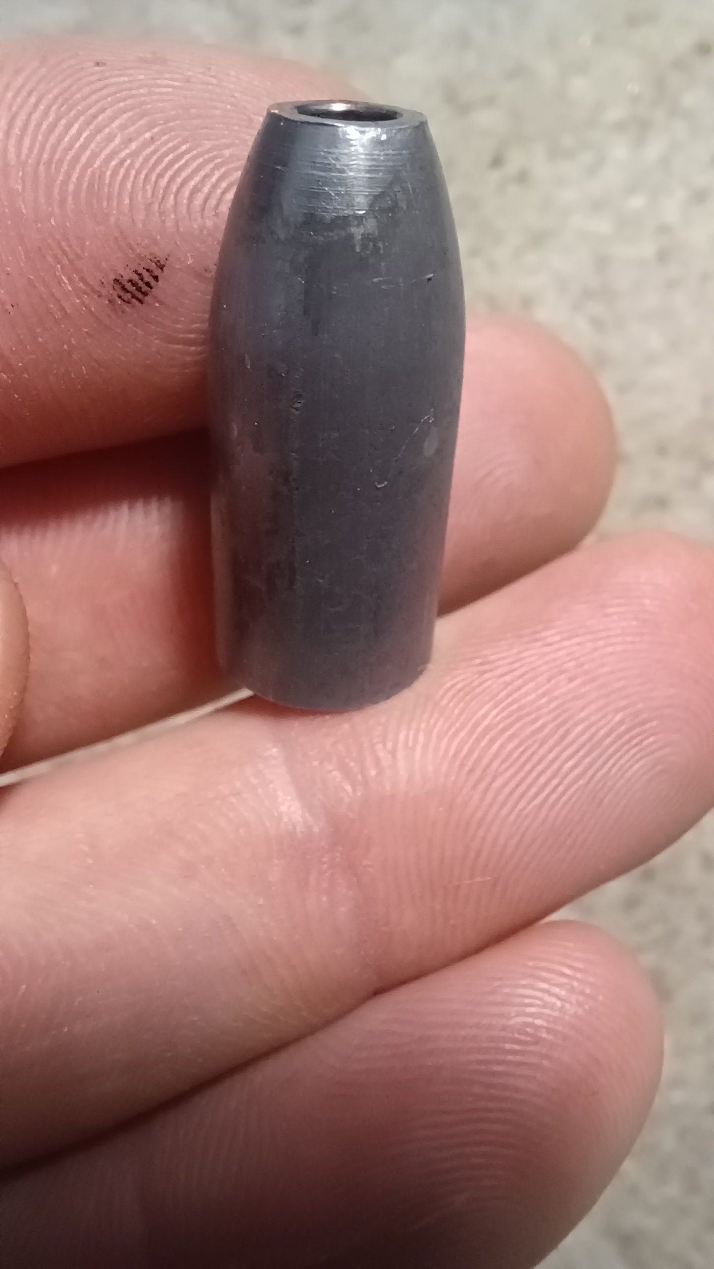

Not sure what the lower limit is on weight I can do, probably around 180 grains, will have to test. Upper limit is somewhere around 400 grains, those look like this, a sample that came with the die
