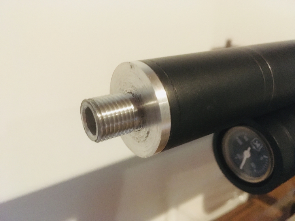

What kind of gun do you have? I did the modification on both my .22 and .25 Kalibrgun Cricket . The end of the shroud has a plug which is pressed in and époxy glued.
I turned another cap , with a VERY thight fit , ended with a 1/2 UNF thread . I pressed it in the shroud , glued with green Loctite. Works very well.
The original cap is difficult to get out , because there is little grip surface to make the cap loose. The best method is to drill 2 holes in the cap to insert a nose pliers , then you need to heat the shroud around the cap with a torch or heat gun to soften the epoxy and, at the same time , twist the cap with the pliers and pull it out.

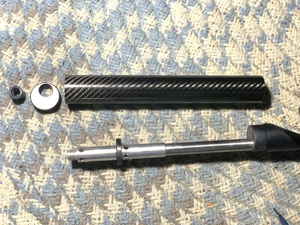

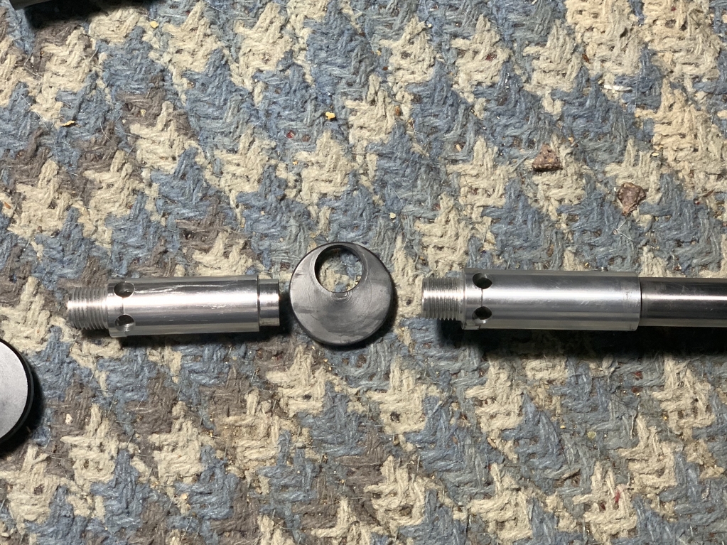

here is a pic of the modification on my .25 Cricket
Obviously the piece on the right is attached to the barrel. The Threads visible that connect to the second section are not 1/2 x 20, a bit larger. I could make a copy of what's there but without holes and true 1/2 x 20 threads.
Now if I wanted to add a small "afterburner" moderator at the end of what's already there I could copy what you have done by making a new NUT (the piece furthest to the left) only having a 1/2 x 20 extension to the nut. I worry that I could keep everything lined up since the endcap indexes off the CF tube and then the nut off a combination of the endcap and the threads. I'm not a machinist but I do have access to lathe and milling machine. I already emailed Martin at RAW about making me a custom nut but he said he was too busy. I had figured since he was tooled up to make original nut that altering it would be relatively simple. I imagine that he is ridiculously busy. My Rifle is RAW HM1000x .25 cal.
