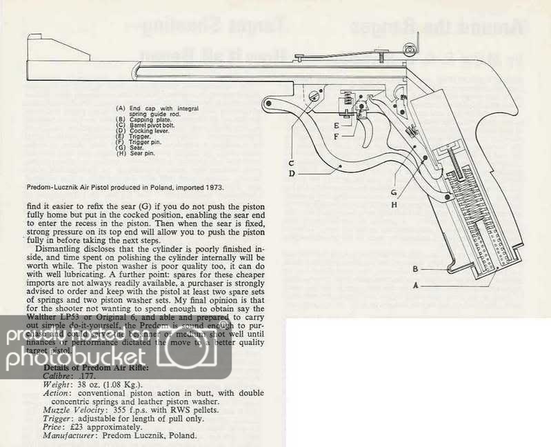

Thanks Stevoo. This little beast is pretty interesting as this is my first "springer" of any kind.
What exactly does the screw in front of the trigger do/adjust? Why such a long screw?
It is effectively useless in the normal sense of trigger adjusting.
If you look closely, you will notice a small travel limiting block which this screw shifts slightly but a forward limiter is not something we usually see on a pistol. It does not alter pressures, or stages like other guns.
However, the trigger is not too bad once polished and lubricated …just forget it and dont worry about it.
As a word of warning….do not ….ever …remove the trigger blade from a LP53 or Lucznik.
The replacement of the little trigger group components requires the use of a little slave pin which you will need to make…a real PITA
Not to my knowledge. The locking screw merely serves to slightly splay the end of the thread of the larger pivot screw to prevent it coming unscrewed. Nothing special required …just nip it up.
The main concern, based on my experience, is to degrease the inner thread of the main pivot screw and degrease the threads of the lock screw so it stays done up….left greasy, it will keep coming loose on you.
You want a faint hint of moly on the smooth dia of the pivot pin but keep it down as it will be squashed into the threads when tightening up…..just a meniscus is all that is required…
Perform every task with the greatest of care, or this gun bite you in the ass, but get it right and it will reward you.
Despite the upward shunt, of this gun and the LP53 its a very singular, repeatable recoil and once mastered can make astonishing accuracy….going much further than the HW45 or Webleys…ive even known them beat FWB 65s in the right hands.

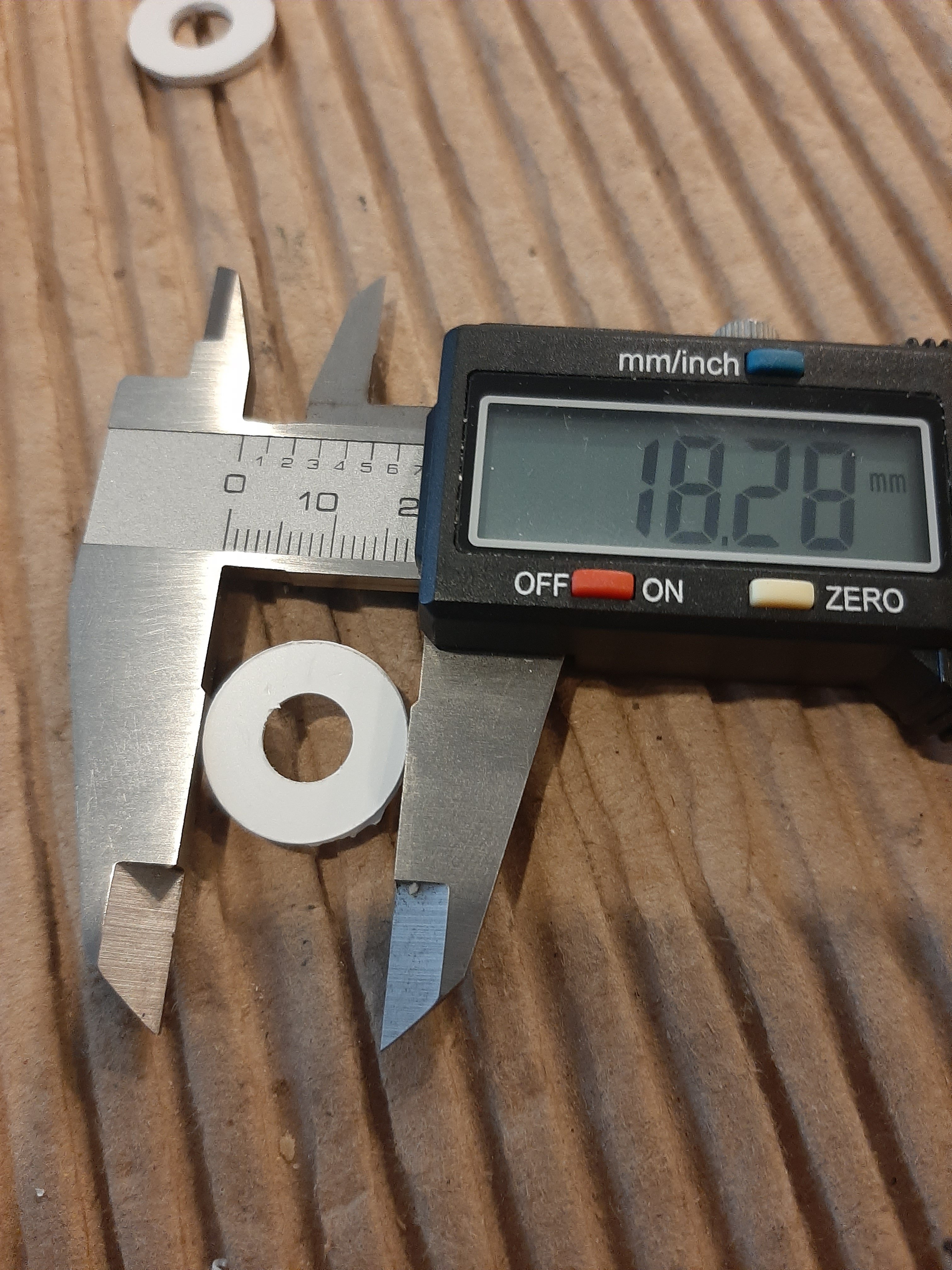

Sometimes when shooting the PL the spring cap comes slightly loose. When tightening the usual squeaks and groans occur from the springs which means they are being wound up and de-coiled at the same time. So without a cut spring and delrin top hats I made some washers out of .06" polystyrene sheet. Why that material? - it was in the house the time. It does add a slight pre-load to the springs, but there is no noise when the cap is installed or when cocking. The shot cycle is much smoother and velocities are higher.

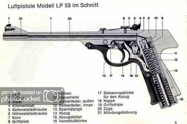

The barrel unlatches due to the detent spring being on the edge of things, particularly with the Predom.
This is easily rectified by employing a slightly stronger detent spring…
I cannot help you with the exact specification for the little spring, as years ago I realised the value of purchasing a mini spring selection box….They do not cost much to buy, and usually offer any permutation you can think of for trigger springs and sears etc…
I chose a 4.5mm OD 1 mm wire and snipped the 30 mm length to about 1/2 inch long for the very positive lock up i get on the LP53..
The value of a small spring and O ring selection box cannot be stated enough.
