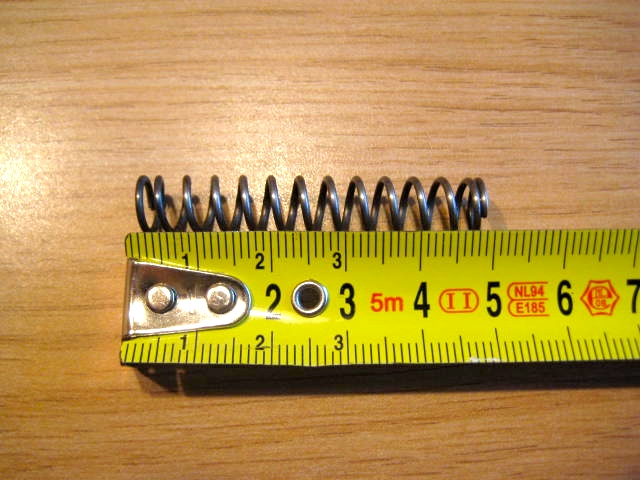

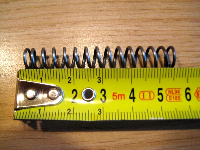

The original hammerspring is 6cm long.

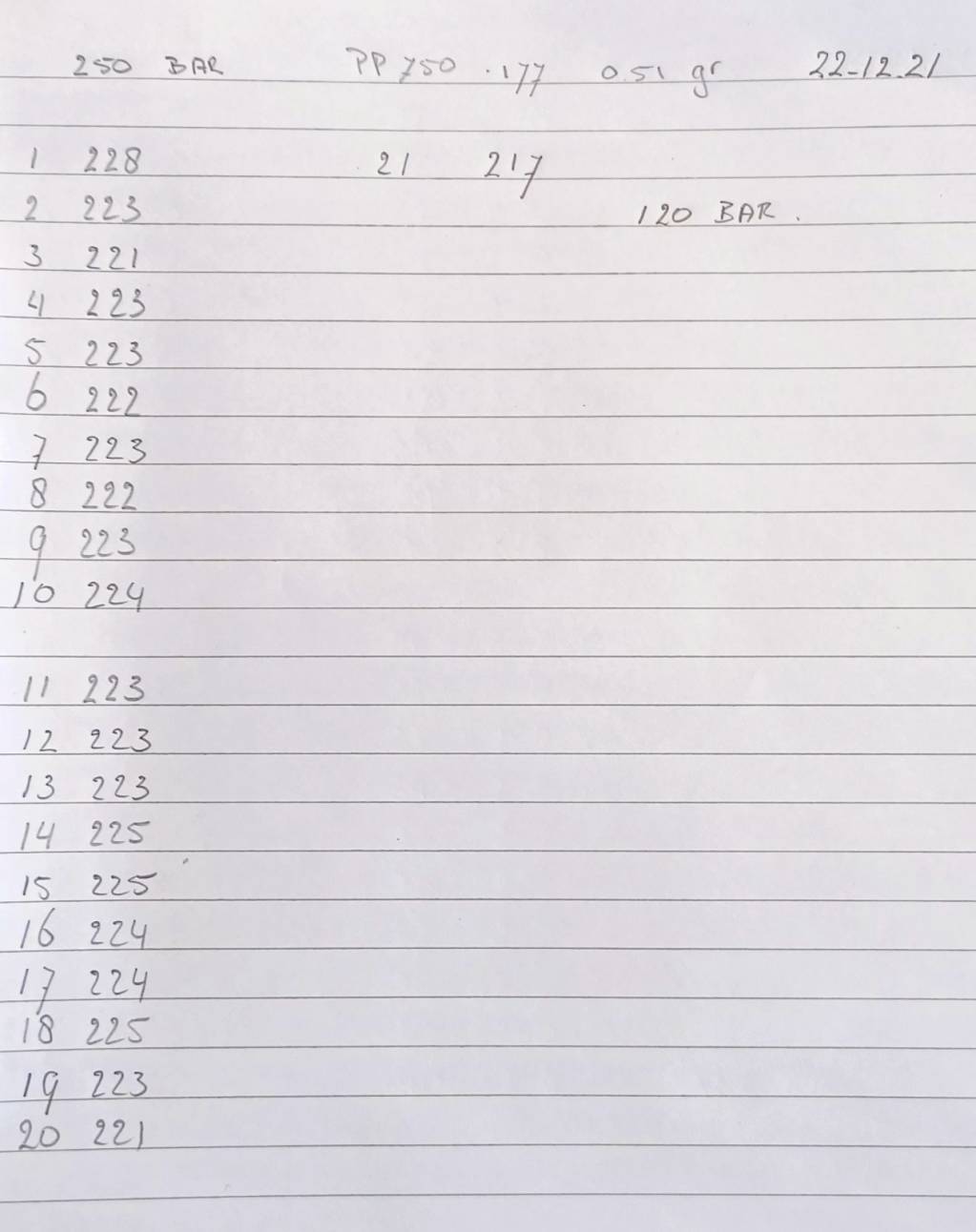

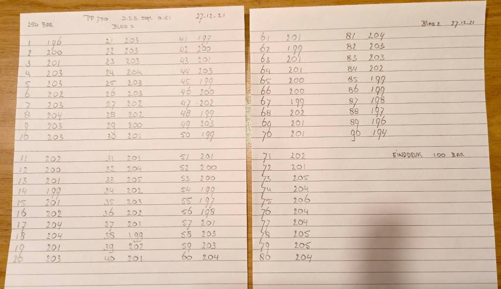

With this spring and the reg. on 120 bar i had this shotcount:

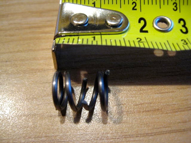

Then i have cut of the first 0.5mm of the hammerspring and i have this shotcount:

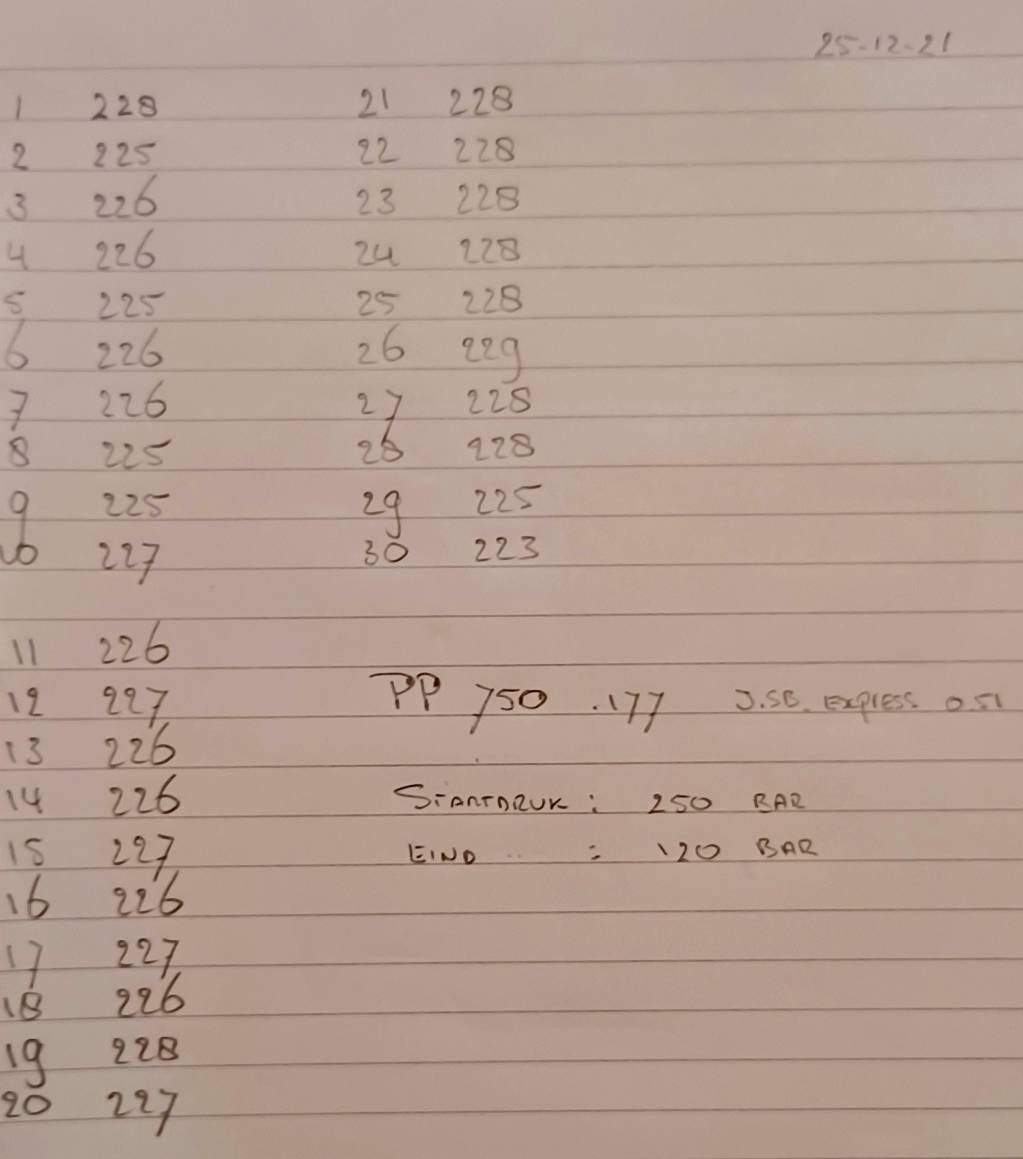

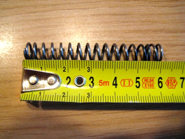

Then i moved the second 0.5 mm just totaly i moved 1 cm of the hammerspring.
This is this shotcount:
In all this counts the hammerspringscrew is completly turnt out.

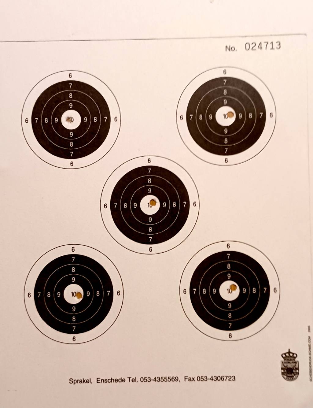

The pellets i use are the JSB Express 0.51 gr and i have a good 10.5 joules
This is at 10m
Regards Joop

I received a spare hammer spring from Wes from AAF in Canada (fantastic customer service, btw). After removing 12 mm to the stock hammer spring (from 65 mm to 53 mm), this is what I got with JSB Hades, 10.34 gr., no other changes:
Stock tune: avg. velocity: 686.2 fps
e.s.:19 fps
s.d.: 5.05
N:17 shots
Stock HS: 65 mm
Avg. FPE: 10.8
Shorter HS tune: avg. velocity: 670.3 fps
e.s.: 20 fps
s.d.: 9.4
N:32 shots
HS: 53 mm
Avg. FPE: 10.3
And now I can adjust the fps from 686 fps to 400 or less, if needed. Less noise and less cocking effort. With the DonnyFl Tanto...shhh!. Great for iguanas at <25 yds. with good shot placement.
