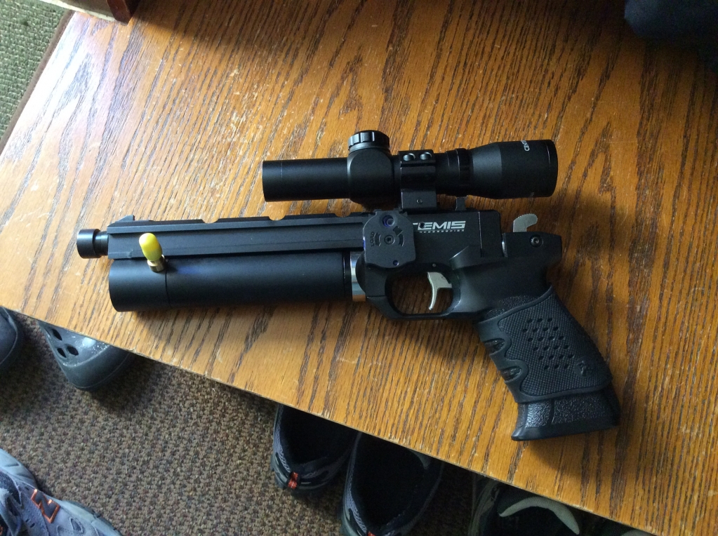

So - got a new PP700 SA yesterday and noticed quite a bit of play in the barrel shroud.
Mounted a scope to the gun, but have not really had a chance to shoot it much yet. Much louder than I had imagined.
So - off to DonnyFL for an adapter and the Tanto that I see so many folks using...should make it back yard friendly I'm assuming.
Removed the end cap and the shroud, and notice the barrel is pretty loose as well, kinda moves around - is this normal? Any mods that can be done to fix it? Does it need fixed?

If you look at the E in Artemis, you can see the screw. You do it on each side.

so your saying that the barrel is screwed into the sleeve that is, I guess pressed in the breech frame and when they get loose your are just fixing them
did i understand that right and if so why would you repair the pistol, that it a manufacturing flaw and would never be fix until they have a few dozen returned guns and maybe not then
so until that problem is fixed everyone that buys this pistol is buying a crap shoot and not all could fix it and once they drill holes I would assume they are screwed if they fail

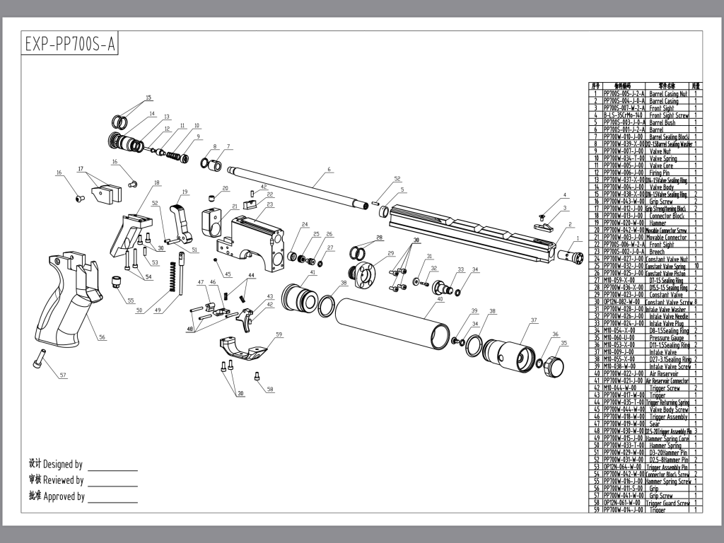

I was wondering what the "fit" is... Is it a press fit...??? Is there anything holding part #7 in place in the receiver/breech...??? My PP700 should be here in a couple days, I'm curious if anyone has thought about using an anaerobic like permanent Loctite or sleeve retainer...??? Much less destructive than drilling holes and tapping them, also can be undone with heat... Just a thought....
