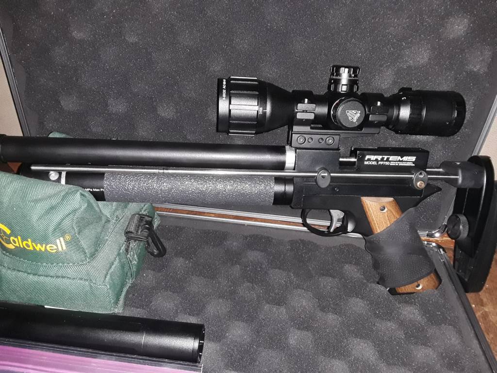

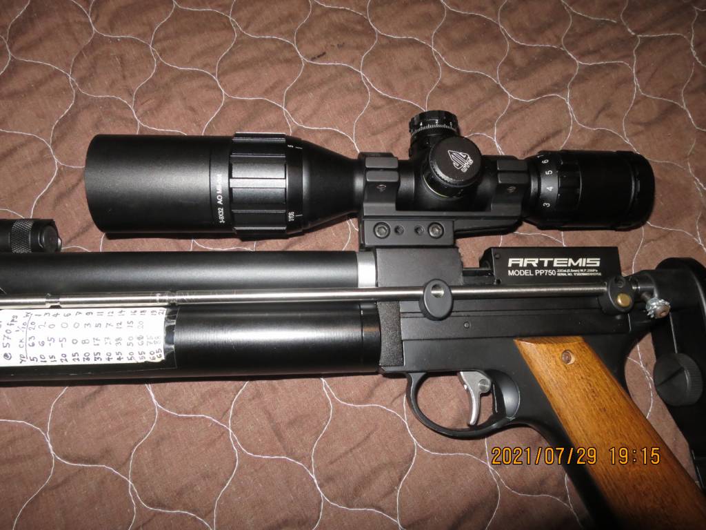

UTG 3-9x front AO R/G IR in a BKL 3" mount. Another member had same set up I just copied. Have run a red dot and was just as fine as the magnified optic on there now, for my purposes. Eye relief may be a problem so may require notching stops for a shorter LOP, or get rod stops. I just can't see put anything larger on it, avoid the scope with a gun attached.

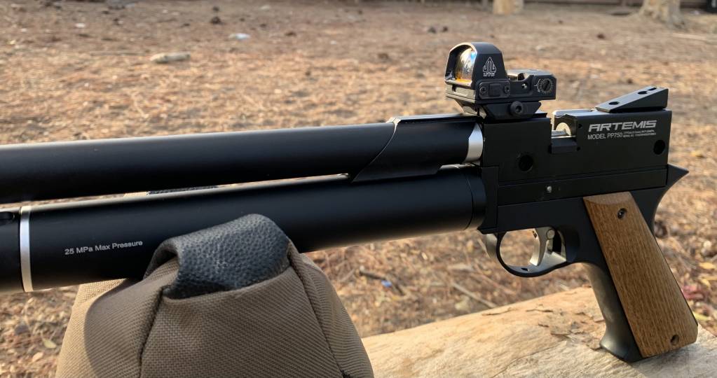

member thane has posted extensively about the pp750 and has a picture of that scope mounted.
Hopefully a 10x24 small scope will work for me and my pp750 but I have not got it yet.

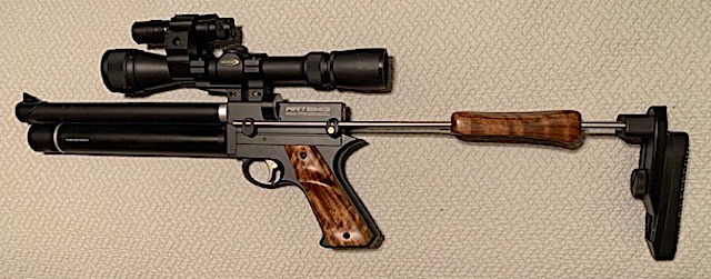

I love my PP750, so it's worn a few optics. Here it is with a (discontinued) 3-9X32 Weaver Airgun/Rimfire Classic, set up for night hunting-

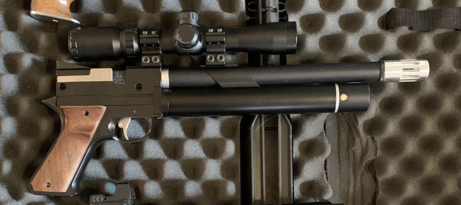

With a Burris Mini 6X rifle scope-

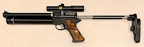

And in it's latest iteration, a very vintage, extremely cool, Tasco 4X15; probably from the 1960s, likely never seen anywhere before now, and super clear optics (Japanese)-

AirNGasman Really like the tasco 4x15 have never seen one of them . Are you using carm mags ? also do you know how far they stick above the breech ? Mine is in 22 cal,

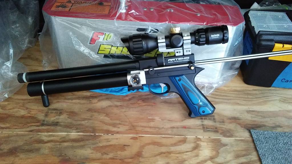

Right now my wife has a great interest in this gun I might be losing it !!!! Should not of put the blue handles on it . Will post a picture in a few .

"AirNGasman Really like the tasco 4×15 have never seen one of them . Are you using carm mags ? also do you know how far they stick above the breech ?"
That little Tasco is really nice, but unfortunately useless without a Bushnell rail-type mount. I need to raise the scope about 1/2", but easier said than done. I felt like the original magazine sucked. The Carm is much better, and sits about .328"/8.3mm above the top of the breech of my .22 PP.

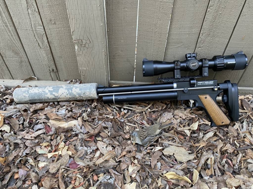

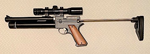

Here's how mine is set up-

@kkarmical -- Hehe, belated thanks for the inspiration in how to set mine up.
BKL mounts can be had from most airgun vendors or direct through Airforce.
I was having some accuracy headaches early on, which I think was a shroud problem. Something like hole in hole few shots at 15 yds, then holenhole an inch up and right, &c. I placed a couple drops of machine oil around that starfangled nut on the barrel inside the shroud toward muzzle. Found the shroud to airtube gap diminsihing to the muzzle from breech, so remounted the shroud band dovetail and slid it forward all the way and mounted an arisaka adapter for a light. Very stable now. I can soda a pop can at 60 yards. Fun fun fun. Really likes any flavor of 15.9 and 18.1gr diabolo, and even the NSA 20.2gr.
ATB, Mark
edit: And thank you to everyone for posting your pictures. Been thinking of getting another PP750, in 177. Seeing your folks' rigs got the wheels turning...

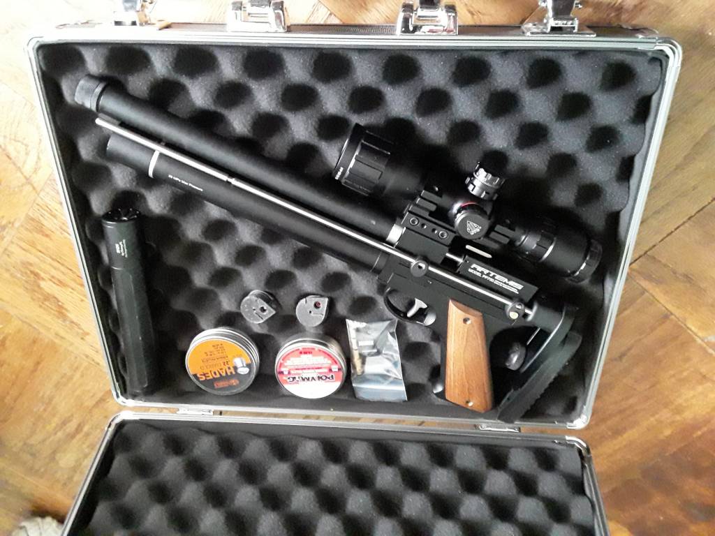

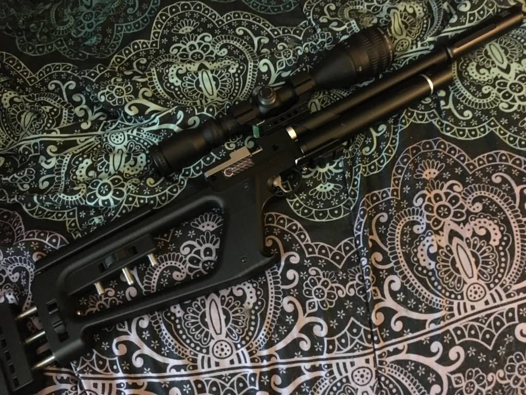

I want to say thankyou to everyone for all the info and help again . I wanted to get this gun going fast to try it out so I ordered a bug buster since I already had the mounts and it will be here Sunday , but I see it changing in the future to different set ups thanks to qball lol . Still waiting on my baffles as this thing is loud ! without them . So will be looking maybe for a lcd . Plans for tomorrow is a cheek piece going on the rods kind a like AirNGasman's (thanks for that idea also ) . Darell
I'm also a big fan of those Japanese made Tascos. I still have three of them mounted on powder burners. Very clear sight pictures and rugged scopes as well. When I'm attending a gun show I always keep an eye peeled for used ones.
