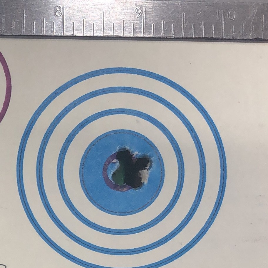

Here’s my last 5 shot group at 70yds last night no wind. 380mm 25.4 860fps
This gun just flat out blows me away. Now not every group was this tight but if I’m shooting moa at 75yds and under I’m disappointed.
