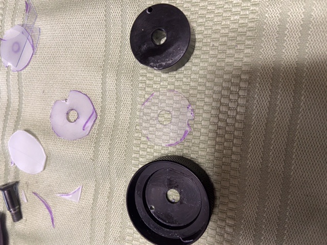

Had the same trouble with my MK3. Cutting threads won’t help as the screw has a shoulder that tightens against the block. The screw threads are only using half of the threaded hole. I had a great idea and it is simple. Pulled the stair-way hub out of the wheel and cut a piece of shim plastic and sandwiched it between the wheel and hub. Drilled a hole in the center for the screw and notched for the HS adjustment screw. By changing shim thickness I can get what ever tension I want on the wheel. No cutting, drilling or mods of any sort to the stock parts. I ended up using a very thin piece of plastic and can draw the wheel down tight so it won’t turn at all. Loosen the center screw and you can rotate the wheel for lower speed or tuning. I picked up about 5 FPS as the HS is just a tad stiffer from the thickness of the shim. I did not retune because I had already turned it down a bit the other day. I have the WC shooting JSB 33.95 at 900fps average for 35 shots before it falls off the reg that is set at 134/140. Power Wheel is set on#7 and the HS is 3.70mm.
