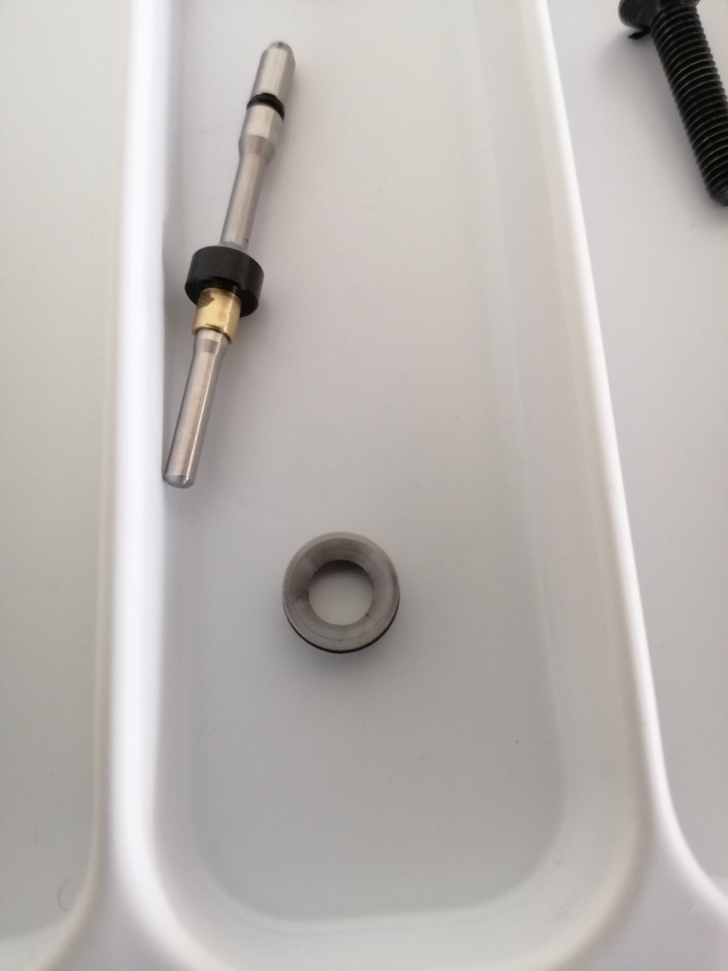

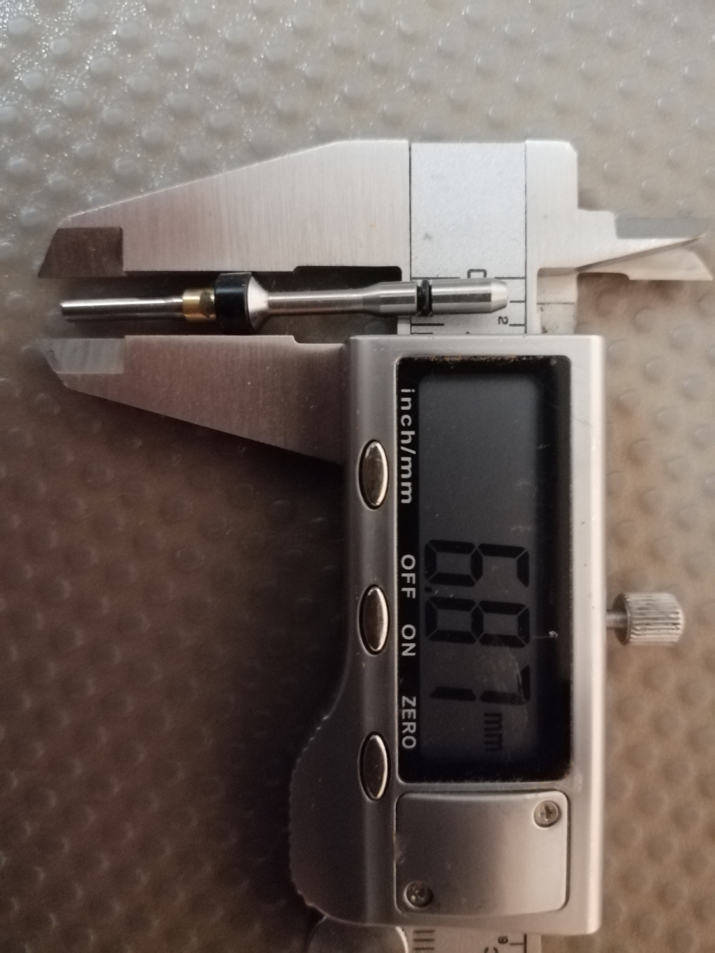

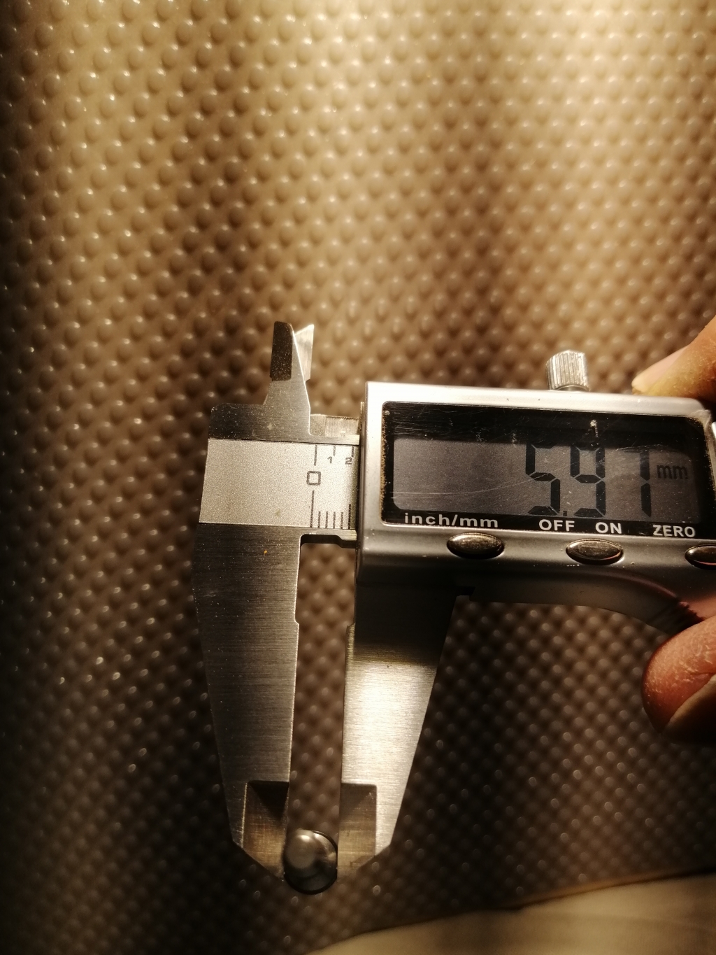

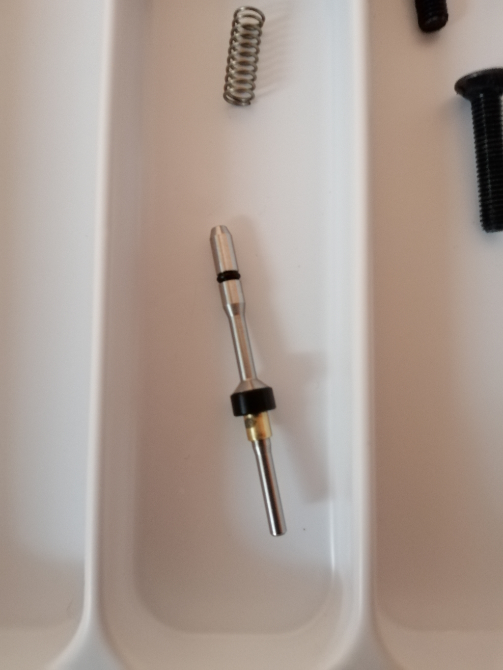

The needle that closes the VS is the one with black Teflon, which has a size, as you can see from the photograph, of 5.97 millimeters in the metal part and 6.87 millimeters in the widest part, the black one in Teflon. My question is this ... is this needle ok if I change the 5.5mm VS and mount the 6.35mm VS titanium? Or you need to change the needle, as well as the VS.
Yes I was planning on putting in the 6.35mm valve seat. I am hoping for all the airflow I can get.
With ported probe and transfer port. My 700mm Crown Continuum pushes 34gr JSB’s to 935-940fps. at 150bar. I’d like to keep the reg pressure as low as I can. I’m not planning on putting in a heavier hammer just yet. I’m just not sure if there is much to be gained with larger valve seat alone.
The valve seats are pretty cheap so at the very least it will be a fun experiment and easy to switch back to stock if I don’t like it.
