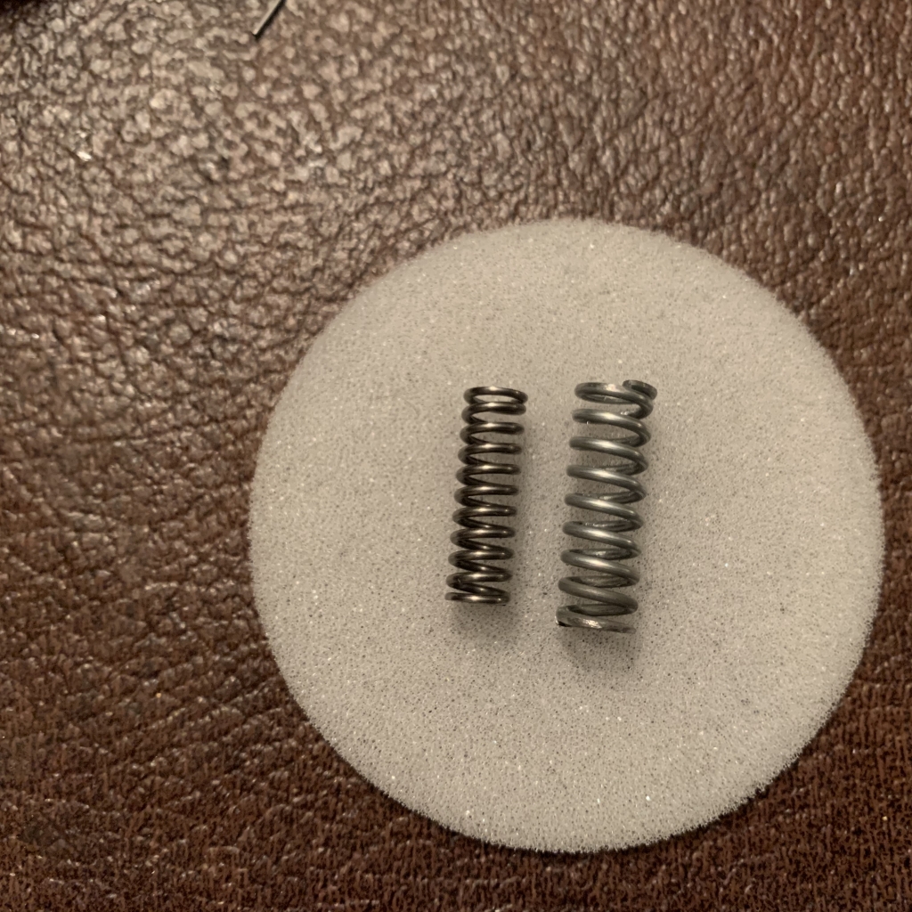

Made a 3 gram brass hammer weight to test with an ultralight spring. Getting around the same power output as the heavy springs, but I need to stiffen up that valve spring - bounce is pretty ridiculous and it's wasting some air. Factory spring is on the bottom..

RE: springs - you could go with larger I.D. too, as long as you provide an adequate spring guide.

Captain's Log, Stardate 2020 zulu. Made a custom valve spring slightly longer and stronger than the factory spring. Saw a consistent increase of 15fps and my shot count increased by at least 5 shots (but only filled to 210bar). Also refaced my brass valve housing slightly deeper with a larger flat face.

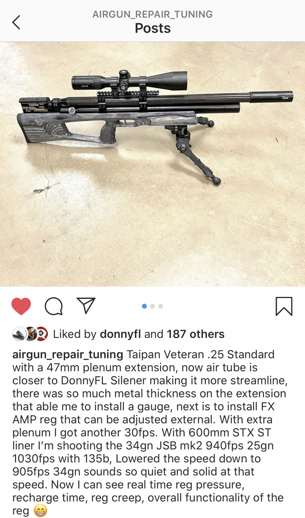

1- What's the difference of installing one plenum or two plenum ??
2- Need to know the advantages and disadvantage both of them ??
3- what is the recommended one, if I want to shot heavy slug 25 : 33 gr with average speed 920 f/s and a good shot count ( average 50 shot ) ????
You could probably achieve that velocity in a Standard with boring / polishing the transfer ports, upping reg pressure, and adding a heavier valve spring - without the plenum extension after the regulator, and instead - put the extensions on the other end in front of the gauge for shot count. My 22 cal does see anywhere from 10-15fps per plenum, but reg pressure needs to be bumped 10 bar or so with each one to compensate.
You can experiment and see if you get an idea balance of power and shot count by moving one or more extensions to the front or rear. The rear will yield the most shot count benefit, given that it can hold 20cc's of air pressurized to 250bar 👍

How does a stronger valve spring increase FPS? A stronger valve spring decreases valve dwell which means less air being used. So I get the better efficiency result but not the increase in FPS. Can someone please explain?

Probably helps with the drop in pressure when the valve opens. I don't think this is noticed as much with longer barrels, but I'm mainly doing it for better shot count.
I agree. Stronger valve-return spring makes for less power potential but more efficient.
And, once I add extra plenum I like to decrease reg pressure myself. That is, unless I’m going for crazy high power.
With the dual power plenums installed, I could keep power up and drop 30+ bar from the reg. Problem was, with the lesser reg pressure closing the valve and with the Taipan’s weakish valve-return spring, my efficiency went to crap. I found that I need at least 140 bar reg set to keep decent efficiency.

@zx10wall - I might have finally made the perfect valve spring. Shot count now is higher than it has ever been, and I'm still seeing a consistent 10-12fps velocity gain over the factory spring. The I.D. is 5.52mm, a bit wider than the spring guides, but there hasn't been any signs of wear on either of the guides after a tin and a half of the monsters, and they seems to say in place well enough.
