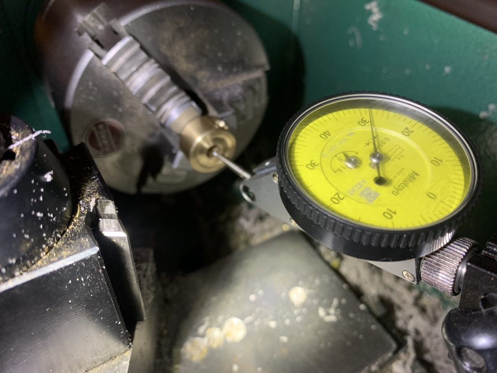

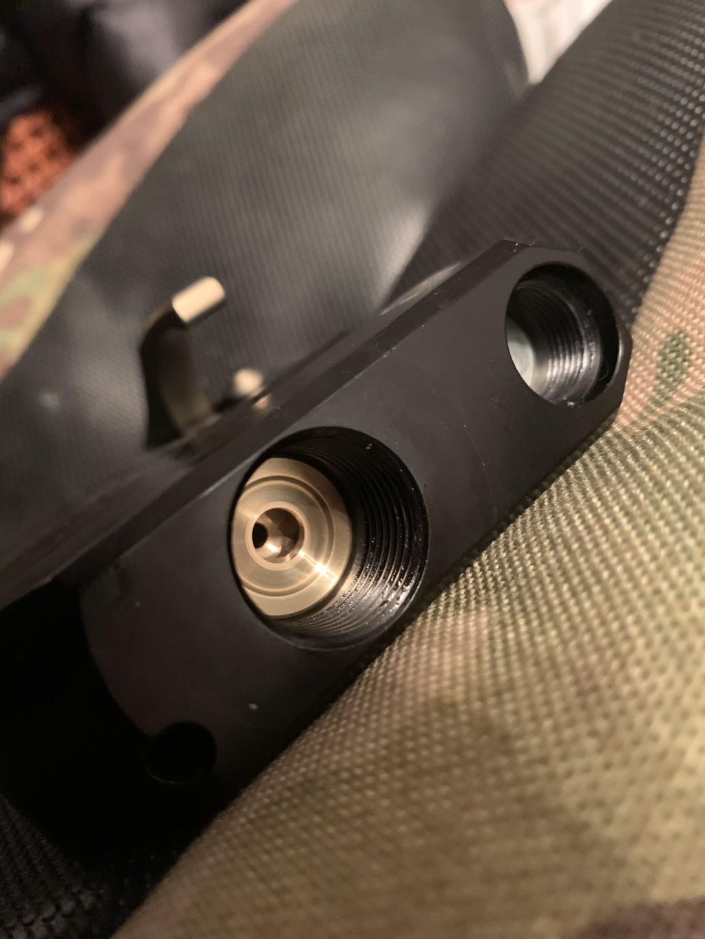

Bah, this has been a slow marathon getting this one setup. I bored out my brass TP to 5.53mm, thought it was all good and had air dumping down the barrel. Had to resurface a flat on the face to get it sealing again.
1578212108_20819529785e119b0ccf7822.98206768_1D217FC2-2CB2-4D12-8ECD-BC5D53B16E66.jpeg
1578212110_17649769705e119b0e2ae601.31530784_22ED238E-C5B7-40AB-A36B-105AE7017F20.jpeg
Anyways, I got all of 10fps out of that mod from where it was before for 959fps max. I had dropped my reg pressure down to around 142bar prior and tested a new spring and bushing. Cocking is like cutting warm butter, but with the larger port I earned a benefit of using even lighter tension. When I shoot the monsters, it sounds like 400fps when it's actually 900-915

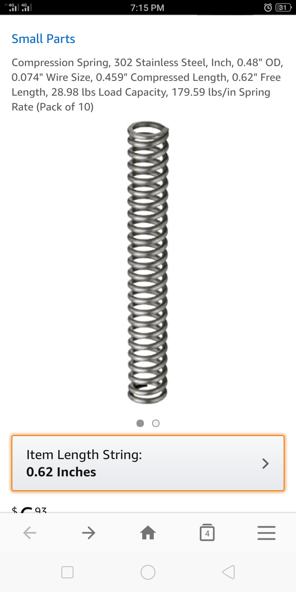

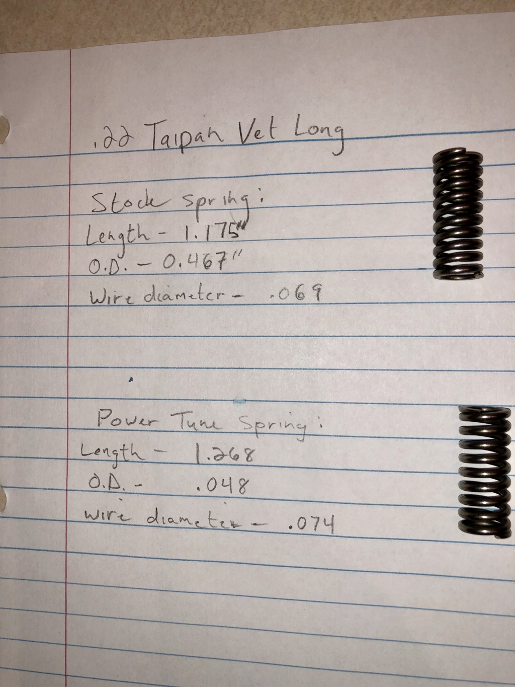

4) Pull your spring out and measure it. Springs are readily available on Amazon (music wire works well)
5) No, the factory return spring is already on the weak side.
Sorry, typo below. Power tune wire size should be .48 not .048

2- could you please give me the exact link for hammer spring, I searched on Amazon, didn't find it ?????
1) You shouldn't fill beyond what the manufacturer recommends because that is a gamble you don't want to take! The added plenum will get you more shots if you kept the FPE the same. This is because you can lower your regulator's set point with the extra volume of regulated air on tap and continue to get the same power. You won't have to hit the valve stem as hard and you will shoot down to a lower pressure. 1+1 equals 2
2) https://www.amazon.com/dp/B005KSVVM8?psc=1&ref=ppx_pop_dt_b_product_details ~ quit skipping leg days. Leg work is good for you 😆. These are stainless and do work very well.
