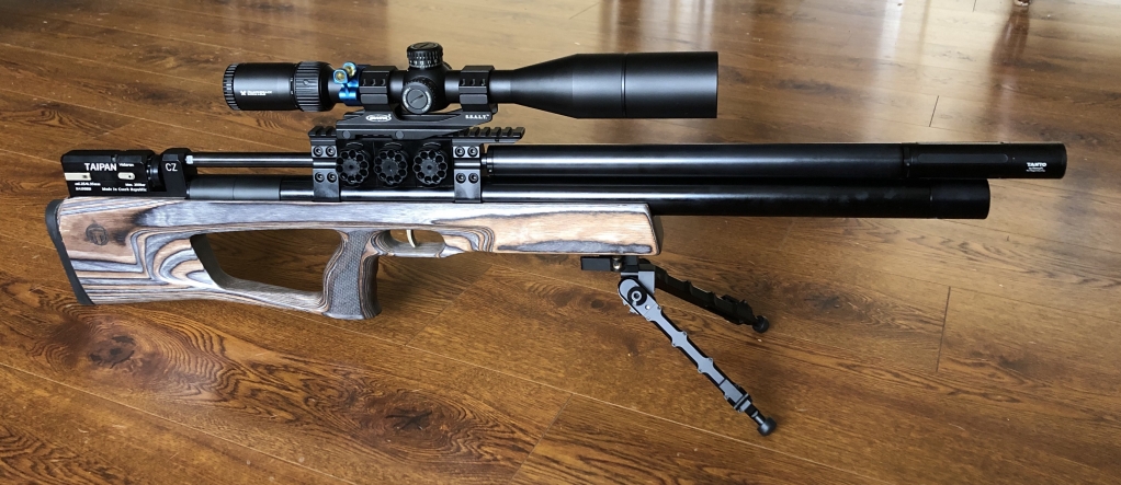

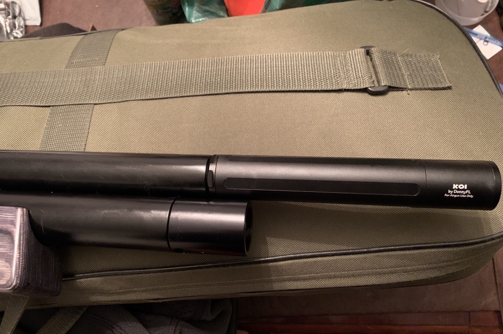

This Koi added some length to my Standard lol, but man is it quiet!!!
I am still bugging out on how quiet this Taipan is with the Koi on it. At 48FPE (28.5gr) it is quieter than my 600mm Crown with the Sumo with the 24gr Varmint Knockers at 45FPE. I'm just hoping that it's accurate without funky POI shifts at long range. Opted for the .25 Koi though, so I don't think the moderator will be a problem.
Hopefully someone can chime in with the Tanto at higher power. I'd love to know how it sounds compared with the Koi. I might wait until after the weekend to install the second plenum extension, I have a narrow window for target shooting this weekend and need to collect some data before I mod it further. Overall, I think the power output is promising so far, given the short 460mm barrel 🙃

With my .25 Long, believe is or not, the addition of the Tanto is all I feel I need. It greatly reduces the bark.
I believe you. I ordered one from Donny today (sticking with .25 for my .22).

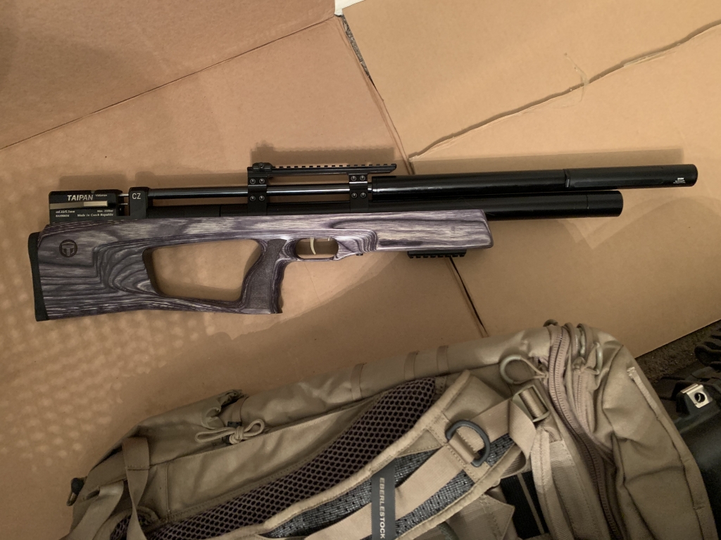

I'm quite honestly afraid to install this second plenum, because I will probably want the power potential of them both, full time. The problem with that is length - one of my main build parameters for this was keeping it as short as possible 😭
Tons of wind and rain are forecasted here this weekend, so I will probably wind up testing the dual plenums tonight or tomorrow.
With two plenums I'm maxed at 50FPE with the JSB Redesigned Monsters at 949fps. Thr FX chrono says I lost power with 33gr (805fps) and with my target ammo, the 28.5gr NSAs at 840fps. I haven't touched my reg, it's still around 145bar.
I don't think I need more VDT with this short barrel. I'm going to try dropping pressure down to 130bar and see what happens. I don't care for the length now at all 👎
Doubled my power plenum pleasure as well now. It immediately jumped another 15 fps at the same HST and reg setting ~ sending King Heavies at 935 fps now. Will test shot count and accuracy later today.

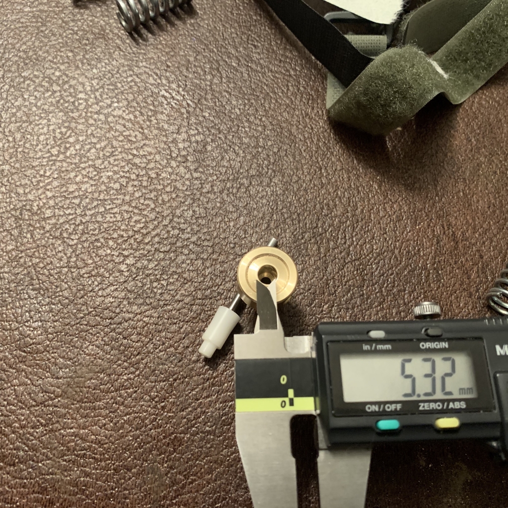

I have mine apart again as I write this. I had spent a few hours playing with springs, making acetyl bushings, et al and got real good data on the hammer and valve. Then, as I'm trying to figure out where the bottlenecks are I measure my brass transfer port and saw this..
1578197213_12857376115e1160dd488232.47148832_0391438F-9622-4646-9054-03F918A97C05.jpeg

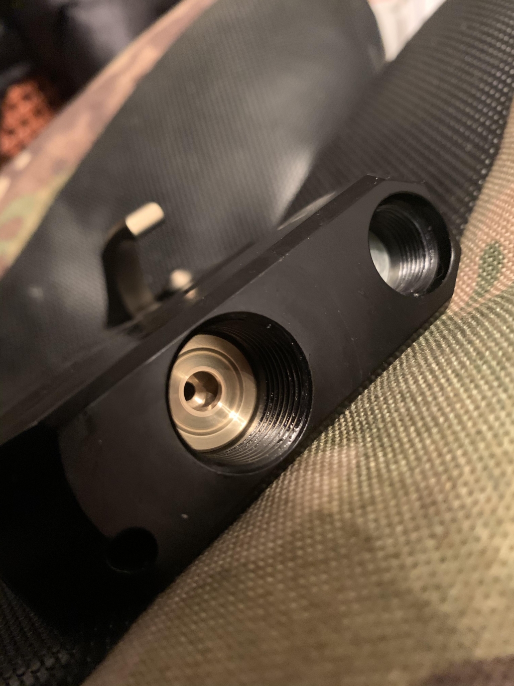

I took for granted that it was ~5.5mm. My seat is 7.62mm, so I'm probably going to drill it out with a 7/32 and see what happens. I'm not toonworried about the seat, but if need to make a larger one, I'll just make one.
PS - has anyone measure their port in the .25's?

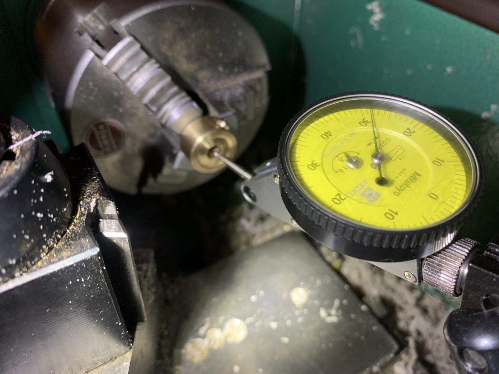

Bah, this has been a slow marathon getting this one setup. I bored out my brass TP to 5.53mm, thought it was all good and had air dumping down the barrel. Had to resurface a flat on the face to get it sealing again.
1578212108_20819529785e119b0ccf7822.98206768_1D217FC2-2CB2-4D12-8ECD-BC5D53B16E66.jpeg
1578212110_17649769705e119b0e2ae601.31530784_22ED238E-C5B7-40AB-A36B-105AE7017F20.jpeg
Anyways, I got all of 10fps out of that mod from where it was before for 959fps max. I had dropped my reg pressure down to around 142bar prior and tested a new spring and bushing. Cocking is like cutting warm butter, but with the larger port I earned a benefit of using even lighter tension. When I shoot the monsters, it sounds like 400fps when it's actually 900-915 🤔
