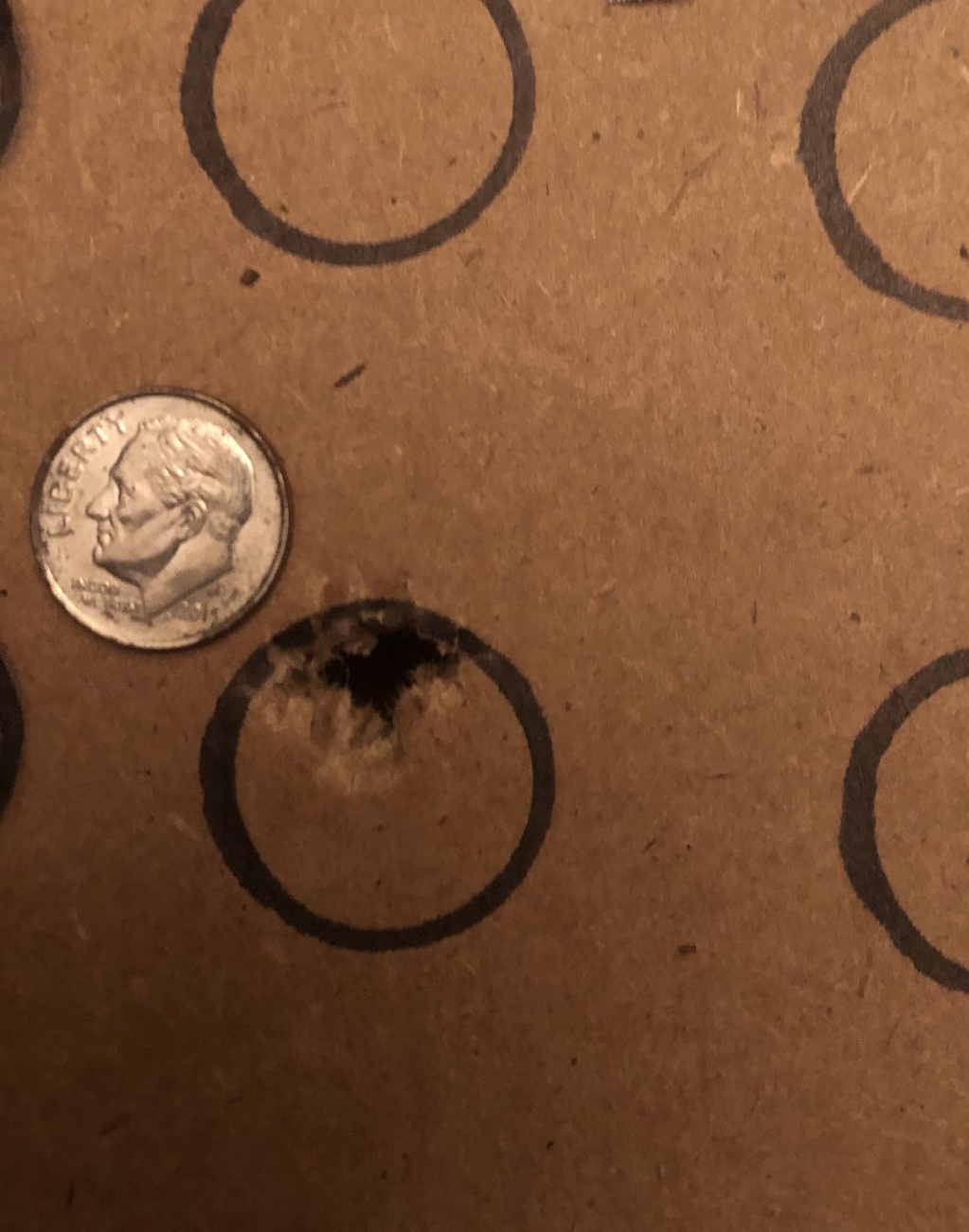

I shot out to 83 yards in the wind and the 10 shot group looked to be less than an inch. It’s a bit stormy here today and I was shooting during a little break in the weather. More testing to come. Here is a quick 5-shot group from 40 yards.

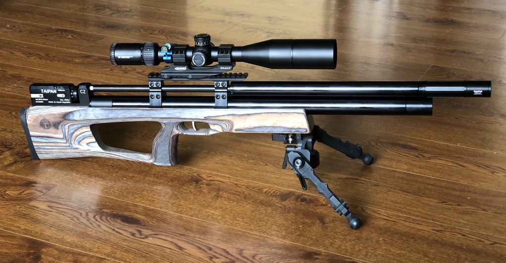

@sniperlabyo - I'm considering putting a 500mm or 600mm barrel on this build. What did you wind up doing for an adapter to attach your STX barrel on your Taipan?

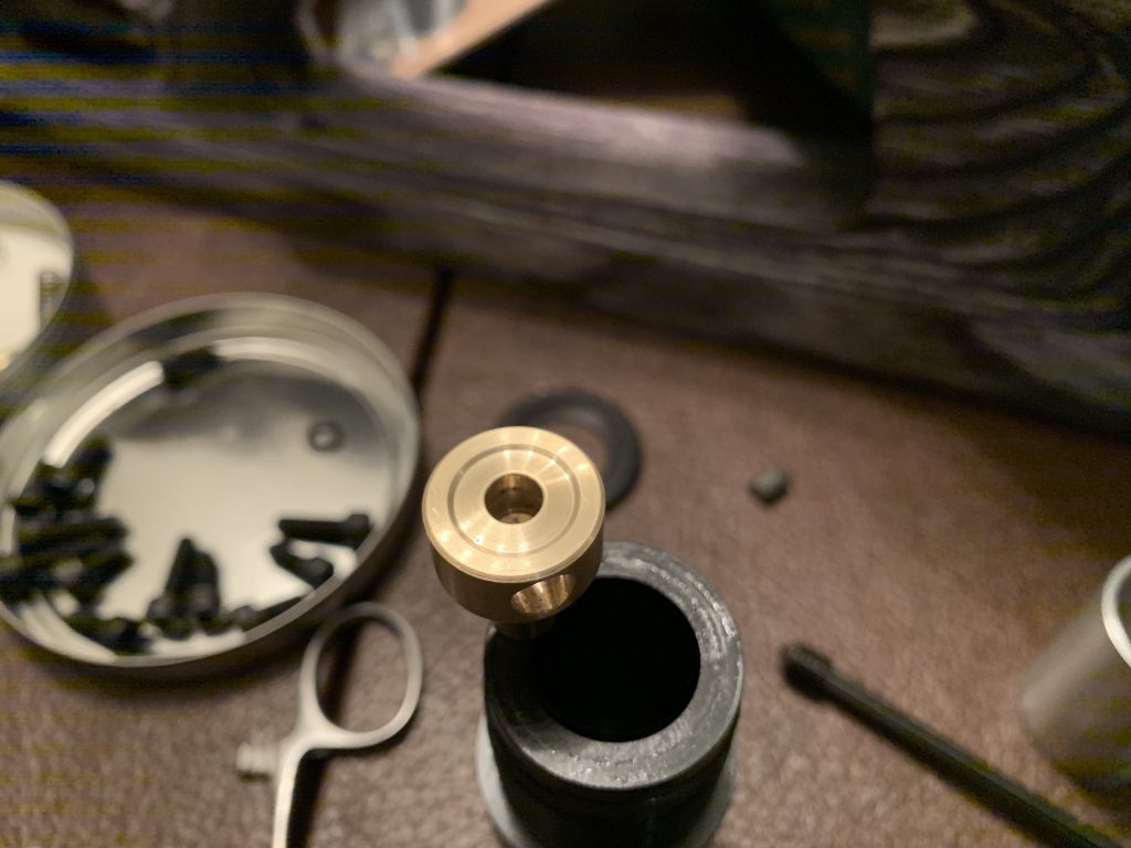

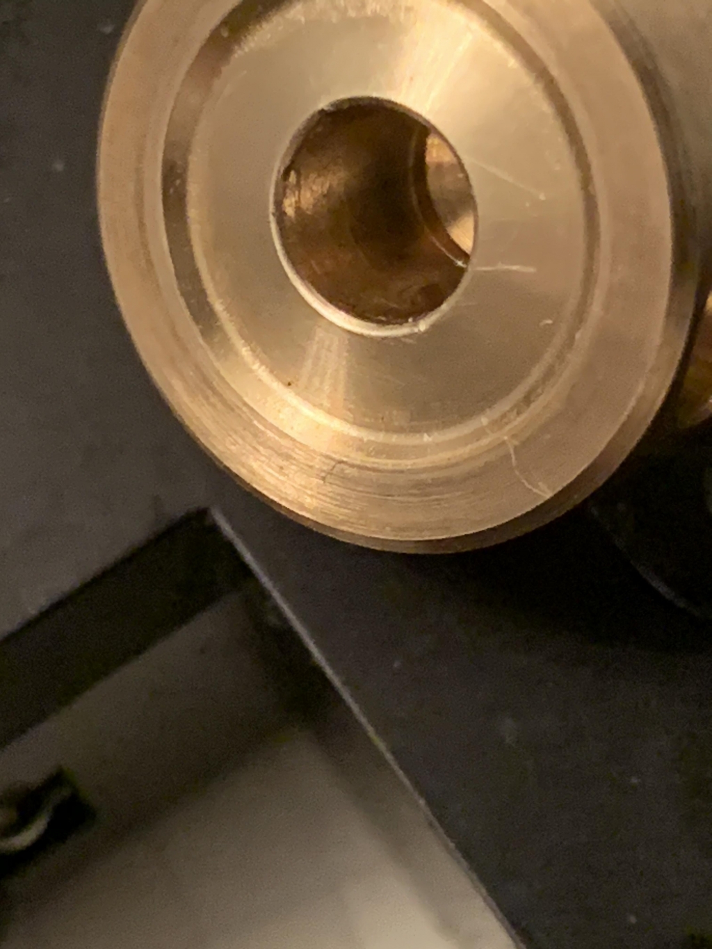

I got the transfer port out, but totally missed the fat little set screw holding it in place at first. I wound up with a small little gouge right on the sealing surface and had to put it on my lathe to polish it out by hand. I checked it after with my dial test indicator so it should seal once I get the barrel polished and everything back together, but damn that was an unnecessary step 👎
1f44e.svg
Well crap. Hope it’s fine. You do have an exploded view in the owner’s manual (last page) for the Veteran. Most of it also applies to the Mutant.
