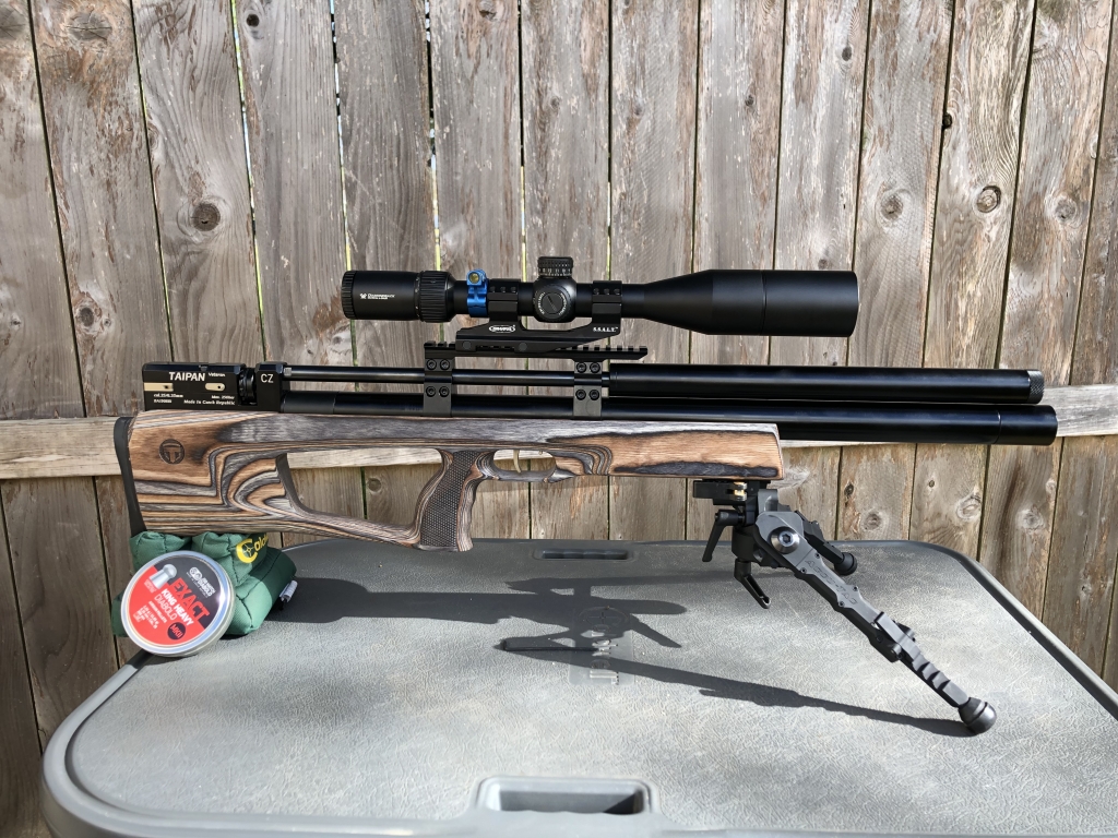

Pic rail installed. Accu-Tac FC-G2 deployed. Let’s get a bit more serious with precision shall we....

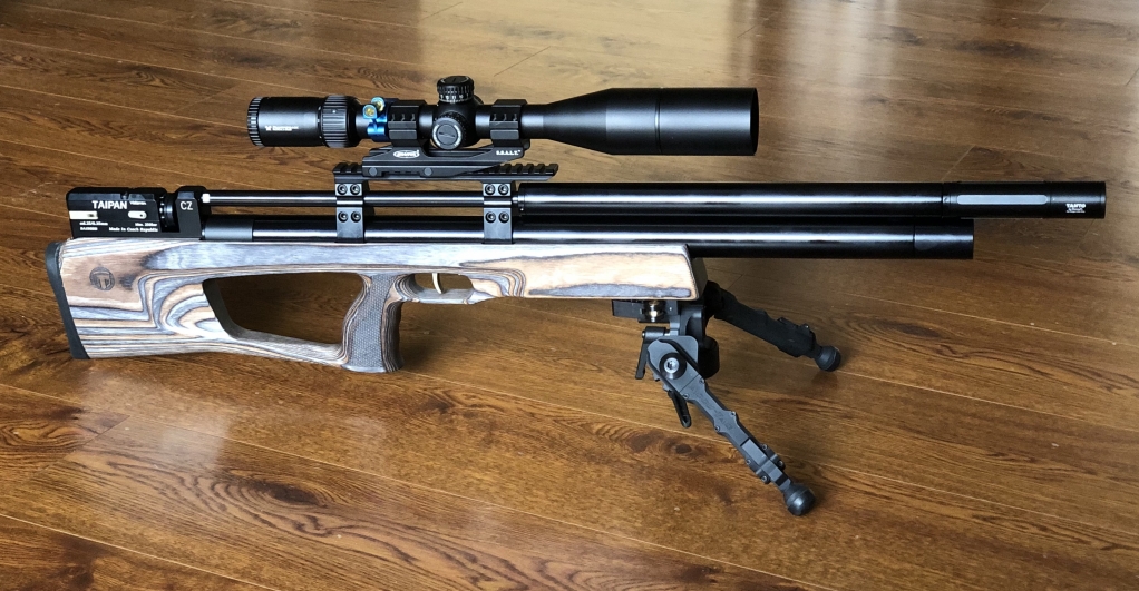

Got the Donnfl Tanto on and it works great. I should be getting my papy_yosh biathlon lever, cheek-piece and mag holders soon and more pellets. I’m going to order up some 26.8 gr NSA slugs as well.
