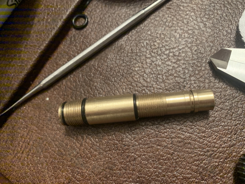

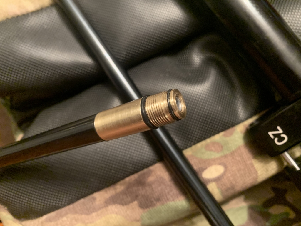

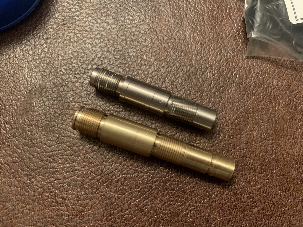

Well, I did it. After failing at my first attempt at making an M14 threaded adapter to mate with the stainless connectors on the FX barrel kits, I wound up consolidating both the brass inlet and stainless pieces into a single adapter. This is a pretty solid prototype that I am very happy with from what I see thus far.
The wrench that was thrown into this little project were the threads on the breech end if the FX stainless piece i had it in my mind that it was either an M12 or a 1/2-20; it's neither. It's almost an M13, but an M13 tap is too large for it. I could have probably polished down an M13 thread in retrospect, but the lead time on the die didn't align with getting a prototype made, so I had to cut the metric 1mm pitch threads on my lathe with an imperial leadscrew (thread error of 0.087%, but it's a short length so meh). The change gears make the compound slide fly really fast once the half nut is engaged, so I had to be real careful not to F it up 😂

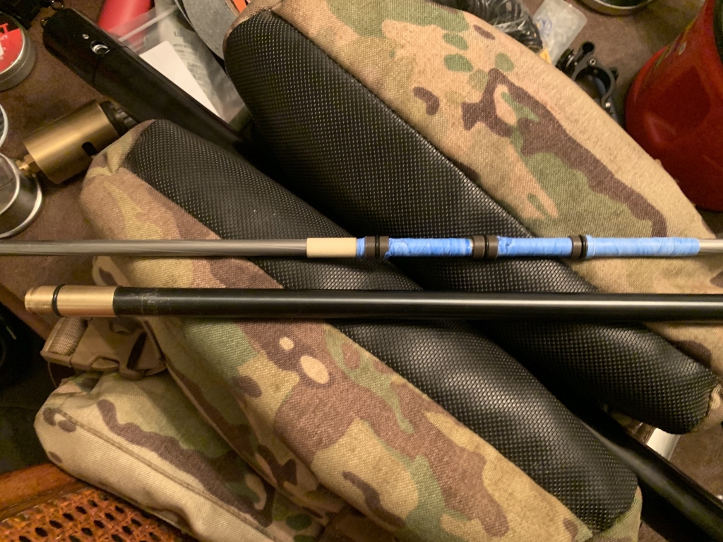

Anyways, the other tricky part to this was leaving just enough of a lip at the breech and a slight internal chamfer to seat the liner perfectly. I wound up using around 4 different drill bits to support my 22 cal, and the last pass was made with a modified bit to carefully bore it perfectly. I used an M14 die on the threads going into the acton, and added strategic o-rings (the last one on the breech end isn't even needed).
My adapter doesn't need teflon tape, it's just a couple of o-rings, the sleeve, liner, and retainer. No leaks at all. I will make something to sleeve the assembly inside of the trigger housing, but for now Gorilla tape is 💯:p

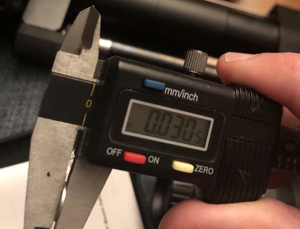

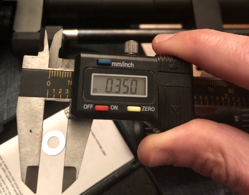

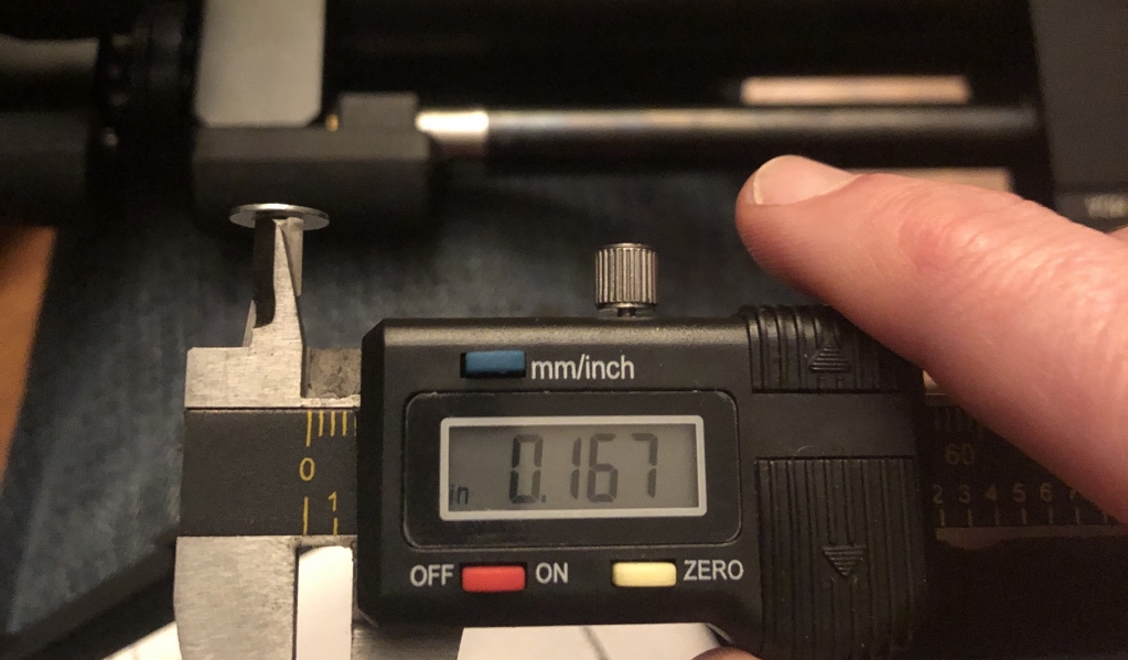

With 2 power plenums added and the FX barrel system w/700mm liner, I needed to lower my reg as I was getting mondo power at my current 142 bar.
Problem I experienced when previously lowering my reg to 130 bar or lower, was that I found my efficiency went South. I contributed this to the weakish factory valve-return spring. So, I shimmed the spring to stiffen the tension using two small washers. I placed these on the end of the assembly closest to the c-clip; over the spring guide and under the spring. Pictures and specs of the washers are below. Again, I utilized 2 of these washers.
I lowered the reg to 115 bar and dialed for 910 fps average with the hammer spring adjuster. Here is a full shot string from a 250 bar fill. I’m pretty happy with it. It dropped off after the 47th shot averaging 62.4 FPE.

To compliment what Derrick is showing with the washers - it's tempting now to mill out the floating metal spring guide and tap some threads in place to add an adjustable length spring guide using a slightly fatter grub screw turned down to 4mm on the valve side (as the new seat for the valve spring). I was suppose to get more aluminum Friday, but I'm getting too impatient and might just do this today hahaha

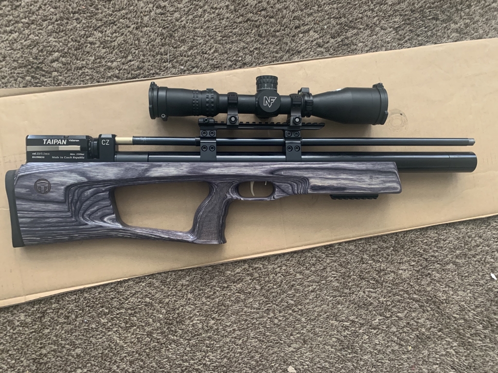

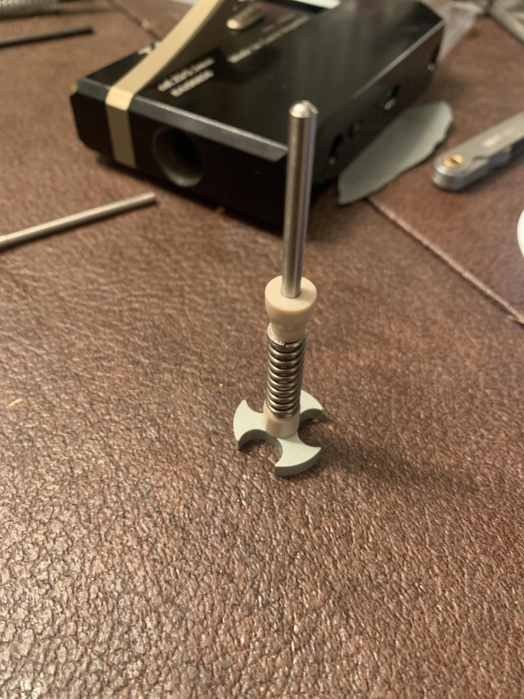

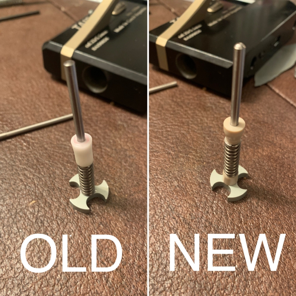

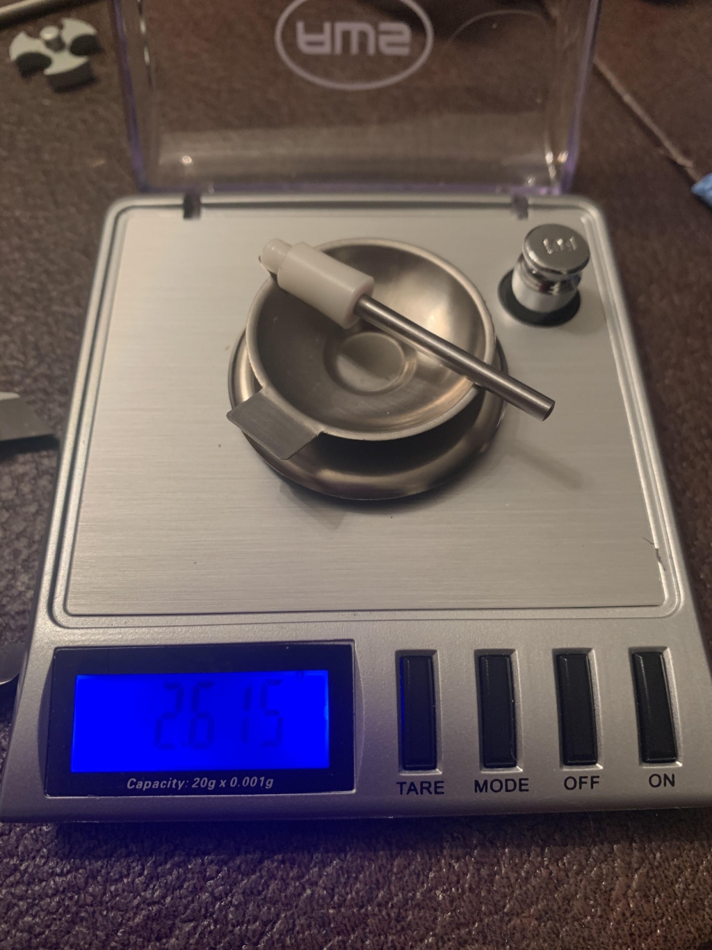

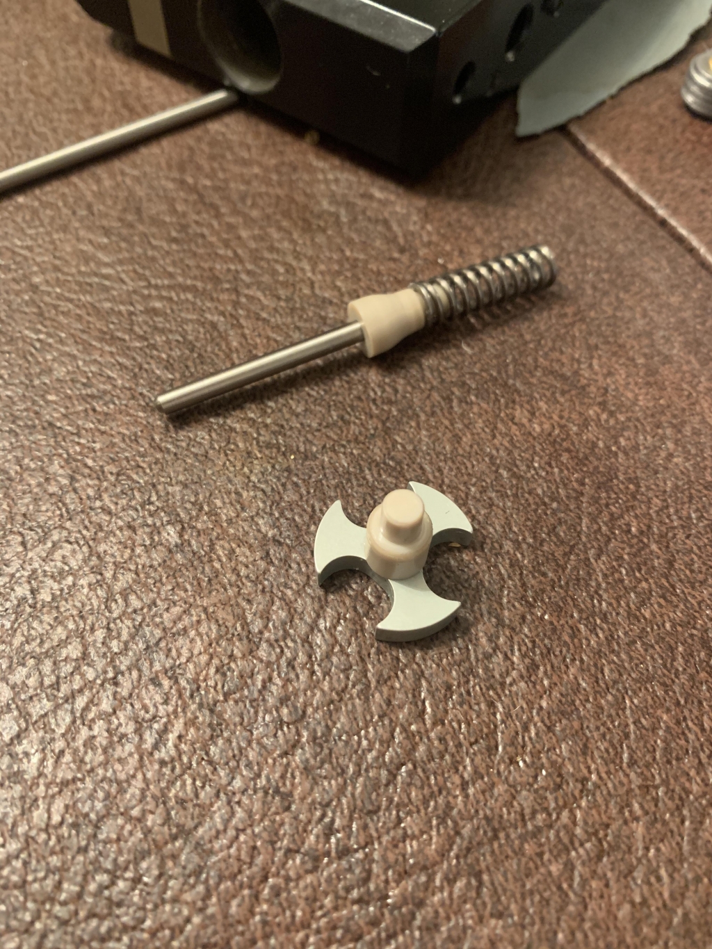

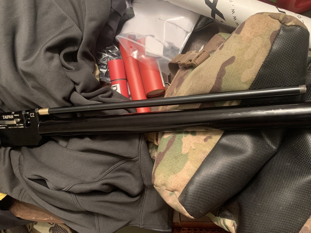

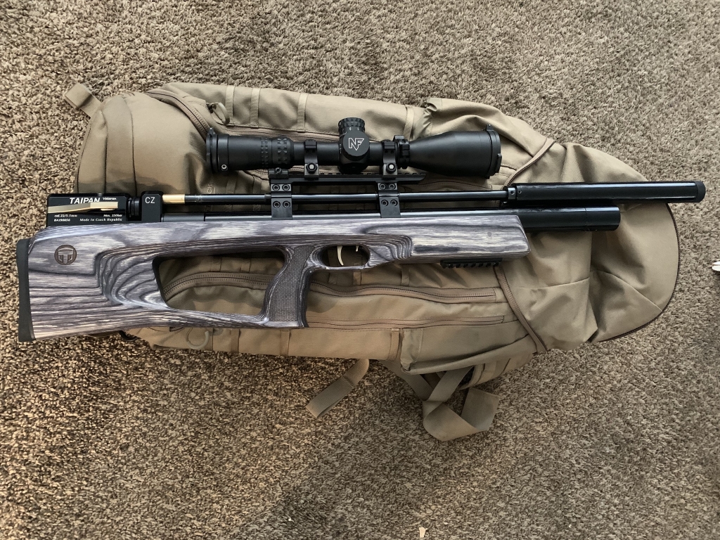

Forgot to update this thread. I did a couple of additional mods recently:
  • Made another prototype valve pin using (Ketron) PEEK, 8mm OD and less material than the first
  • Made a PEEK valve spring seat to add a total of 3.1mm of additional valve spring tension over the factory length

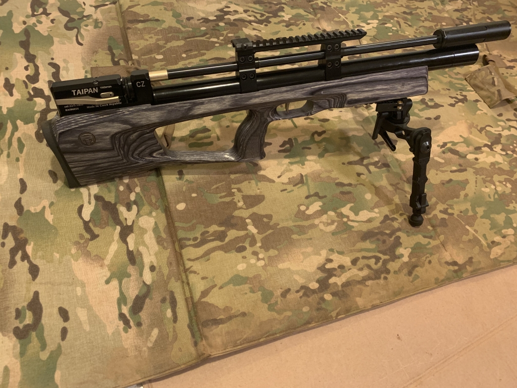

  • Installed my 600mm FX barrel kit with slug liner A, borrowed from the FX Crown that I bought off of @bob_o
  • Re-added the Taipan LDC with a 13.1 x 1.6mm o-ring sandwiched between the Crown kit's shroud shaft collar (to seal off air stripper gases, which works perfectly!) - had to do this because the Taipan barrel OD is larger than the Crown barrel sleeve
This brought me up to 65FPE (1074FPS with JSB Monster RDs). Turned the reg down from 158 to 147 for 968FPS, but I realized afterwards that I did not have the right hammer spring installed 😣
