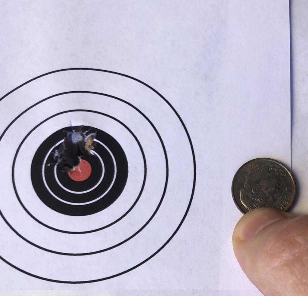

Man so after 3+ weeks of playing around with this Vet, I actually had an opportunity finally to shoot it at 100m (98.3m to be exact). No fog in the mountains today, just cold, drizzle, and very gusty / variable winds. I tested 20.2, 24.8, 27.5, and 28.5gr NSAs along with the Monsters and the FX Hybrids.
My results were a mixed bag, however - I forgot to pack one if my DonnyFL moderators and just had the 1/2-20 adapter with its thread protector on there. I am certain that between having my airtube forward of the muzzle, the wind, and the thread protector were causing flyers / POI shifts. The longer Nielsens were affected the most, but I was also seeing POI shift with 24.8's when I was testing with and without the thread protector installed. It was reproducible almost 100% of the time.
The 20.2 and 24.8's did very well for the windy conditions today. I spent a few minutes dialing in the HST for the 24.8's for accuracy and had them shooting 1/4-1/2". Didn't have a lot of time to play with the 20.2's, but they seemed happy at 944fps (shot them while I was tuned for the 24.8's). I was surprised at how well the bucked the wind, being so light and without much sectional density.
Anyways, I really learned to appreciate the quality of Veteran today. Towards the end if the day, I spent time with it shooting off of tree stumps and off-hand, trying to get a sense of how I would like it hunting. The precision mechanical properties really stood out to me during that exercise, it almost reminded me of a very high-end Japanese made 35mm camera lol, where nothing felt rough and nothing was binding up. Hard to explain, but I'm sure that anyone that has shot a Vet would be able to relate.

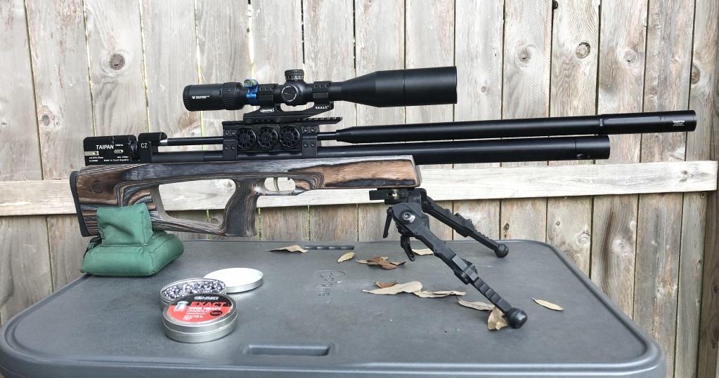

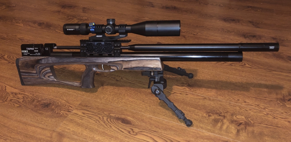

With Ernest’s help, I’ve integrated the FX liner system into my Veteran. I have the Veteran shooting the 33.95s at 915 fps with the 700mm barrel. I was only able to shoot at 40 yards today but I knew immediately that things are vastly improved. I’ll try to get out to 100 yards soon. Both the original King Heavy and the MK2s shot well. Here are some 5-shot groups at 40 yards.

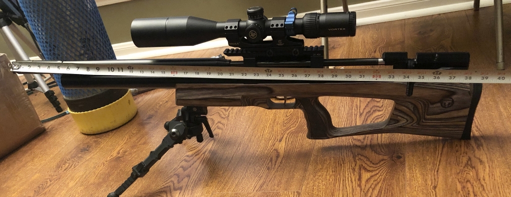

Whats the OAL of that sucker now? Looks to be a shooter!

Details please. Was it complicated to adapt the barrels? Does it require permanent changes to the gun or just the barrels?

If it's using the brass side to mate, then Ernest might have just chopped off the transfer port side of a brass inlet and threaded it to fit. Then again, it's easy to make FX style inlets and thread them. There's also the problem of pellet pin / seating, the throat has to be right for the pin to push them in.
There's been zero photos if the breech end posted, but several of his Taipan with an FX barre sleeve. Doesn't add up, but maybe it wasn't pretty 🤷‍♂️

I’m currently out of town now. I’ll be home this weekend and will share OAL and such.

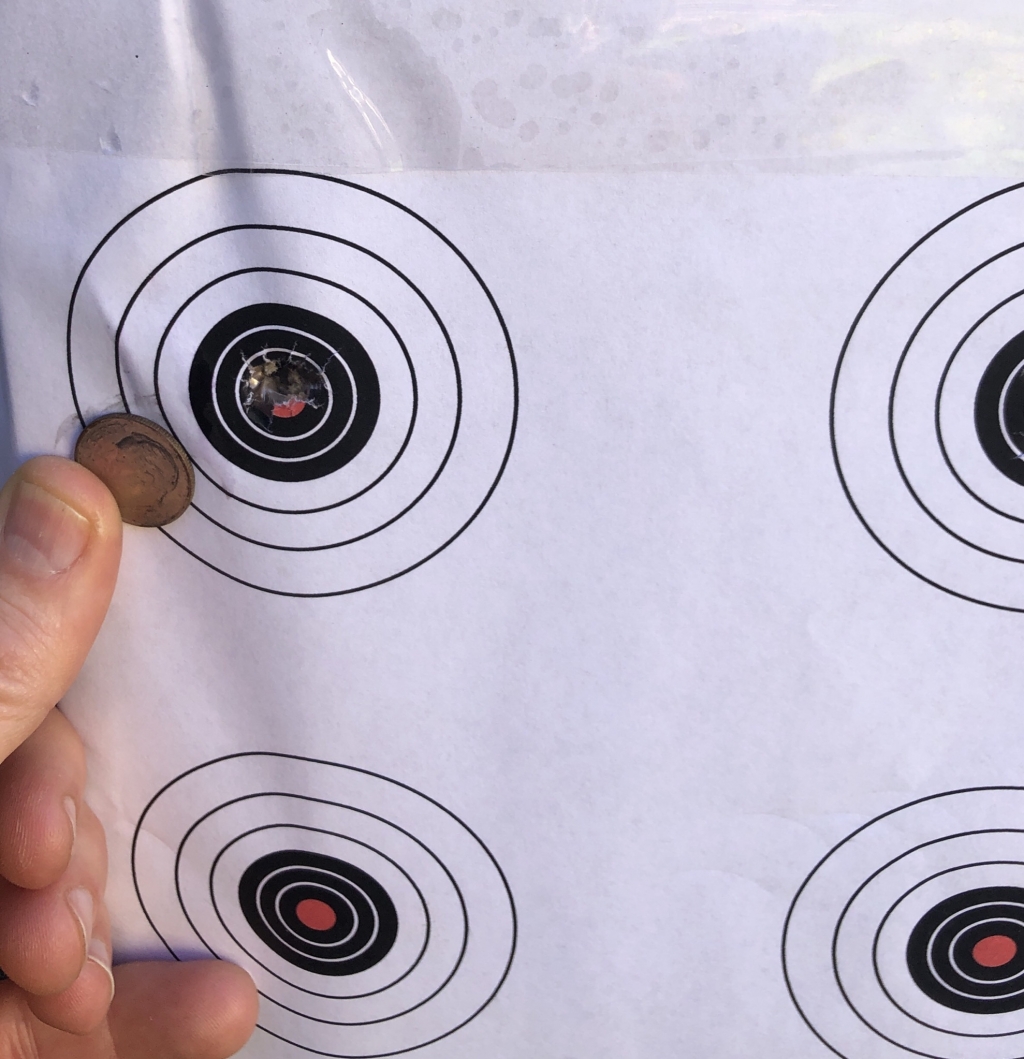

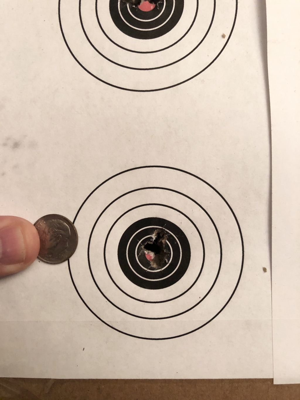

I spent most of my afternoon testing these today at 116.6 meters, and I also shot 27.5, 28.5 NSAs again along with some of the 25gr H&N's. While the 24.8's and 20.2's were tighter than the others, I could not get them to print better than 1.5" CTC across 10 shot groups. The majority of the 24.8 groups were 1.9-2.2" and the 20.2's were anywhere from just under 2" to 2.5" (they shot best around 930 and 944).

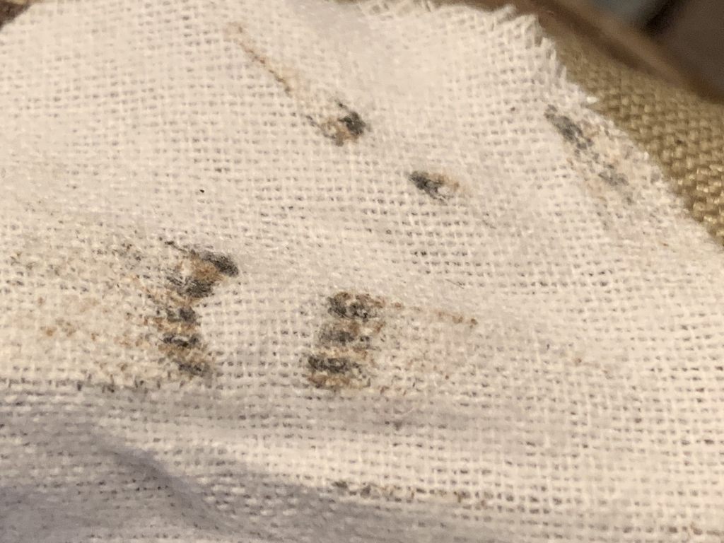

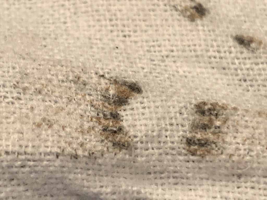

That said, I'm really starting to despise this barrel. I have already given it two 10-step polishing sessions down to a 1/4 micron. When I got the rifle, I pulled around 50 patches through and saw what looked like rust, but it shot the Monsters well with the factory setup at 40m. After polishing each time, I still saw rust coloration and could never seem to get my patches perfectly clean. The lead buildup is less substantial, but this is as clean as I can pull patches though:
1579580029_13041839465e267a7d0e15c4.86956868_6EA0F8D5-9049-4A24-8387-572AC8D26F2C.jpeg
Now the weird part of all this - when I clean the outer portion of the barrel, that same coloration appears! So I'm now like WTF is the deal with this thing?! 😬 Never had an "LW" stain up patches like that, I pulled around 100 patches through it the other night, and they all came out like that. I suspect the materials used in the barrel are to blame. My barrel is essentially a giant f'ing brown colored pencil 👎👎👎👎
