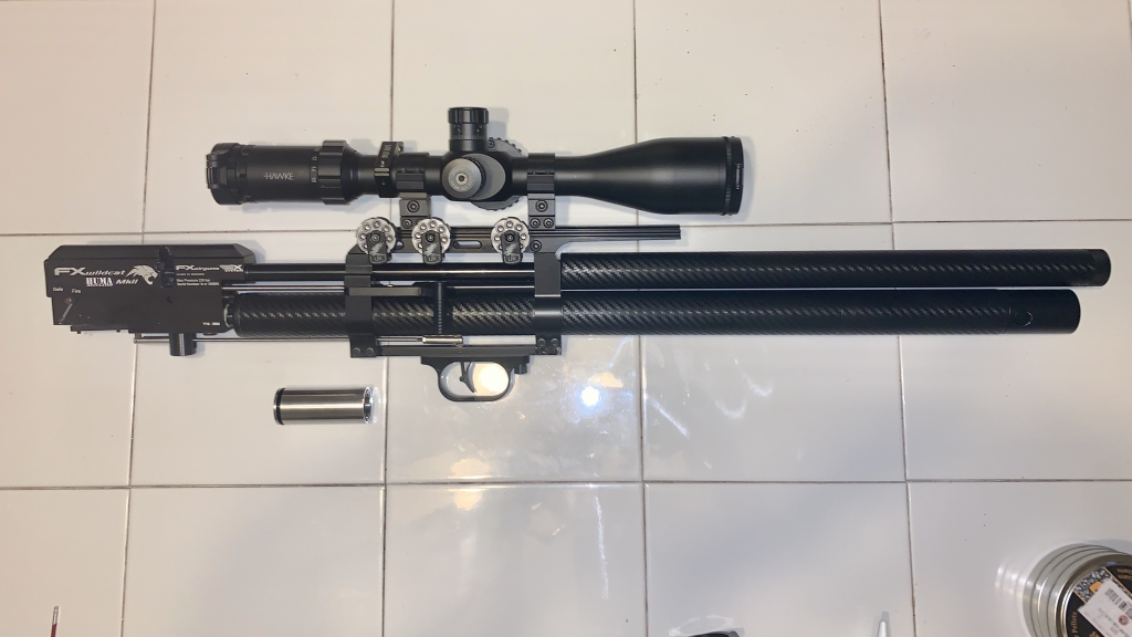

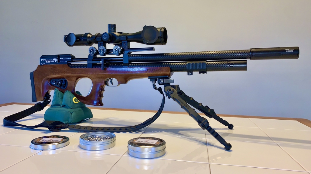

The Huma 30cc XL Power Plenum turned my FX Wildcat MKII.25 into power house of a hunting bullpup! Great power and accuracy at long range!!! Seven eight shot magazines 56 shots per fill! 600mm .25 caliber slug “A” liner and some sweet tuning.

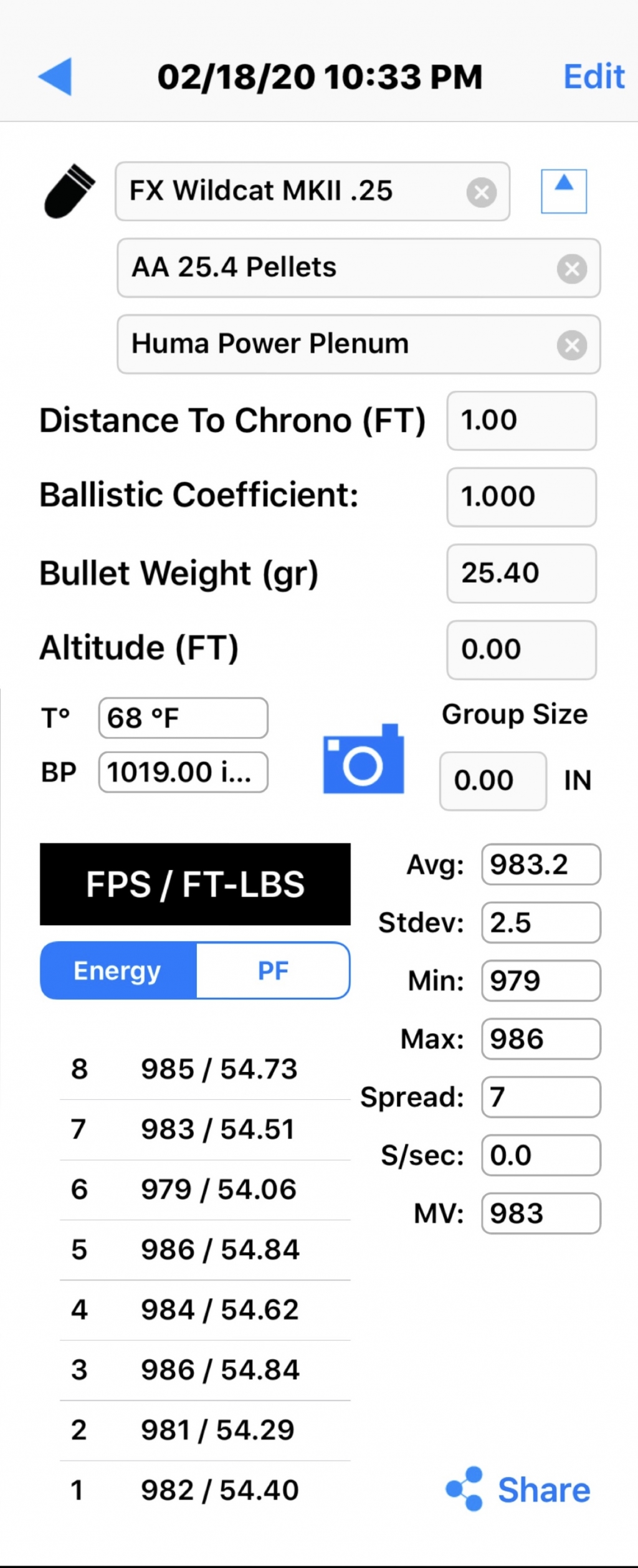

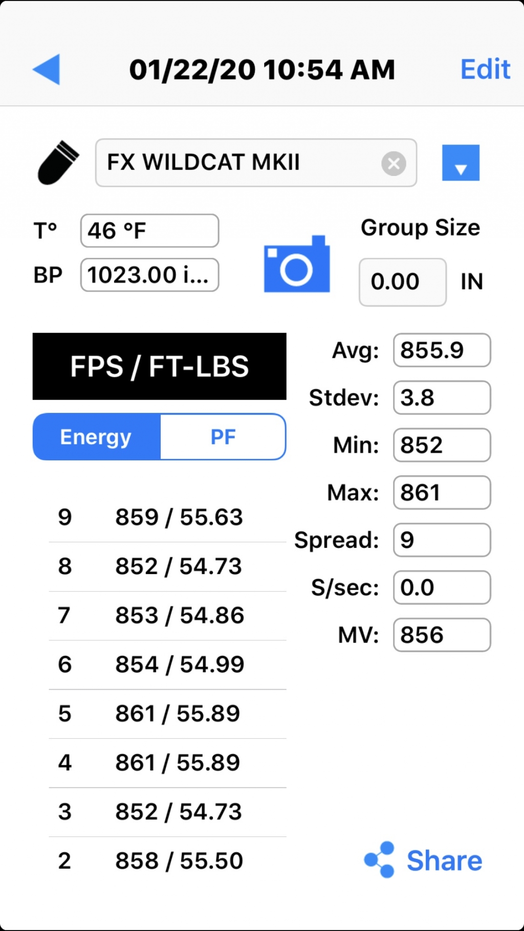

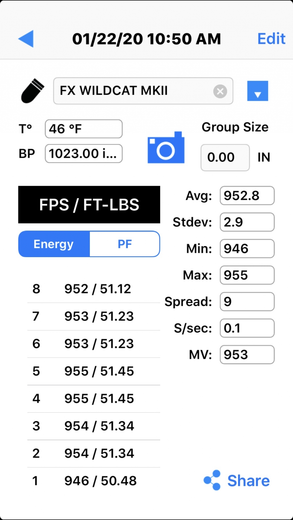

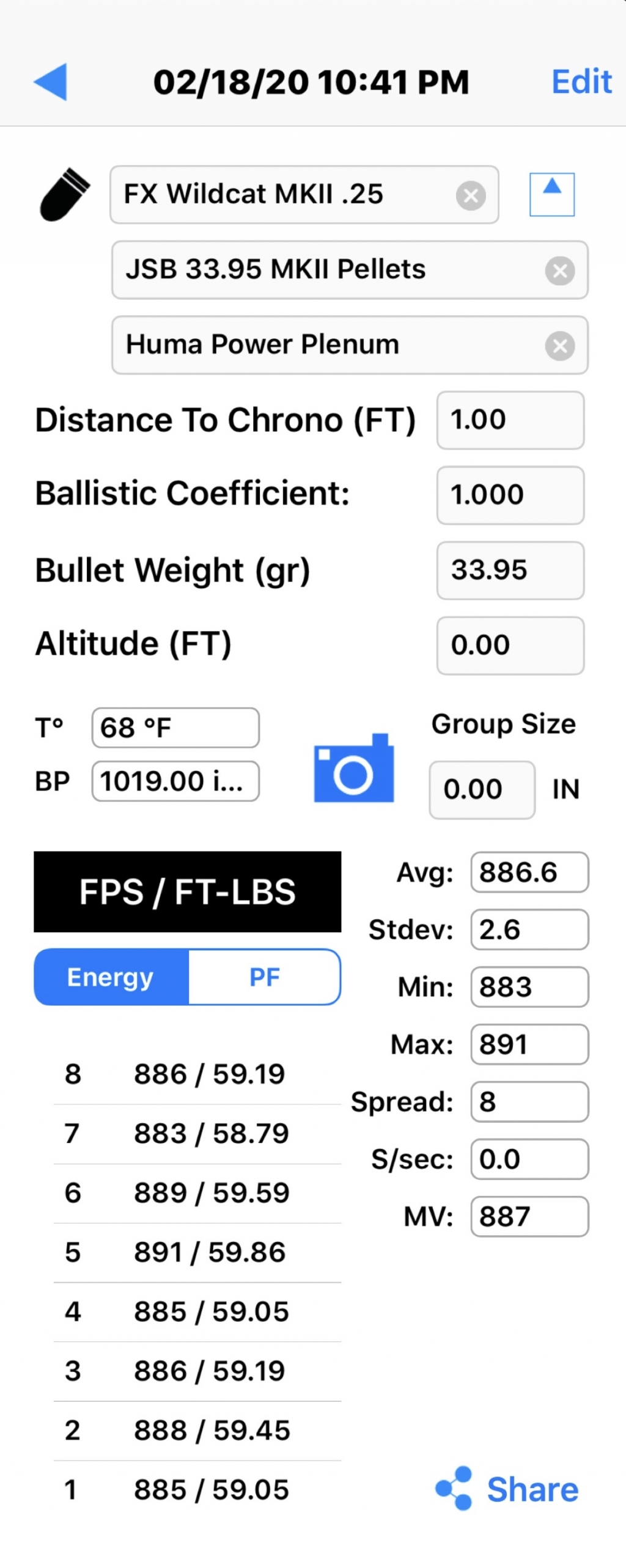

here are a couple of chronograph shot strings with the Wildcat MKII before the power plenum, using AA 25.4 grain and the JSB 33.95 grain. Huma regulator was then @ 135 bar. *Note* I do not tune for absolutely the most power. I tune for a little better power that maintains a good shot count! Good power, keeping some efficiency “that’s what I like”!
Air Arms 25.4 grain
JSB 33.95 grain
