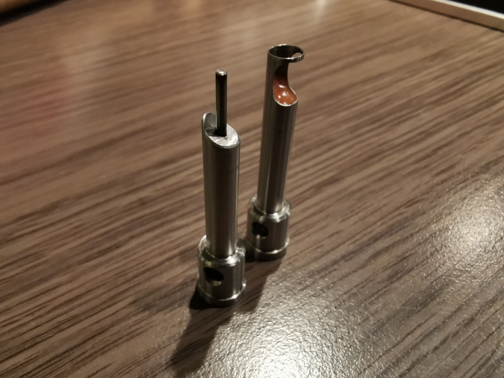

You are absolutely right.
Replacing the probe with a thin tip would give you an additional 33 ~ fps.

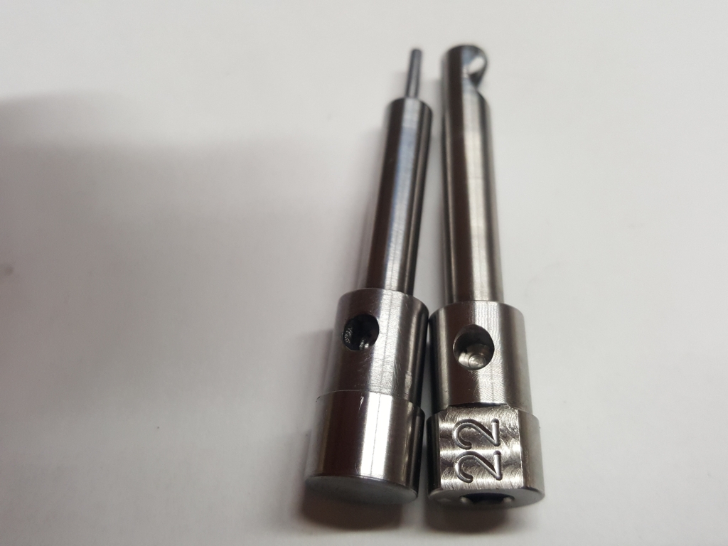

Hi everyone. It looks like a lighter slug with a lower caliber liner is the solution to get the desired 950 fps for stability without aggressive machining. Like the .22 cal slug liner. I am getting one. Inputs will be appreciated.

16mm HSTA and 57mm HS
