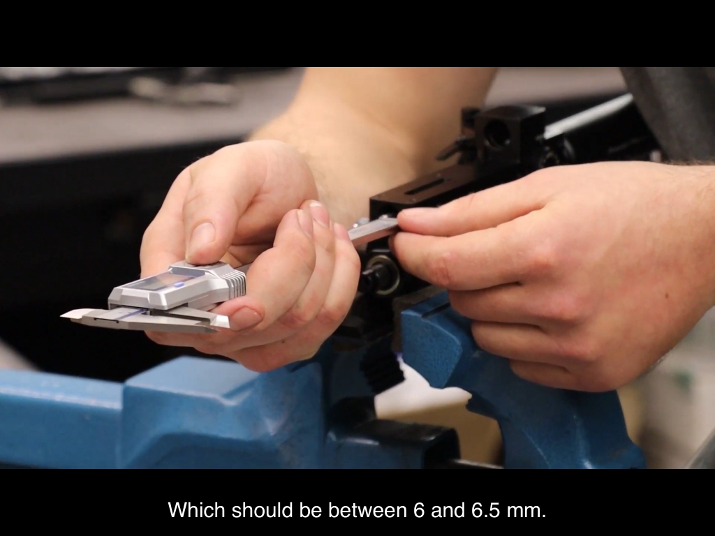

The hammer seat must be 6 mm out from the frame

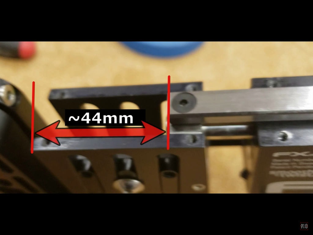

The pellet probe must be set like this in the back.

Final note: I was going to sell my Gen 1./600 mm Impact but it is shooting so good now, I'll keep it for pellets and the MK2 will get the 57 mm spring and be the slug gun. Makes sense I think, and yes I checked and set these distances to 6 mm and 44.5 mm respectively.
