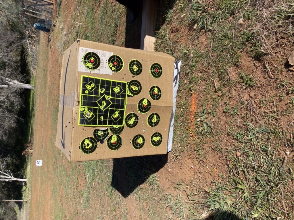

I actually shot1 clip of 33.5 slugs. That was my second to last clip. I didn’t see much difference between those and the pellets. Look up 56 from my shot string and count 28 down and that’s it. Here’s a pic of my targets. The right side top 3 down are 5 shot strings. The second one down had one flyer but was super tight on the others. That was the first time I shot slugs through it
1583029466_14295732765e5b1cda2fb272.23363886_76F4D83D-8444-4A95-A14C-579C4820865D.jpeg
I dont have 25 cal otherwise I would.
Most people here know that I can back up anything I say via scope cam and video. I'm not claiming anything.
Thank you bob. I have been following you even before i started pcp. Your youtube did help. But hey, you are now bigtime. Reviewing truck worth million of dollars. Goodluck and more power.
