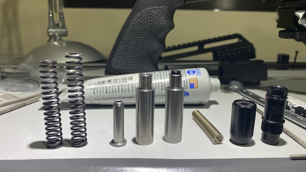

 ....and my conclusion is that without little bit of machining and changing a longer HS you can't accomplish much more..
correct me if I'm wrong.. but I think that I'm not!
Precisely. That is what i am trying to explain but, for lack of comprehension, they say you can but you need to do this and that. I said what duh?
Nonetheless, for update, I can now wallop a 33gr slug pass 950 by simply installing the longer HS and replace the HS for the PP kit.
Happy plinking.
i know what is wrong here
when u said hammer at max how did u decide that ?
i have two mk2 one with pp and the other without
the hammer adjuster is different on both
pp version hammer adjustment has more room to play with
when u say hammer maxed out that means u barley move the hammer wheel
if u want more fps u should tighten the hammer more cuz i can go up to 950 easily with pp version using 33.5gr NSA
hope my english is clear 😅

Do you have the part number of the longer hammer spring you used or any info on it please?
