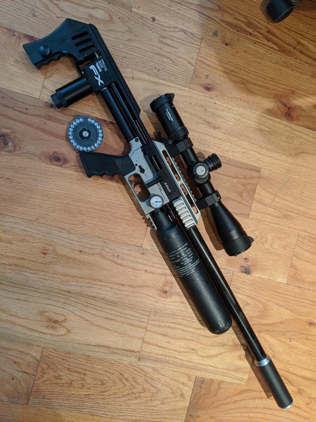

After watching Giles’ video on the new Power Plenum FX Impact, I wanted one and wanted to shoot the heaviest JSB .30 pellets I could push through, the 50.15 grain Exacts. The rifle arrived from Utah Air with the regulator set at 110bar. I assume that was a good setting for the 44 grain JSBs. I’d watched tuning videos from Meathead Marksman (Uncle Hodge), Steve Scialli at AEAC and Ernest Rowe and was starting to get an idea on how to proceed. I started out opening up the valve adjustment to full open, adjusting the regulator to 120bar, closing up the hammer spring adjustment screw to max, and starting the shoot-chrony-graph of opening the hammer spring screw to balance hammer force with plenum pressure. I quickly figured out I was going to end up well below my 880fps tuning goal. I cranked up the regulator to 130bar and was getting 920fps with the hammer maxed out and the air valve full open. Went through the hammer balancing again, and finished that with the chrony at about 900fps. At this point the air noise was reasonable, but I was still hearing metallic pings from the valve. Started tweaking the air valve gradually down. The pings went away and I stopped closing the valve at 880fps. I just finished running a couple mags through and everything looks stable at an average 881fps, max spread of 7fps and a standard deviation of 2.4fps.
Utah Air was a pleasure to deal with and Josh helped with my tuning confidence. A couple of things to check on arrival, though. The barrel wasn’t fully seated (the new barrels don’t have the set screw dimple). Easily noticed this when the magazine pushed through to the left side of the rifle. Easily fixed. After a few mags of tuning, the pellet probe block set screw had backed out. I caught it before any disasters happened. I hadn’t checked it on arrival, but maybe one should do so. Other than that the rifle works perfectly and I couldn’t be happier with how it adjusts.
Steve
Hammer spring adjustment addendum:
I ended with a balanced and optimized hammer spring adjustment at 14 turns off of max closed. "Turns" is an approximation of how far one can turn the screw with a 1.5mm hex wrench in the available space before reaching the metal of the receiver (about 1/8th turn). "1.5mm hex wrench" is an approximation as well apparently. I went through four "1.5mm" wrenches before I found one that would actually fit the adjustment screw. The final winner was measured at 1.45mm by caliper. Here's my chrony numbers after each "turn".

The hammer spring was too strong on turns 0-13. From turn 14 on, there was a gradual and predictable decrease in speed with each turn off of max. I'm pretty sure every rifle is going to have a different optimum hammer with every plenum pressure. The above is provided as a guide and this procedure is certainly only one of many ways to get there.
Steve
