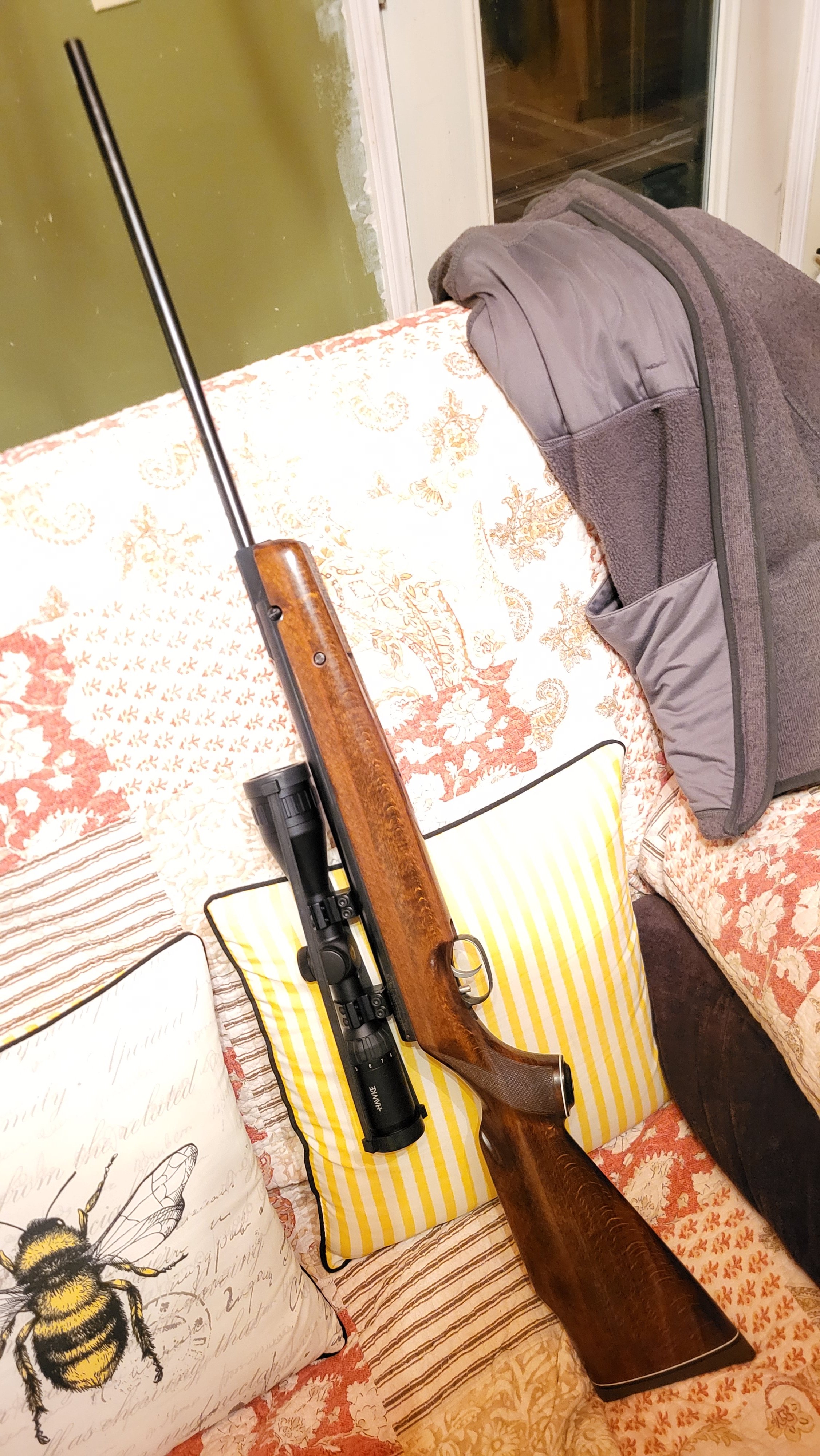

I have a R1 that I have a love, hate relationship. Mostly hate. I've tuned it in 20 cal and 22 and struggled to get 20 fpe clean. That means without dieseling. After trying a JM kit and a Vortek kit I finally got 19 fpe in 20 caliber and 20 fpe in 22 without dieseling. The gun was harsh, hard to cock and generally unpleasant to shoot. It has flirted with decent accuracy at the expense of trashing a Dampa mount and an Airmax.
Yesterday I dropped the power down to 17.3 fpe in 22 cal and the gun I've always hated is now pleasant to shoot and seemingly accurate. I had to hold off proper accuracy testing today because of significant winds. As the sun went down the winds finally dropped out and I had no problem hitting 1" spinners on the edge of the bluff I'm on at 25 yards. There's a sandbar in the creek at 170 yards with a lone stone surrounded by water I was able to walk in a few shots at. It was a blast to finally enjoy the gun but still somewhat disappointing because it's still far away from the power I'd expect from an R1.
My question is would you dumb down a monster to tame it so you can enjoy it or do you keep pushing it for power to the point you won't enjoy it?
