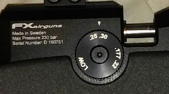

But to answer your question. I believe this is "power wheel" you are referring to.
This is the Transfer Port adjustment that offer 3 different TP sizes, it will change your FPS whether in .22 or .25
The adjustments on my 600mm .25 DL Classic set @122bar w/PP are as follows;
Predator GTO alloy 16.54:
  • LOW - 625 fps
  • .177 .22 - 1020 fps
  • .25 .30 - 1060 fps
JSB 25.39:
  • Low - 618 fps
  • .177 .22 - 926 fps
  • .25 .30 - 964 fps
Patrick

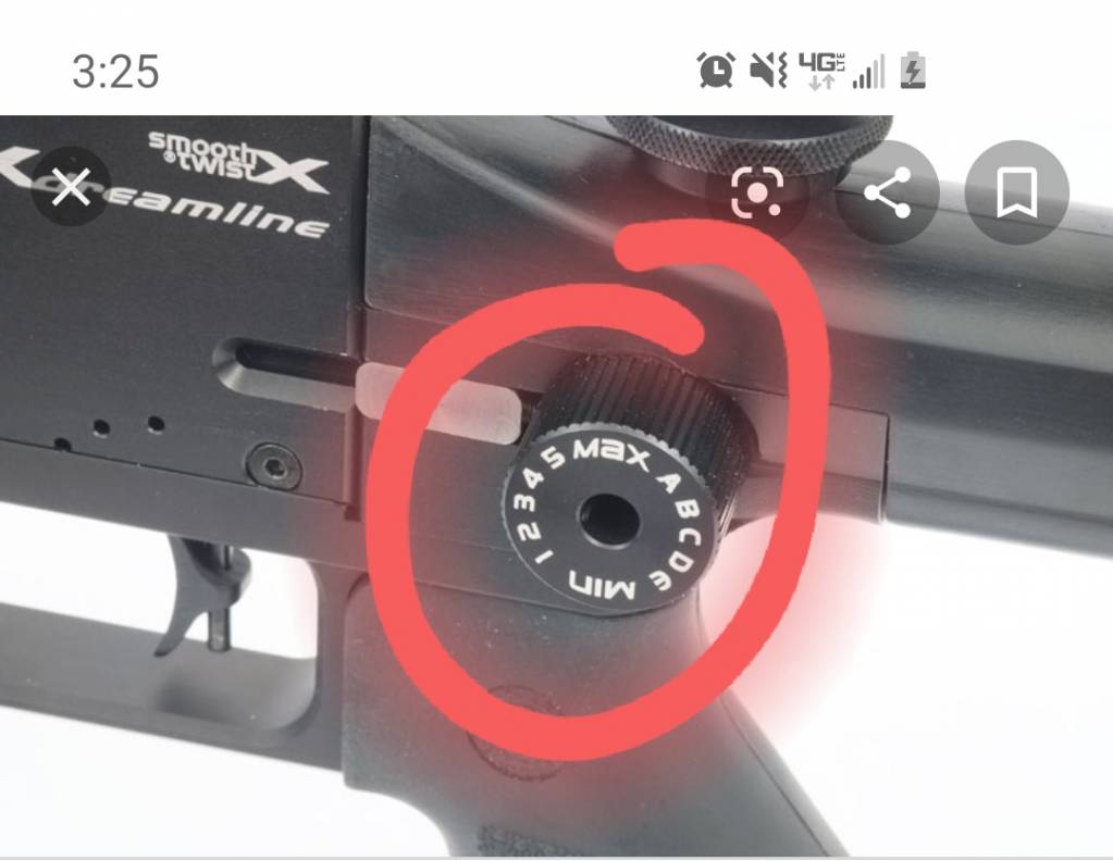

I'm looking for adjustable down to low power. For shooting backyard, indoors and barns etc
If you feel confident enough, you can always tune and detune an impact to around 12 FPE or to max power. I think in reference to Yo's comment, you get alot more gun for around the same price or less. The biggest seller for me on the dreamlite series is the compact version with folding tactical stock. Seems great for backpacking, on the go, etc. for my needs.
  • LOW - 625 fps
JSB 25.39:
  • Low - 618 fps
  • .25 .30 - 964 fps
Patrick
No I meant this
Got it, my bad. "Power Wheel". My classic has not one. I have to do it with an allen so it slipped off my radar, even after I got an Impact...😜
I just have been tuning my Impact, starting from scratch with factory setting of .708 on the "power Wheel" 😆 when set on MAX , measuring from the end of the adjusting screw block to the end of the slot. The DL wheel cam could be different but the concept is the same.
Each # from Max to Min is the difference in .001 from the previous setting and the Speed w/ 25.39 JSB on my Impact @122bar.
  • Max: .708 (factory)-979 fps
  • 5:.028-972 fps
  • 4:.025-964 fps
  • 3:.031-946 fps
  • 2:.029-913 fps
  • 1: n/a
  • Min:n/a
The A-E letters varied from .002 to .008 wider than the #'s so there is some extra fine tuning available with them. Between the HS (power wheel), TP and Reg, you can tune it to its favorite pellet/slug. It will let you know what that is, just be patient, listening and feeling it.
Stay within the designed power parameters of the DL and it will cause you to be very happy. If you want to push it, buy and Impact.
Measure everything and take copious detailed notes, ask questions and share your results.
Shoot straight and above all, have fun.
Patrick
