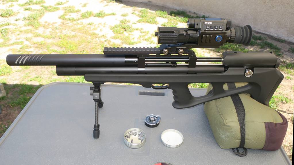

MK III 700 mm barrel. NSA 23 grain slugs. HST 5.5 mm. Reg 140 Power Wheel 7. Sub MOA. 52 FPE. 1caveat: Huma Reg and XL plenum. My AMP leaked and never looked back.
sold gun recently. Just not my style. But awesome power!
yeah... No doubt awesome power. The 700 mm barrel, XL Plenum and Huma Reg are the kind of stuff you need boost the cat the way you write !

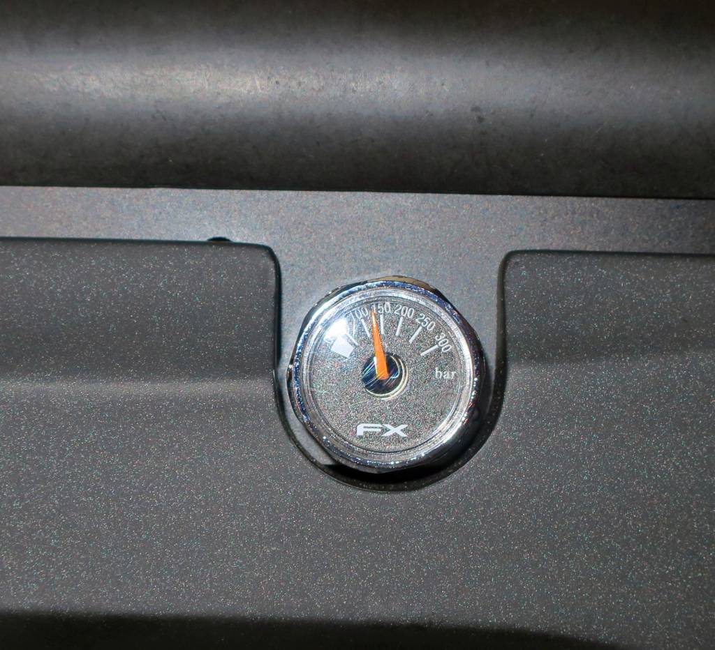

Thanks for the post but when I look at your picture I do see you reg needle in a clear “at least” vertical position which indicates a approx. 150 bar setting isn’t it?
Gun pressure is at 155 bar. Like I said earlier, pretty coarse gauges that FX puts on their guns. Right now in the pic, maybe 130? Fluctuates a little while shooting between mid-way between 100 & 150, and like it shows below. I have not changed the reg pressure on this gun since I purchased it.
